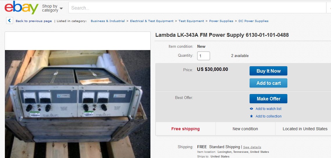

I been looking to get a new lab supply, and came across this on Ebay... This has to be a mistake, all I could say was holy cow... :)

I come across outrageously overpriced stuff like that all the time on eBay.
Personally I think that it's a way of doing money laundering in plain site.
I sell you an old power supply that' worth maybe $100 an a good day for $30K and you sell me an old car part that's worth maybe $100 for $30K a week later and boom! Now we both have semi legitimate covers for where that $30K we each made doing illegal things came from. ;)
I see two are available. Have you ordered both? :)

Finally back on my computer and here is the **broken link removed**. It's a very good power supply.
What it's worth is what someone is willing to pay.
Wow, those are some sweet specs! Not realy sure it´s worth the money compared to modern lab equipment, but sure that was an expensive unit back in its day.
Just the job for powering/testing some little circuits designed around a 741 :).
Don't laugh - I opened a precision sensor power supply and found 8 x 741 opamps happily nesting away inside !
Even scarier was it was still putting out 10.001 volts on each output after 20 years in a harsh environment !

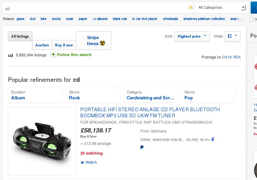

Remarkable exercise to try, random ebay searches and order the results "most expensive first".
Remarkable exercise to try, random Ebay searches and order the results "most expensive first".
True but many PSUs, even when the prices vary quite a bit, are basically the same thing manufactured by a company in China
I meant random stuff, not specifically PSU's. Like this one for example - I searched for cd and listed most expensive first
