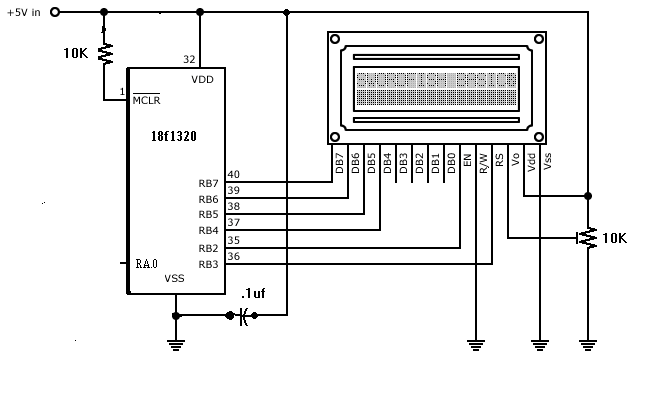

need to control an LCD which run at 4.5v aprox.
purchased in July 2018 for $2.60 each 18f43K20 but the LCD is an issue as is the price jump.

going to research the 18f43K22 if it will run on 5v then I can keep the lcds as is.
No need to... I already did... I bought 10 pic18f45k20's found I couldn't use them.. Bought pic18f45k22's... All's good..

Id buy a 10 or 20 of the same chip 18F45K22 and the 18F26K22 40 pin and 28 pin
get 2 dip's to test on breadboard and then use the smaller TQFP chips on PCB
Then you start with a blink that blinks with setting for OSC keep a lock on that code
Then add LCD using same configure and your life be a lot better.
Use a LCD guide like this
And have fun

And here a pic of a easy way to use a LCD with 3 volts posed on microchips forum
