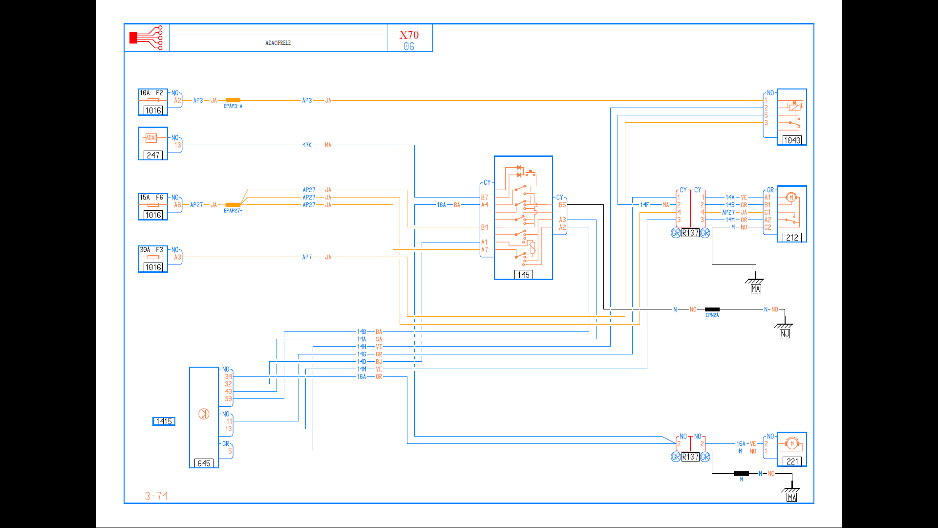

I have 2007 Renault Master in which wipers intermittent function does not work. other functions low and high speed works as well as 3 wipes if you spray watter.
I found some diagrams for this car (look below) and as fas as I understand the wiring of 5wire wiper motor, low and high speed are both pure mechanicaly operated by the wiper stalk. Then there is a intermittend operation and spray wiping that are both controled by the BCM (body control module). In my case spray and 3 wipes works fine but when you put wiper stalk to intermittent function you hear a click from the BCM but wipers does not move.
For me it is a "pickle" since I don't think wiper stalk is bad also BCM physicaly looks fine (nothing corroded, nothing burnt), fuses are also all fine and strange thing is that rellay does click.
Also cabin doom light does stay on even if you shut the doors close, and that to is BCM operated (door's switches are fine).
Since both wiper stalk as BCM are expensive (at least 150$) I was thinking to make myself a simple timer rellay for the wiper intermittent function.
Here is the wiring diagrams for the wipers for this car.
ibb.co
212 wiper motor
221 spray pump motor
145 wiper stalk
645 BCM
1016 wiper fuse
ON YT I was looking how a basic 5 wire wiper motor works (wiring of an internal park switch). Everything is understandable, but internal switch on this diagram is different than one provided on the wiring diagram for the car.
Now my understanding is that for a intermittent operation I would need 2 rellays. One providing a 12V pulse to the A1 pin of the wiper motor (low speed), so the wipers would move from its park position and the internal park switch will switch and then I need a 2nd rellay to provide 12V to the A2 pin of the wiper motor. This 2nd rellay has to provide 12V so long that the wiper returns to its park position, then a short delay and everything repeats.
For the input signal for my simple board with 2 rellays i was looking the diagram of the wipper stalk. There are 2 wires going to the BCM (pin VE24 and VE25). First i think is for the spray activation and 2nd should be for the intermittent activation. I guess direct 12V signal is provided on those pins and I will just use voltage divider in my simple board to lead this signal to the PIC mcu.
What are your thought on the matter?

You should only need one relay. You basically just need a relay to fool the system into thinking that you have turned on the wipers. You then activate the relay for about 1/2 second each time you want one wipe.

stalk has intermittent, low and high speed, watter spray as usual on spring.
intermittent and spray function is operated by the rellay in bcm. strange is that 3 wipes of spray works while intermittent doesn' t but i do hear a click. fuses are ok,but otherwise you can see in the diagram there is one fuse.
wiring diagram does not show in detai how stalk internal switches work. one rellay you say? if the stalk to intermittet function switches power to motor park position, then i guess it will be enough to have just one rellay providing a short pulse to the motor low speed
i siriously doubt stalk is beeing bad, i thought something is wrong with bcm since other functions relatet to bcm do not work and i think mcu or something of ic are bad ratther than rellays that seems fine. however it is strange that 3 wipes work but intermittent doesnt.
yet rellay does click once

There circuit diagram of the switch is quite detailed, and there are some unused connections. Also the windscreen wash motor (labelled 221) has an arrow showing that it can run in either direction, but it is wired in a way that it can only run in one direction. It's quite common to have washer pump that runs in one direction for the front washer and in the other direction for the rear washer. It looks like the vehicle uses components that are also used on a vehicle with a rear wash-wipe.
I think that the circuit shows the internal connections of the switch exactly, and the unused parts can be ignored as they are for a rear wiper.
Fuse F3, labelled 1016, and the wire AP7 that goes from terminal A3 on the fuse box to terminal A7 on the switch is only used when the wiper is on intermittent.

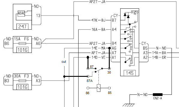

If you wire an automotive relay up like this, and activate it for about half a second, the wiper will operate once.

Can you monitor the voltage on the wire from pin A2 on the wiper motor, whilst the wipers are operating normally?
It should switch between 0V and 12V (or vice versa) when the blades are in the "park" position.
The drawing shows that signal as only being used by the ECU and no other connections.
I'm wondering if the wiper motor also has a conventional internal park switch connected directly between power and the motor, that is not shown?
If so, a fault in the ECU park switch signal could prevent the intermittent function from working.
(eg. It's waiting for a "parked" indication before starting to time the next sweep delay).
ps. If the column switch diagram is correct and the switch is OK, you should see continuous 12V on switch wire A1 when the column switch is in the intermittent position.
However, I do not trust that diagram - there does not appear to be any direct power feed to the motor, or indication to the ECU that the wipers are on!
Switch A1 & A7 shown reversed, possibly? A1 being the fused power feed and A7 the switched wire to the ECU would make a lot more sense!
If A7 switches on in the intermittent position only, then the diagram is messed up.

I don't think that there would be another park signal. The third wire to the wiper motor is to make it run at a higher speed. That is usually done by having a 3rd brush on the motor. The normal speed brushes are at 0° and at 180°. To run at high speed, the 0° brush and the 3rd brush at about 120° are used.
As you said, the A2 wire tells the BCM if the motor is in the parked position. I can't see reason to have a second park switch.
However, the park switch has a +12V and a 0V feed to it. If the park wire was only there to tell the BCM when the wipers are in the park position, there would be no need for a changeover switch. A NO or NC switch could have been used and with small current with a pull-up resistor, and wire AP27 could have been omitted entirely.
I suspect that pins 2 and 4 on the BCM are connected together by the BCM when the wipers are turned of, so that the 12V power comes from the parking switch. When the park position is reached, the the switch changes over and the motor is shorted out so that it stops quickly.
This is a possibly more accurate version of the wiring diagram - the 2006- model rather than 2003-2005 model.
The power feed to the lowest switch section now makes sense (to the common rather than to a single position), so hopefully the rest is also OK...

That circuit appears to have a variable resistor which is connected when the wiper is in the intermittent position. I guess that would be the adjuster for the intermittent rate, which the OP is says isn't present on his van.

Don't know how you found this diagram, I searched the internet and all i could find for free was for 2003.
However I don't know how car's repair manuals works but I will say this is not what is in my van. My van is year 2007, sold in Slovenia, made in France, but if I go step by step.
1st I have no rellay on the fuse&rellay board for the wiper (on this diagram 1040 is a wiper rellay), I also don't here no clicking on the rellay board when wipers are on
2nd I only have 1 intermittent speed, on this diagram there is a variable resistor selector.
3rd wiper stalk here has no direct wiring to the wiper motor, there are only 2 wires going to the BCM (probably each switch has its own resistor)
4th if I remove BCM my wipers still works on low and high speed, so there has to be direct wiring from the stalk to the wiper motor as on the 2003 diagram
I'll say 2003 X70 diagrams are correct for my van.

The '03 diagram has the stalk switch controlling the two main power wires direct to the motor: 14A and 14B
On that diagram, terminals A1 and A7 are shown reversed; A1 is power from the 30A fuse, and for normal low/high speed wipers power is connected straight through from A1 to one or the other of those motor wires.
A7 sends power to the ECU from A1 when in the intermittent position, and A6 connects the motor low speed power through to the ECU when the switch is in either stop (park) or intermittent positions.
Note that the matching 06 Owners manual shows fixed-speed intermittent wipe. The resistor in the switch could be a factory preset?
If your switch really does not have any wires direct to the motor, then the '03 drawing is very! wrong as well!
