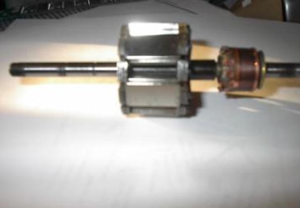

this is the rotor from the abandoned motor project..
the magnets are supported by the lamenates from the old armature.
i origionally had just four magnets this picture has 12 , six doubled up, for more magnetic flux....
if they look like they tilt twards the inside , on the left , they do.. I was trying to make more room for the coils..
i am in the process of making an armature winder of sorts..

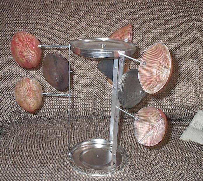

Remember the tuna head anomemeter from a while back..well i am going to use that, ( slightly differently ) and using peterpans idea of the three bladed savonious.. it should be awesome !! :D so instead of just three tuna heads , i am going to try nine , to start with..three stacked ,one above the other..connected on Aluminum strips , anchored to a six inch disk on the top and bottom , with a 1/4 20 threaded rod going down the center, all this will be placed on my first generator,the one with the 8 inch saw blade for the rotor..i may or may not need a bearing on the top, we will see..

well it wasnt awesome..lol
i suppose i should have stuck with the propellers..the tuna heads didnt come close to the props in speed..240 Vs. 526 RPM .. no contest ...oh well .. i had to try ..
it worked , but it didnt have the torque , or the speed , to turn the generator , as well as the propellers do..probably because the propellers dont have the negetive effect of having to push the opposing heads around to catch the wind..which i suppose is the problem of all savonius types...
l
The bigger problem with savonius type windmills is that they simply do not have the same swept area of a comparable size propellor facing the wind. Hence they cannot extract anywhere near the energy.
With a propellor its the swept circle area minus a small part for the hub that gets energy from the wind.
With savonius types its only 1/2 the swept rectangular area.
Some egg beater canting blade designs might be more efficient than the simple savonius at the expense of complexity.

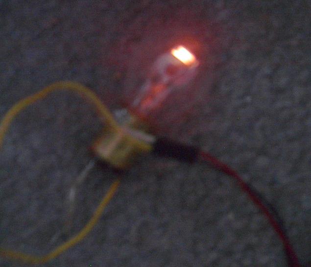

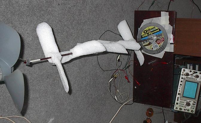

i just had another milestone ..
i was able to light a tail light by wind power alone..
i did not know that the camera could stop action like that , that fan is on high !!
i have 22 magnets on the rotor, about 1/2 '' apart. and i was getting 20 V no load from four armatures..
after about ten seconds it slows down too much to keep the bulb lit..but hey, with more wind ( than a fan) it might keep going..
EDIT:: both filiments of the bulb are not lit ,just the one with the skinnier wire . must be the camera.. :roll:

P.S. interesting how the camera also showed that your once nicely staggered propellors are no longer nicely staggered :D
yeah i learned a lot from that site ..and i have been thinking about how i could use two rotors .. in my set up i would have to support the generator by the armatures which would be sandwiched between the rotors..its not out of the question , just a little more difficult..
as for the propellers , whose idea i got from Doug Selsam ( see bottom of page six of this thread ) when they slip ,they tend to follow in the slip stream of the one in front of them , like the middle one did,.. ideally there should be more space between them..
