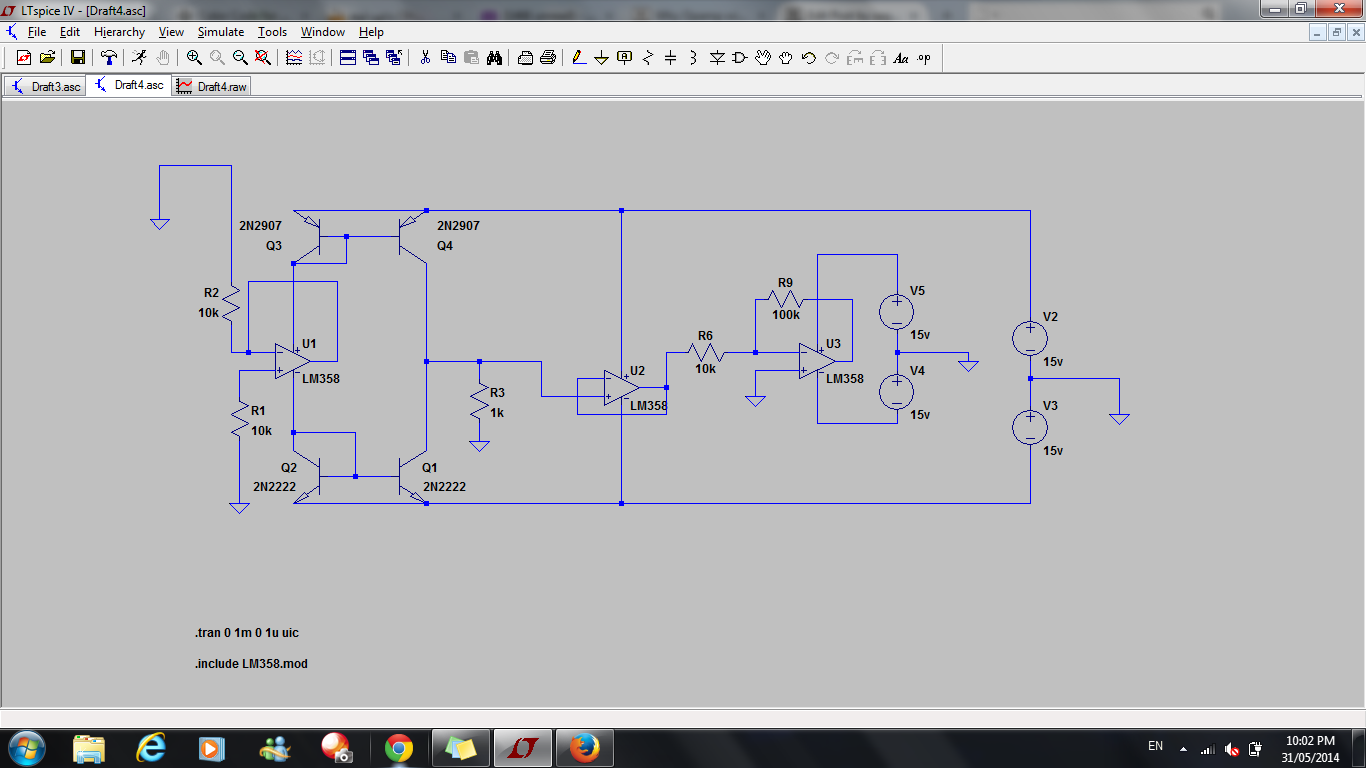

I am going to use a regular solderless breadboard. when I built the upper section on breadboard the circuit configuration was a little bit different. there was no buffer between first stage and the last one. besides configuration of last stage was different. Resistor at the output of current mirror wasn't connected to the ground and Non inverting pin of last op amp was grounded. In this kind of configuration, circuit began oscillating. I add the buffer when I assemble it again but should I keep non inverting pin of the last op amp grounded or not?
What do you mean by "keep the non inverting pin of the last op amp grounded" ?
The last op amp is the differential amp with resistors pairs 10k and 100k, right? You cant ground the non inverting terminal or it wont function right anymore. Unless you mean something else.
Yes, that's right. But I want to assemble only the upper section of this circuit. for doing this, I build the first stage as it is in the main circuit then I add the buffer(the second op amp). but for the last op amp I don't know what should I do with the 100k and 10k resistors which are connected to the non inverting pin of op amp. one side of 10k resistor is connected to the buffer of lower section while I don't want to assemble the lower section right now. Simply put, what is the configuration of last op amp when I only want to build the upper section and test it? I think I should change this part a little bit because I don't have the lower section (lower current mirror and buffer).
Oh you mean the last stage without the lower section. Ok i understand you better now.
In that case just ground the 10k resistor that normally connects to the lower section output buffer. You'll still have the 10k and 100k pairs. It may work to just ground the non inverting terminal, but i'd go with the two resistors and that way you'll be ready for the lower section once the upper section is fully tested.

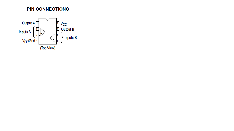

I am going to use LM358 for building the upper section. In LM358 datasheet pin number 4 is VEE/ GND. I have to bias my op amp with +15 and -15 vdc. can i apply -15 v to pin number 4 and 15v to pin number 8. LM358 is a dual op amp I don't know how can I use only one of op amps from this package. :-(

The LM358 has a maximum allowed supply of +16V and -16V so using a supply as high as +15V and -15V might reduce the life of your circuit. The opamp will work fine with much lower supply voltages. Notice that we call it the power supply voltages and not bias voltages. Bias voltages are used at the input of an opamp or transistor, not at its power supply pins.
The LM358 is very old and is probably the first low power dual opamp ever made with the LM324 the first low power quad opamp ever made (their circuits are identical). First a single opamp was produced but I do not know its part number and I do not know if it is still made.
It is easy to disable one of its opamps. I would connect its inverting input to its output to make it a follower then connect its non-inverting input to 0V.
So I can connect pin number 4 which is shown as VEE/ GND to negative supply voltage, right?
Yes that sounds right.

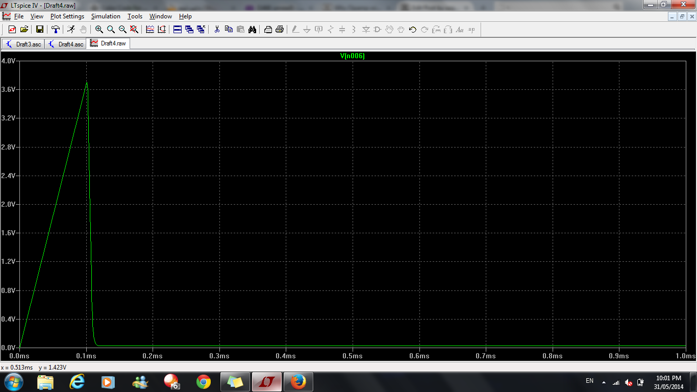

I want to see the offset voltage at the output of circuit which is attached to the post. This circuit is the upper section of the entire circuit. I didn't apply any signal to non-inverting terminal of the first op amp in order to measure the offset of the very last op amp. But I don't know what causes this kind of peak (3.6v) at 0.1ms?

What node are you looking at with that scope pic?
Try to post the asc file when you can.
