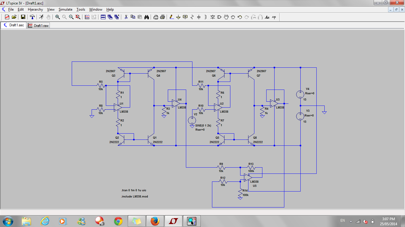

By changing op amps of current mirrors to LM358 and adding (250 ohm) resistors to emitters of transistors, output of current mirrors works right. With 1Vdc on both channels I got 0.1v. by applying -1Vdc I got -0.097 v. At the output of buffers I got almost the same value.
But when upper channel is 0Vdc and lower is 1Vdc (between 10k resistors is still grounded ), Output of top buffer is 1.63mv and the lower buffer is 0.1v. Also, the last output is 0.99v.

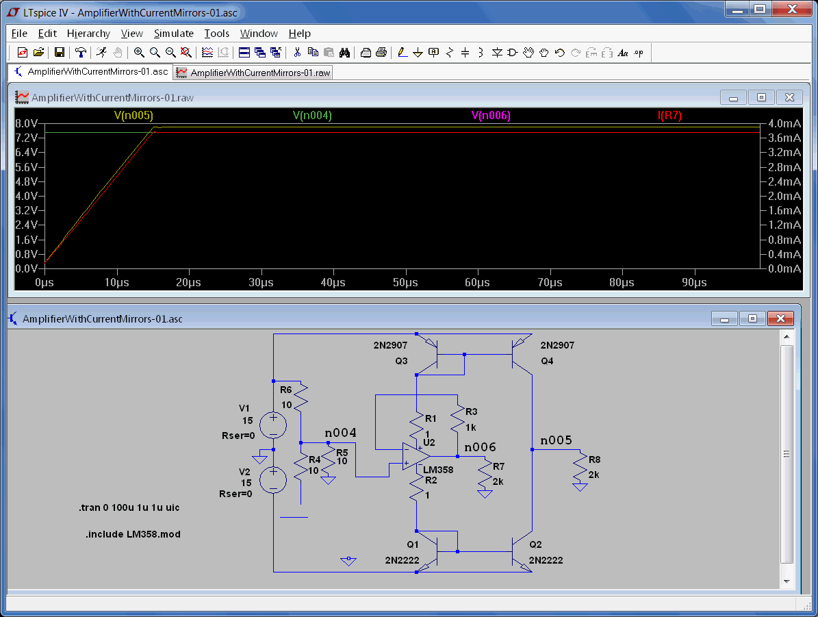

In the mean time, here's a simulation of the upper section of the circuit using LT Spice.
As you can see, the output is nearly the same as the input with equal resistors (2k).
Oh, so the oscillation only occurs with 0.000v input? Well guess what. Once the current mirrors are added, this circuit is no longer a perfectly linear circuit like most op amp circuits, but becomes partly digital in nature. That's because when the input signal goes through zero the current mirror mostly responsible for the output current switches from the upper mirror to the bottom mirror or vice versa. Adding a resistor from the positive supply terminal to the negative supply terminal of the op amp may help this situation because then both current mirrors are always working to some degree, more so than without the extra resistor to draw more quiescent current. The problem may not show up in a simulator.

OK It's done. I got the same result as yours. Now do I add the lower stage? before adding the lower one I think I should make some changes. shouldn't I? Actually in previous file you applied some changes to upper stage like applying 15v to non inverting pin of op amp. I have to turn all of them back to what i had.
Hi again,
Yes you should be able to add the lower stage, and yes get them to look the same as your original schematic. I used some of those resistors just for testing to make sure it worked right.
I looked for oscillation and could not get it to oscillate.

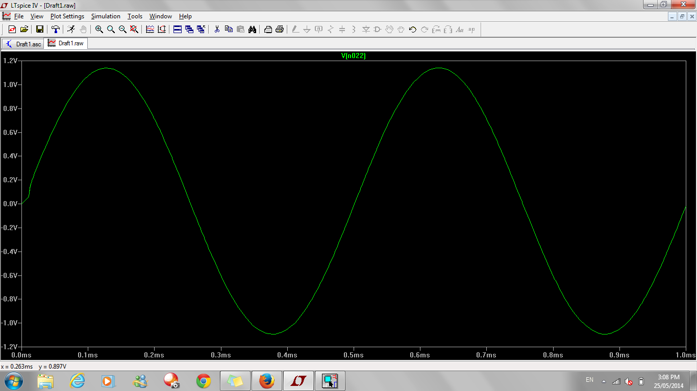

I draw the whole circuit and got the result which is shown in Untitled1 , I hope this time The very last output has a correct result. How can I increase the value of gain? If I multiply gain of first stage and second stage I get the TOTAL gain. I know the gain of last stage but what is the gain of first stage ( From inputs untill buffers)? Actually I want to change something in this circuit to increase the value of gain. It seems this circuit acts like a buffer, dosen't it?

Hello again,
There are a couple ways to change the gain.
Part 1:
If you look at the first stage of each section, you see a gain of 1 buffer. You know how that works. If you input 1v you get 1v out. If you input 2v you get 2v out, etc.
Part 2:
Next, there are the two 10k resistors on the output of the input buffers. With 1v in (and 1v out) we get 1/10000 amps through the 10k With 2v in we get 2/10000 amps through the 10k.
Part 3:
Next, that current goes through the input of one of the current mirrors (upper or lower depending on polarity). The current mirrors act as current controlled current sources with a gain of 1. So for 1ma through the op amp power pin we get 1m out of the current mirror.
With 1v on the input we get 1/10000 amp through the input of the current mirror and so we get 1/10000 amp at the output of the current mirror. Thus the voltage-to-current gain from input to the output of the current mirror is 1/10000.
Part 4:
We have a 1k resistor on the output of each current mirror. With 1ma through 1k we see 1v across that 1k. With 1v in we get 1/10000 amp out so we only see 0.1v across the 1k, so the voltage gain from input to the output of the current mirror is 1/10.
Part 5:
The output stage is a differential amplifier with a gain of 10. For 0.1v input (difference) we get 1v output. Thus the input voltage to output voltage gain of the whole circuit is 1.
To increase the gain there are a couple different things to try.
First, decreasing the 10k resistors on the output of the two input buffers would increase the input voltage to buffere output current ratio so that would mean more current through the input of the current mirrors PER volt of input. Decreasing them to 1k would mean a ten fold increase in current, so that would increase the overall gain by a factor of 10.
Second, the 1k resistor at the output of each current mirror converts the current back to a voltage. If we increase the 1k to a higher value the output voltage will be higher for the same amount of current. Thus raising the 1k to 10k would cause a gain increase by a factor of 10 also.
Third, the output amp gain can be increased by decreasing the two 10k resistors. Deceasing them to 1k would cause a gain increase of 10 again.
Doing all three of these things would increase the gain by a factor of 1000, at least theoretically. You'd have to investigate the best method here. For example, raising the gain of the output stage means imposing more of a limit on the upper frequency range for the circuit.
Also note Part 2 is a little more tricky when one of the inputs is zero because then the zero input still gets a signal from the other section but it gets inverted. We could write an equation to solve for any input though.
