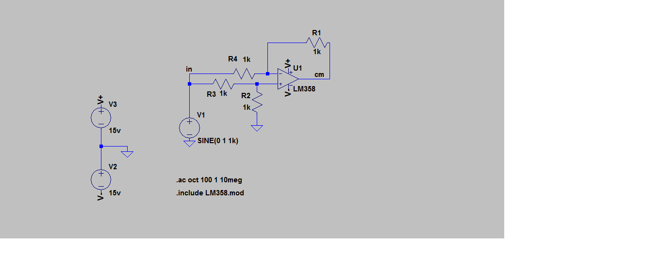

CMRR at 100hz was 90db. By the way I attached datasheet and configuration of circuit to this post.

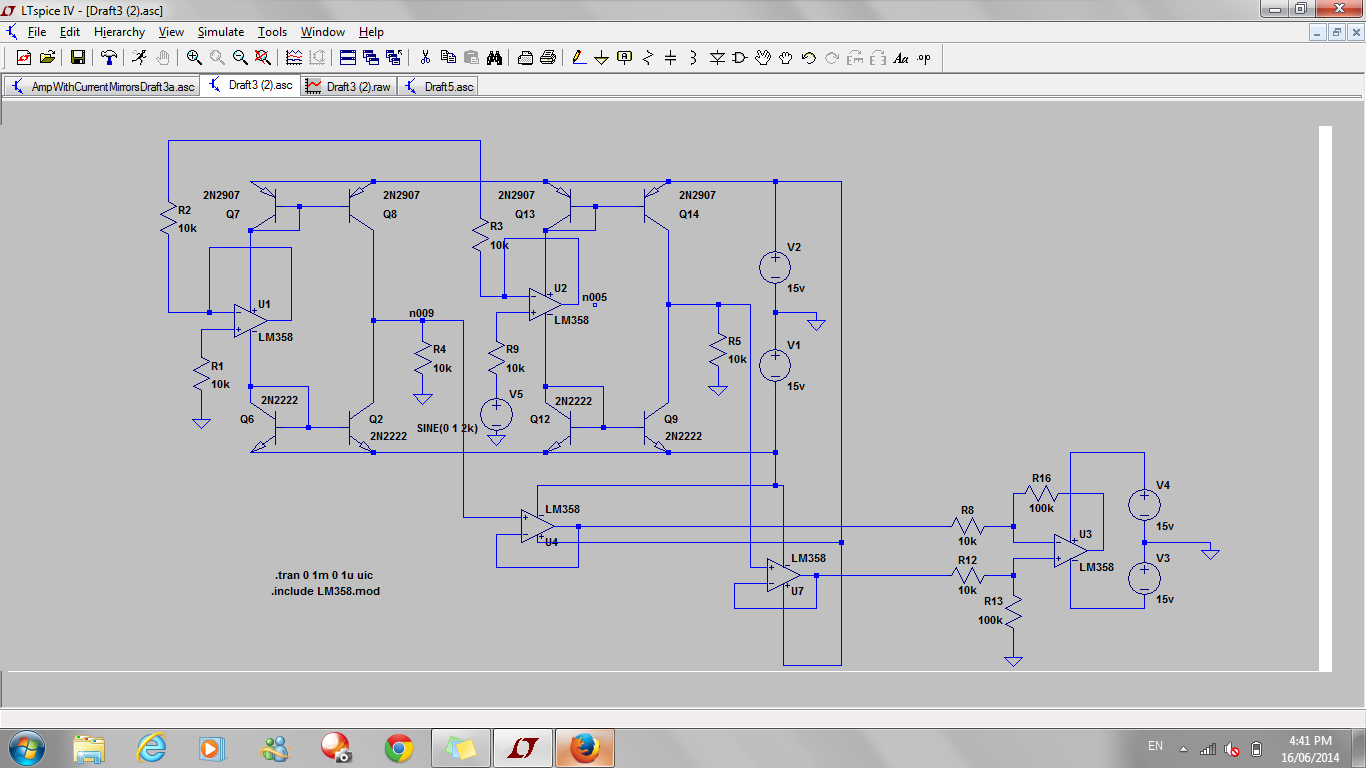

I assembled the whole circuit (below picture) with 741 op amp on solderless breadboard to get the differential gain. I had a strange result. The output voltage of buffer (n005) was 0.5v while 1v was applied to non- inverting terminal input. I have a question This problem might be because of internal structure of 741 op amp or not?

For testing CMRR you have to use resistors less than 10k, but 1k resistors are the most common to use i think, so using 1k resistors should give good results.

I use transistor arrays instead of discreet transistors and I thought when I use them, transistors in a array transistor are balanced at least more than discreet transistors.
I used potentiometer only for the last op amp at the last stage. I didn't null rest of op amps in my circuit separately.because I didn't know how to do it in a particular order. I think in a way that if I have offset in output voltage then I reduce it with potentiometer at the last stage. in general from the very beginning choosing a suitable op amp was one of my concerns. I think most of my problems mostly depend on the internal structure and construction of op amp.
Even though the voltage output of first buffer is 0.5v, The output voltage of both current mirrors are correct (0.1v). the very last voltage output is less than 0.1v instead of 1v. I checked all the connection 3 times all of them was correct. it's very interesting except the last stage all of voltages are almost good as I expected. the last stage works well when it is separated and not connected to the rest of circuit. After it's connected to the the buffers and current mirrors , dosen't work good and I have 0.1v which was the wrong result. before I build the whole circuit I assembled only half of the circuit which means I put one buffer at the input stage , one current mirror, a buffer next to it and the last stage. with this circuit I had the result as it had to be. In fact when I add extra components I run into this problem and don't have correct output voltage.
Sounds strange, why is there an output of 0.5v at the output of the first buffer?
Is the current mirror providing enough current for the 741 to operate correctly? 'Typical' supply current is 1.7mA, max is 2.8mA.
Hi Alec,
How could it not? Isnt the power supply terminal connected through the transistor but the transistor itself is connected as a diode, right? So it's like having a diode in series with each power supply lead, correctly oriented of course to allow conduction. Take a look and see if that is right.
Yes, you're right MrAl. I should have checked the schematic again before posting :oops:.
I solved my problem with first buffer. With 1v input I got almost 1v from the very last output. So the whole circuit is working ok now.

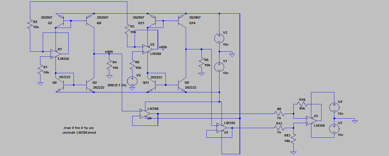

I have another issue, In real life circuit when I change R4 and R5 to 10k and apply 1v to the non inverting terminal of op amp shown in the picture, The last output becomes saturated. In fact My objective is to get gain of 10 with the input of 1v. I didn't decrease input voltage to 0.1v. maybe if I did that, I would have a correct result.
In general I did this thing to increase the gain of circuit. I could increase the resistors in the last stage but it affected the gain bandwidth product. Now I don't know how to increase gain without saturating the last output.

What do you get on the output with only 0.9v on the input?
In fact, what voltage can you go up to (0.5, 0.6, 0.7, 0.8, 0.9) before the output saturates?
I would not expect it to saturate because it's only 1v and a gain of 10 overall, which results in an output of 10 volts. You are talking peak voltage here i hope, because if you are talking RMS voltage then yes it will saturate because the peak of 10vrms is around 14.14 volts peak and that's too high for the 741 with plus and minus 15 volt supplies.

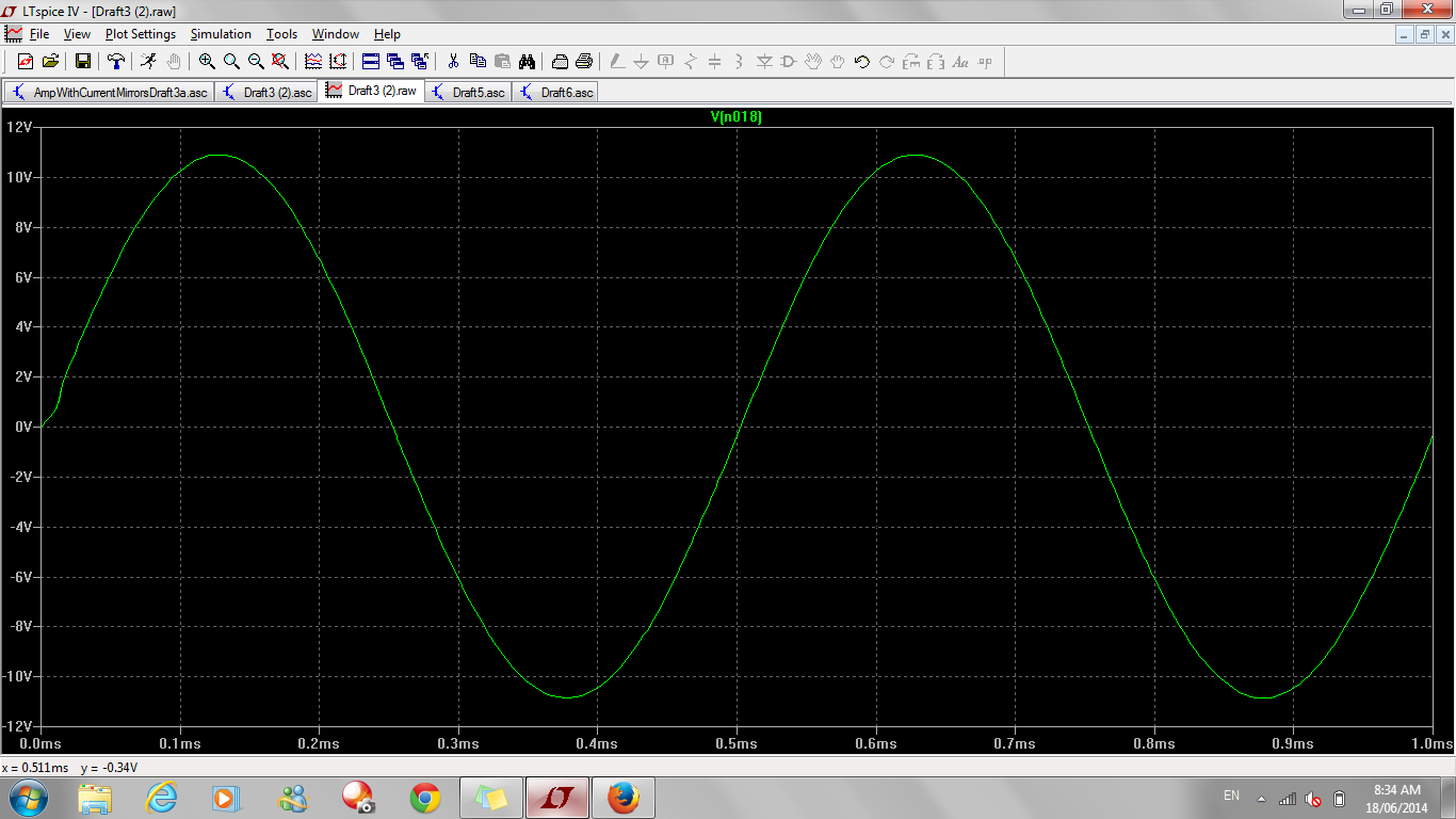

I mean when I apply SINE voltage with the peak of 1v to one of terminals. I expect to see a sine voltage with the peak of +10 and -10 at the screen of oscilloscope (like in the picture) but the output becomes saturated.
Ok i just had to clear that up for obvious reasons. Now we know you are using 1v peak for sure, and expect 10v peak output.
However, you did not specify what input you CAN use without a problem. Is it 0.9, 0.8, 0.7v peak on the input or does it have to be even less than that?
That output should be obtainable, but how do you know it is saturating? Maybe the current mirrors can not handle it?
When you have a problem like this you have to go through each stage one by one and find out what stage is causing it.
From what we know about the 741 it can handle up to about +12v on the output with light load when the supply is +15v, and -12v with a -15v supply. In other words, plus and minus 12v output with plus and minus 15v supplies. So if this is not working then you have to check the 741 itself.
On a separate plug board, try testing the 741 to see that it can get up to 10v peak on the output with a gain of 10 and 1v peak on the input. It's easy enough to wire this up with a couple resistors. Test that and see what results you get. You might also test all the 741 packages you have to make sure they all work ok.
