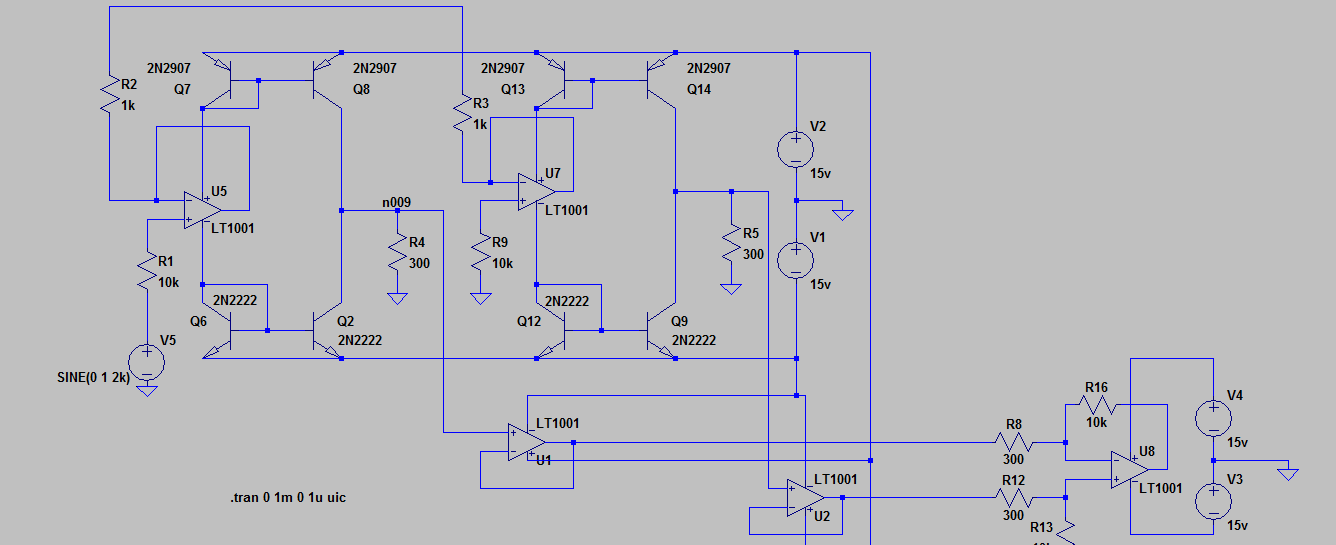

To MrAl: In post # 134 you said if I change 10k resistors at the output of first stage to 1k, gain would be increased. I did more change in the schematic of circuit (below picture) to get gain of 10 and prepare it for PCB. I would be grateful if you tell me these changes are right or not, at least in theory.
I decreased resistors value at the output of current mirrors to 300 ohm. In practice when I change resistors value at the output of current mirrors to 10k I get unbelievable and bad results because I don't have any matched transistor array so I decided to decrease it. I also changed 1k resistors at the last stage to 300 ohm because I want overall gain of 10 from this circuit. I didn't want to increase 10k resistors at the last stage so I did change 10k resistors at the output of first buffers to 1k to get a gain of 10 in overall. but I don't know can these changes affect the operation of transistors at the current mirrors and make them worse.

Before we can make changes that drastic we have to know what this circuit will be used for.
We can make changes here and there, but if they get extreme like that then we have to know what we are to use this for. Changing the output stage resistors to 300 ohms is such a huge change it may not even work at all.
I have to prepare this circuit to get gain of 10 for less than 1v input voltage I mean when I input 0.2v I get 2v at the output. In fact I was told to get gain of 10 from this circuit in practice by only changing resistors no matter what happens to gain bandwidth of this circuit or other stuffs. At this time I just want this circuit to work at low frequency like 100hz or less than 100hz. This circuit may use in biomedical applications and it's not necessary to have a wide band frequency.
Right now application of this circuit isn't really important. I should report a correct result by changing resistor values. I can put 1k resistor at the output of current mirrors also 100k and 1k at the last stage but I'm not sure last stage can work with 100k.

I don't see why you can't either. In theory it should be just a matter of selecting suitable resistor values.

Ok well i had to ask for the application and any other information that may be important because when you change the gain of the output stage, as said before, the gain bandwidth of the whole circuit changes. You wanted to use 300 ohm resistors and with 30k feedback resistor (and 30k resistor to ground) the gain would be 100, and if the output op amp GBW spec was 1000kHz, that means it would limit the useful gain bandwidth to only 1kHz. (1000/100=1). Since you have specified 100Hz, that relaxes the gain of the output stage a little.
The choice of transistors was not a good one for this circuit. Better operation would occur i think if you used a transistor made for lower current operation. The type of transistor being used (NPN) is similar to the 2N2222, which was made for higher current operation like 150ma. If you used a transistor made for lower current it would probably function better with higher value output resistors on the current mirrors.
300 ohms is too low however. That puts too much of a load on the previous stage. At 10 volts that would draw 33ma. You could check to see if the op amp can function with that much output current. Going to 1k would be better however. If i remember right, you need a gain of 10 with 1k resistors on the current mirrors and for the output stage, so the feedback and ground resistor would have to be 10k. That should work in real life although introduce a little offset. With 2mv input offset and a gain of 10, we could see 0.02v output offset. This is true of any pairs of resistor values that result in a gain of 10 however.

Yeah I had problem with this, too. because of all problems I decided to change pairs of 10k resistors at the last stage to 100k and didn't change resistors of first stage because they work ok with 1k at the output of current mirrors and 10k at the output of first input buffers. It's very strange to me why with 1k at the output of first buffers everything is messed up. Do these resistors affect current mirrors operation in theory?
Well the current mirrors throw a lot of things into question that the op amps dont. Questions like what is the best operating current, are they matched and how bad is the offset if they are not matched.

for gain of 10 I have to change 10k resistors at the last stage to 100k resistors. but I have no idea this change damage operation of circuit. In fact due to my problems with current mirrors I don't want to change resistors of first stage. with 1k and 10k at first stage and 1k and 10k at last stage the gain is almost 1.1
I only want to change 10k resistor pairs at the last stage to 100k to get the gain of 10.

For a gain of 10 the resistors would be 1k and 10k, that's it.
For an overall circuit gain of 10 when the input resistors are 10k and current mirror output resistors are 1k, the output stage has to have a gain of 100 which means 1k and 100k.
If the current mirror output resistor is 300, then that's at least 3.33 times less than 1k, so we need a gain of 333 at the output stage. With 1k and 333k we get this. If you dont like that, then try two stages each with a gain of sqrt(333) each.
