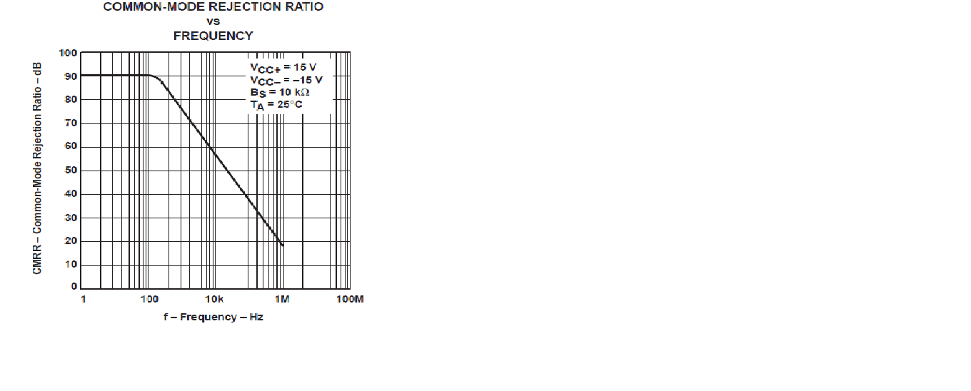

Well then explain why this "untitled2.png" pic is different than the one you posted in post #233?
In post 233 presumably you have the circuit that measures CMRR, and it does not go negative until after 1MHz or thereabouts.
You mean you are getting a bad result for this more advanced circuit?
The result in post number 233 is related to the circuit which is attached to post #233.

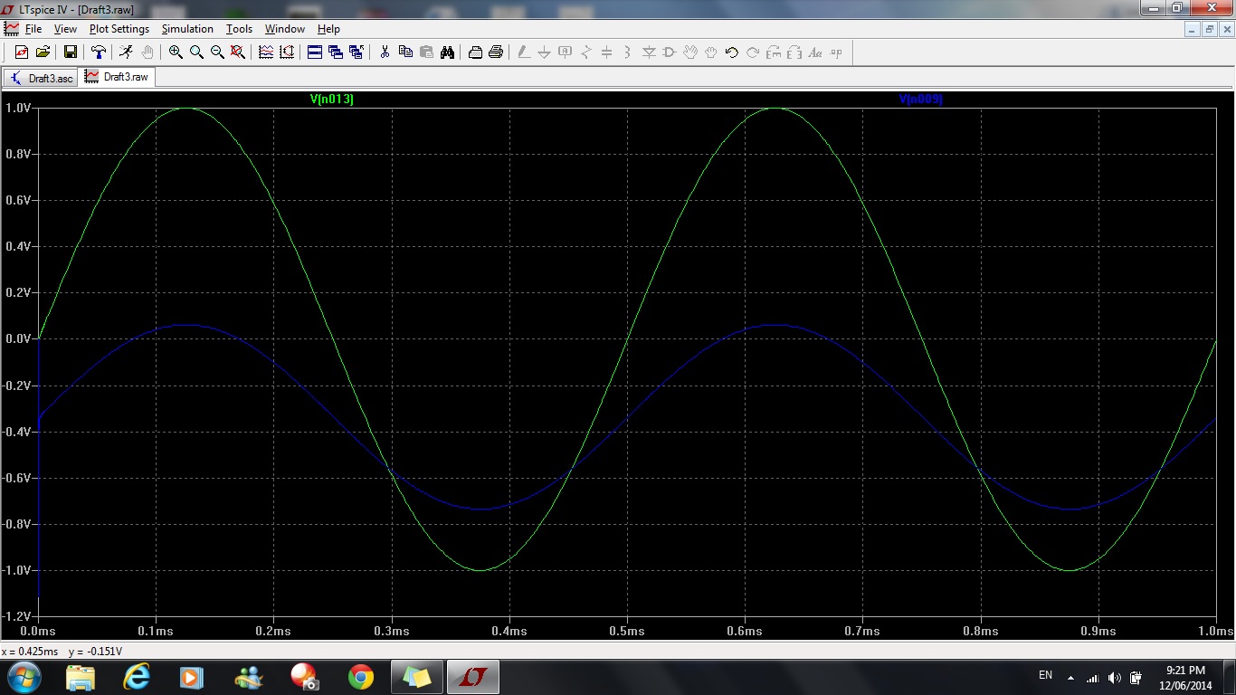

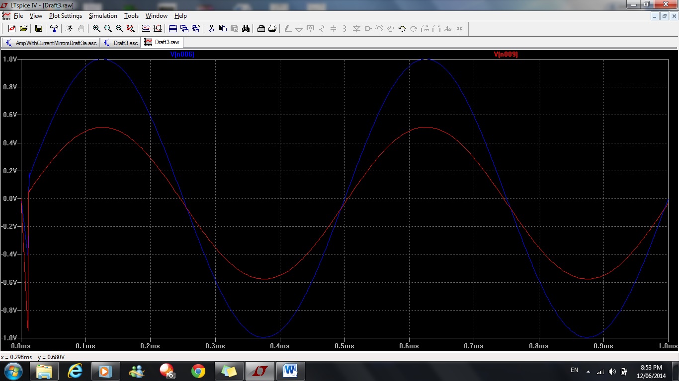

I did a little test on the differential part of this circuit with both LM358 and LT1001. In transient analysis I measured voltage of node 009 (output of first current mirror). when I use LM358 the voltage of n009 is more reasonable than LT1001. With LT1001 I have a voltage shift in this node and don't know this is because of internal numerical accuracy or something else. I attached the result and .asc file to see better what's going on.
Untilted 3 is for LM358 and Untitled 4 for LT1001

Ok then i guess we are seeing some peculiarities of the LT Spice program with some models.
For certain resistor values and limited frequency range we should see very similar results for both op amps, except when looking at the finer details like offset and gain bandwidth and stuff like that.
With LM358 I have a negative CMRR! With LT1001 diffrential gain is 8v instead of 10v! So it's better to use LT1001 for measuring CMRR and LM358 for calculating gain in LT spice software in order not to see these strange results.

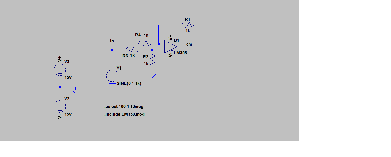

As a simple experiment, i gave the right hand circuit its own plus and minus 15v supply, and gave it its own input sine source. I then changed he left hand side circuit sources to 0v. One of the LM358 op amps then started to work normally again.
So when some of the components are taken out of the circuit, even if that circuit is not connected to the circuit being tested, the spice program starts to show the correct results again. That must mean there are limitations that we cant see just yet.
To test this yourself just view the output of one of the LM358's with a node label. Give each circuit its own supplies and input source. Ground each side supplies in turn while you test the other side, and test without grounding any supply voltages. Big difference between grounding one circuit and not grounding one circuit, when there should be no difference at all (testing only one circuit op amp output, that's all).
