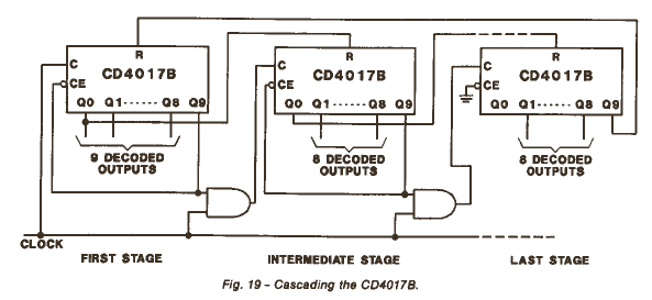

Ok well I double checked the circuit and now both 4017 chips are working fine. One problem. I want my first chip to do the "upwards" movement (i.e. led 1,then 2, then 3 etc) and the second to switch on the same leds, but in backwards movement (i.e. led 8, led 7 etc.). But, when I connect one of the second 4017's pins to one of the other 4017's pins where a LED is attached, that LED won't light up a single time (I find this strange since the 4017's have internal diodes at the output ports). Ofc. both chips don't switch on LED's at the same time.
The CD4017 does not have internal diodes at its outputs. The outputs go high or go low. Connecting two outputs together shorts them.
To make a Knight Rider bunch of LEDs that light back and forth then make a Knight Rider circuit (look for it in Google) that uses diodes in series with the outputs.

I have never seen a circuit that cascades two CD4017 ICs to make Q1 to Q20. But most datasheets show a circuit that has 9 outputs on the first IC and 8 outputs on each next IC.
