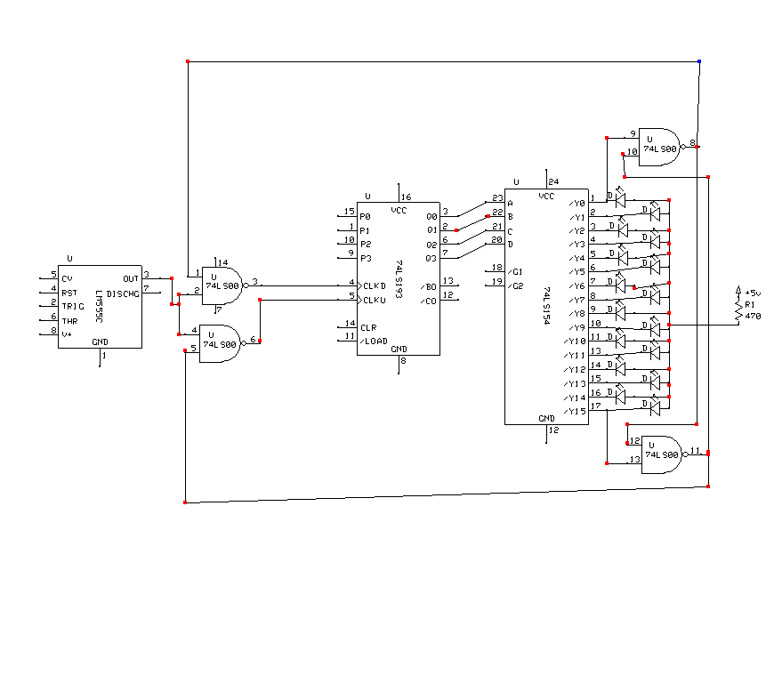

Knight Rider revised
Hello fellow Nuts, i must be excused from making mistakes it was late and in my hast forgot to look at changing the output configuration so you could get your delusional brains around the principle.
I will explain:
The 4017 can not by it self go back and forwards as it is a simple dive by 10 counter it is in fact an illusion its all in the way the LED's are connected- it just appears that the LED's are scanning left to right and right to left.
What i have done is actually count from 0 to 4 with the LED's arranged in a left to right pattern and then count from 5 to 9 with the LED's arranged in a a right to left pattern. Presto- the LED's operate one way then in a reverse direction!
If you now look at the outputs of the 4017 you will see them shown wired from top to bottom of the drive transistors from 0-9 i have arranged the sequence as 0, 9,1, 8,2,7,3,6,4 and 5. So the LED's are scanned from left to right for 0-5 counts and from right to left for 5-9 counts.
The connection of the LED's is also unusual when the 0 output is high LED 1 and LED 3 light up and there is a separation of LED 2 between them. When the 1 output goes high LED 2 lights as well as LED 4 and so on.
Have fun.

The old Knight Rider had a light display that went back and forth.
Your LEDs are just a Chaser that goes around and around and not back and forth.
Yes it was late and i did not show the correct output configuration. I am like most Guilty of to many hours on the NET.
I have uploaded a new drawing and explanation to show how a 4017 can work in this fashion.

Do you know what back and forth means?
looking at your output LEDs, you have 10 pairs of LEDs (a pair is 2)
no back and forth motion that I can see. Just each time an output goes high tow LEDs (1 pair) lights up.
back and forth is the LEDs light up in sequence (one comes on while the previous one goes out) in a "to the right" sequence then reverse by sequencing from left to right.
all I see are a bunch of LEDs comming on in pairs.
If you post a schematic at least try and get the components in the right order and take suggestions by not critizing a knowledgeable person like Audioguru.

Seems everyones an expert:
The 4017 can not by it self go back and forwards as it is a simple divide by 10 counter it is in fact an illusion its all in the way the LED's are connected- it just appears that the LED's are scanning left to right and right to left.
print the attached PDF and build it. if im wrong ill suck it in and resign.
and as for my credentials you would do well to not scoff at someone who has an education in this field. my retoric to Mr Audioguru was for the replies on the clock and the fact that the debate is for the correctness of the 4017 as a scanner and not just a continuous loop counter.
Now get bread boarding or use what i give my students to sim on the computer by downloading yenka at Yenka.com select home user under registration and you can use it for free. I do not have a go at Mr Audioguru's helpful hints as i have read many of his responses and find him well schooled, but when the original schem had the correct values and was advised of same do you think it apporpriate to correct me on such trivia? Oh and yes we do get things wrong in this line of work thats why we have debuggers the last circuit had a design fault one output was incorrect, this attached schem has the fix. So who are you?

Diodes are usually used to make a CD4017 light the same LEDs back and forth.
you used some outputs to drive LEDs forward and used other outputs to drive different LEDs backwards. It is your positions of the extra LEDs that make the appearance of back and forth.
