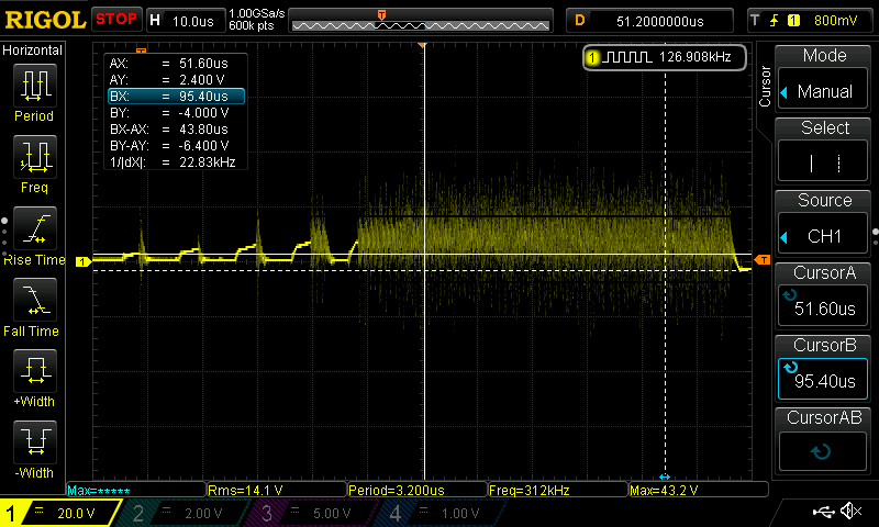

I scope primary winding and probably reason is core is vibrating becouse there are like five 50khz pulses and then huge "gap" that makes with next wave 450Hz.
So i need to lower duty cycle for lower loads to have lower "gap". Hmm
Also there is huge noise when sound comes.
This is sensed on current transformer

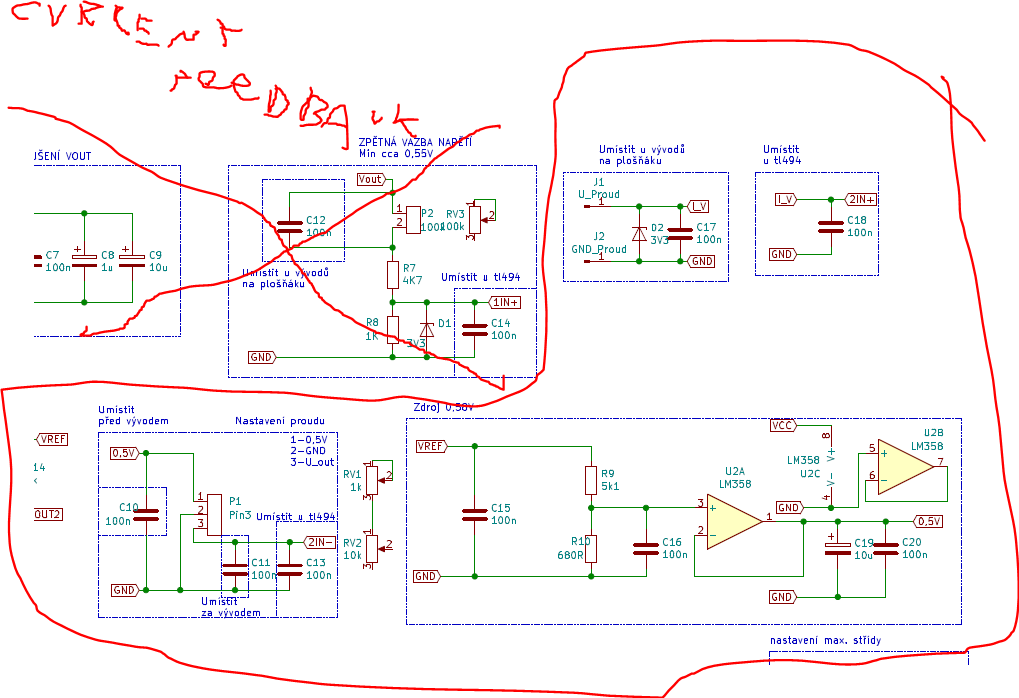

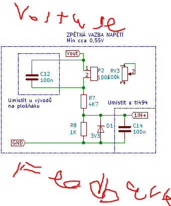

My Circuit with tl494 is badly designed.
I found several errors that needs to be fixed. I already fixed it manually when prototyping. And now its working fine. No crappy buzzing anymore.
Pin 13 needs to be connected to Vref
Resistors need to be conected after emittor of Q1/2.
recalculate RT and CT for push pull mode (two times higher RC constant)

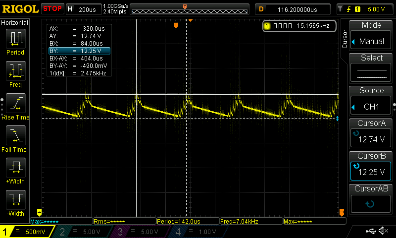

I found out that when load is current limited no buzzing / squezing occurs. But when its not squezing occurs.

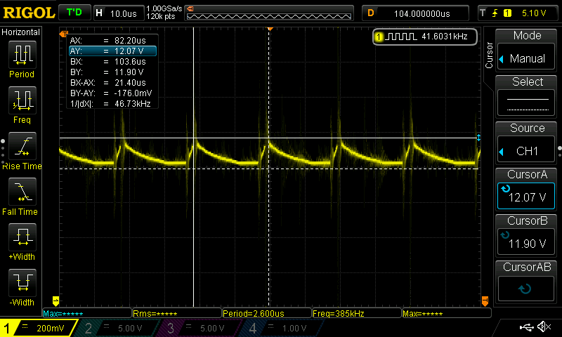

Output voltage attached. When its not current limited there is 500mV ripple at 2,47kHz.
When its current limited there is 200mV ripple and 47khz
