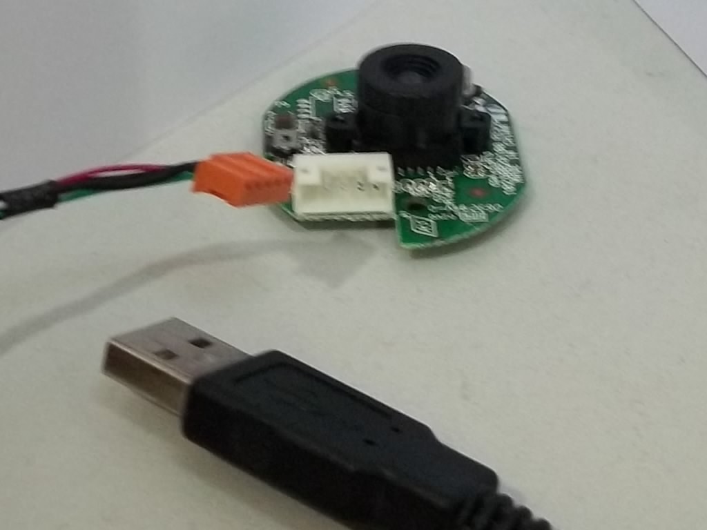

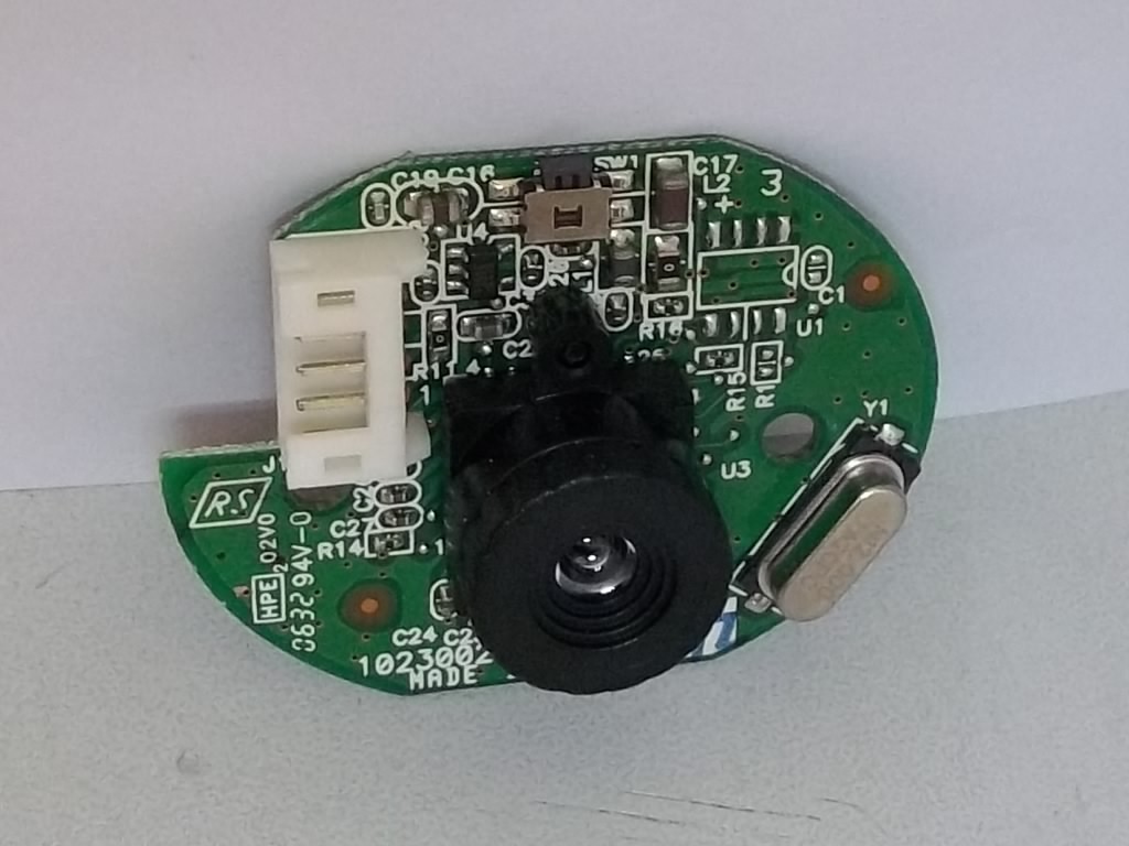

Anyway, if your webcam is basically junk sitting on a shelf, and you thought to give it some new purpose, nothing really to lose if it gets destroyed. Open it up, post some pictures of the guts. We'll be better able to give suggestions.

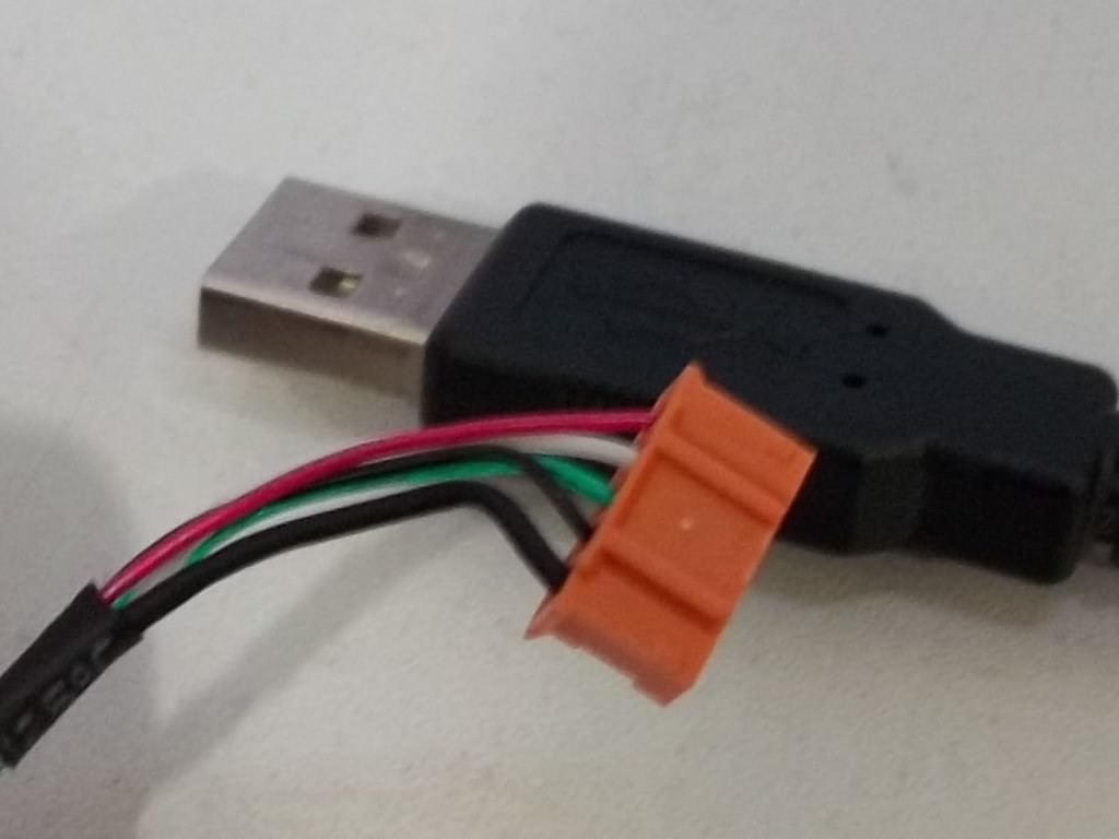

For me, if I came across a USB webcam, I'd eventually take it apart hoping to find the camera module is on a seperate board, with three wires come off. Before removing the camera module, I follow the traces to determine the power/signal wires. There is some chance, as these cameras are mass produced and small by a few companies. Seems simpler and cheaper to add the computer interface, then to intergrate the camera and drivers and optics.

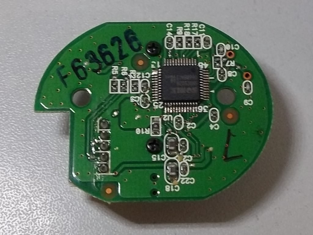

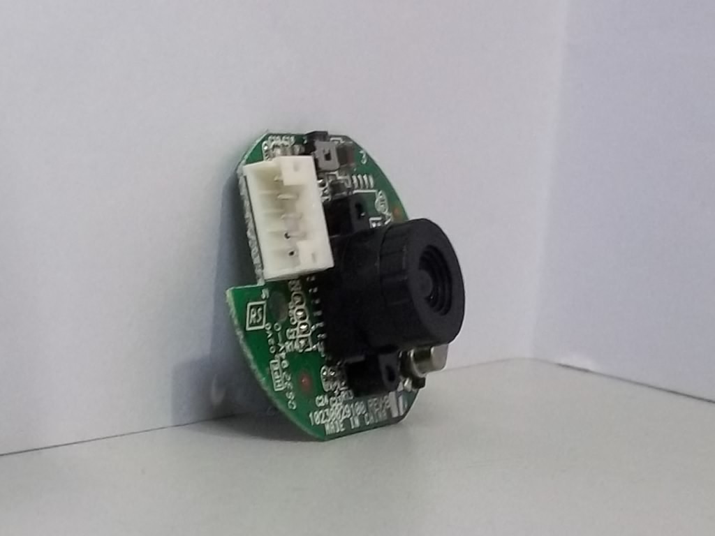

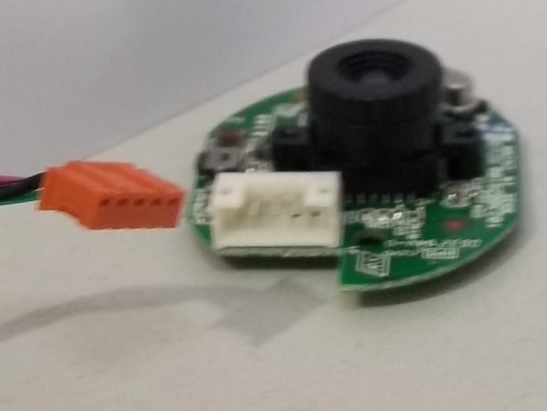

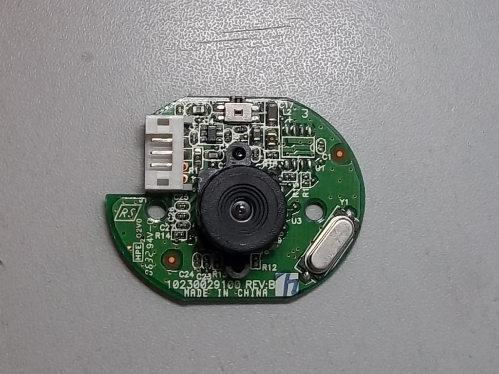

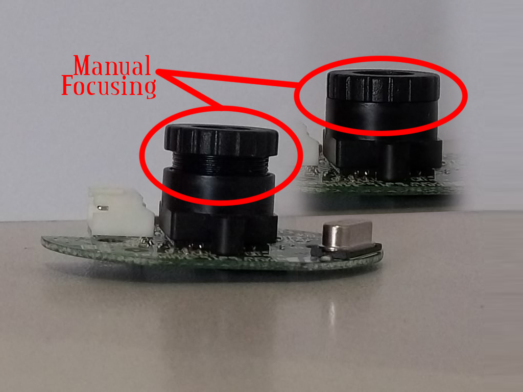

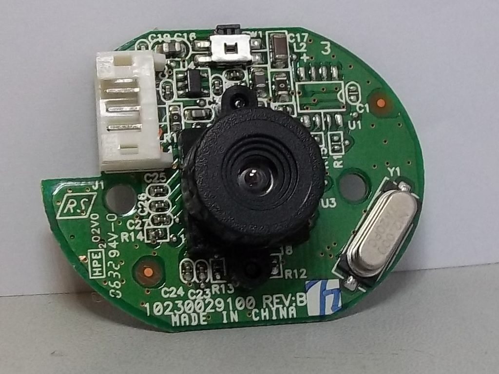

I have a Genius Webcam
I have a Genius Webcam. I want it to serve as a cam that allows me to know whose at the door. I want it to be connected to my TV. I have attached it's inside pics. please help me.
