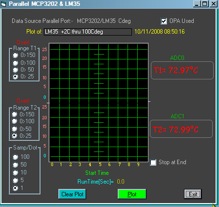

For reference, there is a MCP3208, a 8 adc channel version of that ic.
I use the 2 and 4 channel, with additional OPA's to 'span' the voltages.
Using a LM35 tempr sensor + OPA, the adc's give a tempr display.
example image attached.
Keep well!

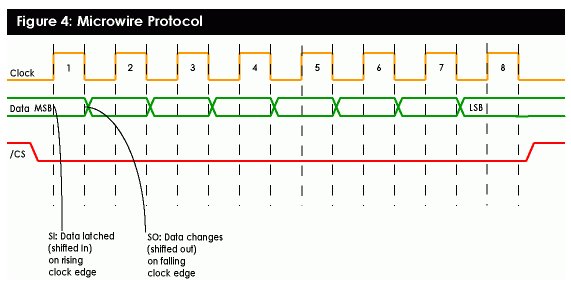

The ADC chip Eric suggested uses a serial interface. So you select ADC input channels by sending data to the chip serially. Your software has to output clock, data, and chip select. Kinda like in image below. In the data stream you tell the chip the channel you want to select.
Note: The image below is Microwire but is similar to SPI as used on the MCP part.
So on your Pport you would have something like so;
D0--->Clock
D1--->Data
D2--->Chipselect/
SO you would Outp data bit on D1
then outp Chipselect low on D2
then in software toggle clock low to high to low on D0. I would suggest making a clock routine to save on code writing. See diagram.
You might want to google SPI to learn more about it.
