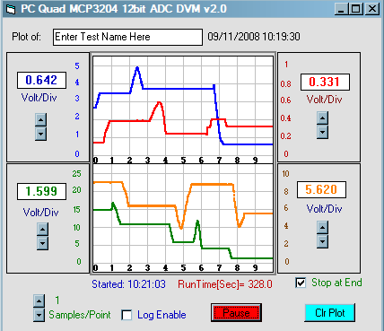

hi Owen.
I can help with QB and VB5 for controlling the PC's parallel port. [ I would prefer the VB5 route.:)]
I use Win XP Pro and have two DLL's which allow port control, Win XP blocks direct access to the port without these DLL's.
Vista I dont know.
You will require a simple interface on the port output, usually a 74LS06 or 07.
This acts as a buffer for the port and peripherals.
I use the MCP3202 or 3204 dual /quad 12bit adc convertors.
Available from Farnell, get the datasheet from Farnell.
If you are interested I will post details of the PC interface.
The Millenium Tower is due South of my location, about 5 miles.:rolleyes:
Look at the attached pdf for the PC parallel port.
This image is shows the results I get from VB5 with the MCP3204 circuit.
If you are interested I will extract and post the SPI routines from my VB5 programs.:)
EDIT:
To complete the package a zip file has been added.
Its been stripped down to the bare essentials, tested and works OK.
The two DLL's must be loaded to the users C:\Windows\System folder.
The VB source code and MCP exe file are also in the zip.
Create a folder named MCP3204 and unzipped the zip file to that folder.
If you want to run the exe file included in the zip, you must have the Visual Basic 5 runtime files in the System folder.
The smaller image is the stripped down version.
