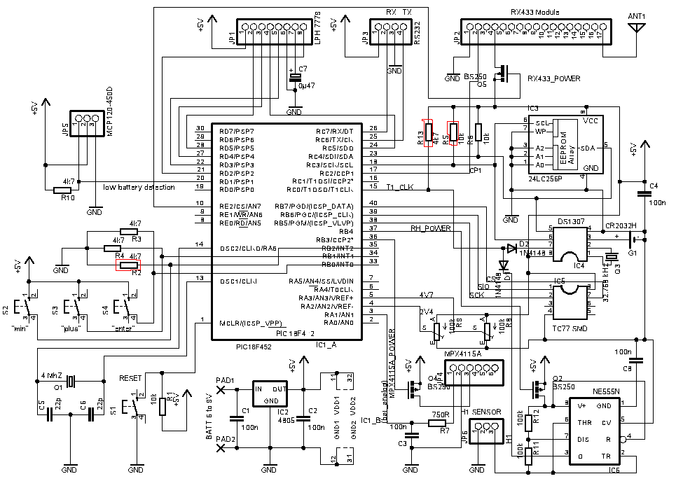

Weather station (PIC18F452)
alinpion
How do you calculate R2, R13 and R5 rezistors and what is their purpose in the schematic?

hi,:)
R2 is a 4K7 pulldown resistor and R5 & R15 are pullup resistors, 4.7K/10K
Their purpose is to pull the pins low or high when the driving switches are open.
Some ic's external to the PIC require pullups. [R5 &13]
The value of 4.7K is a typical value, allows about 1mA thru the switch contacts.
What about C3, C4 and R7? What is their purpose?
Why are you asking the function of these components.:)
C3 and R7 are a simple filter on a analog input, C4 is a +5V decoupling cap.
