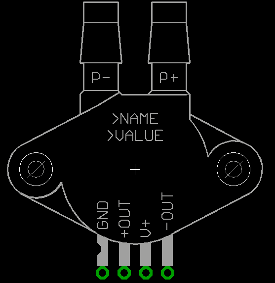

for water level detection use a sealed pressure sensor such as MPX2050DP.
It won't get in touch with water since it is completely encapsuled with two pressure ports to connect a PU-hose (PU=polyurethane)
To measure the accurate water height in the tank connect the positive pressure port to a PU hose (inner diameter 4mm) completely submerged to the ground of the tank. Leave the negative pressure port open (closing it with a short piece of PU-hose with a cigarette filter inserted taking care that no insects will block it).
The measured air pressure equals exactly the height of the water column in the tank.
At 50KPa the (linear) output voltage is 40mV while at zero pressure the output voltage has an offset of -2mV. Measuring differential pressure the measuring result will always be correct regardless of the present barometric pressure.

Hi premkumar9,
I've already designed an Eagle package for the MPX2050DP.
The pin arrangement is such, that the pins will produde through the PCB if bent at a right angle.
Boncuk
It is necessary to keep the sensor at the ground level of the tank. Right?
The answer is definetely NO.
The sensor, if the suggested type with two pressure ports is used it might be located on the moon and still indicate the correct pressure, provided both ports are located near the "target" (Who wants to to install a 380,000km long plastic tube? :) )
Seriously, the sensor might be located far away from the water tank which is not much practicable because of the need of long PU-hoses. (cable is cheaper)
The end of the hose connected to the positive pressure port of the sensor has to reach down to the bottom of the water tank, because it has to transfer the height of the water colomn in an equivalent value of air pressure. The negative port remains unconnected to sense atmospheric pressure.
