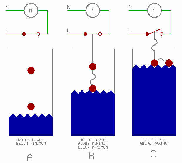

Hi tariq,
you need only one switch if you use two floats connected to a cord (rope). Make them adjustable along the cord according to the desired ON/OFF water level. The lower float will determine "pump on" position pulling the switch ON if the water level drops beyond a certain point. The upper float will release the switch as soon as maximum water level is reached.
For the function refer to the attached sketch.
A) water level well below minimum. Both floats (filled with sufficient water to overcome the spring force of the switch) pull the cord. (switch on)
B) water level above minimum, but upper float still pulling the switch. (on)
C) water level at maximum, no more force on the switch, cord released - switch off
Additionally this method doesn't bear the possibility of electric shock or electrocution since the switch won't get in contact with water.

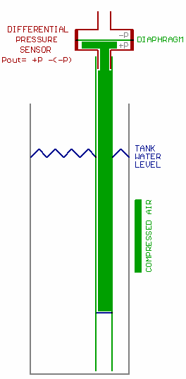

Differential pressure sensing is always true as long as the measuring tube is sealed air tight on the +P side of the sensor which applies using PU-hosing.
To make it absolutely safe and maintenance friendly you might use a manually shifted three-way valve to blow compressed air down to the bottom of the water tank and then switch back to normal operation. There is no danger involved for the sensor.
The MPX2050 can stand a pressure of 200KPa, which won't be exceeded even blowing at 10 bar (10,000KPa) pressure through the hose. At a pressure inside the hose corresponding to water pressure (49KPa at 5m) the air will vent through the open end of the hose at the tank buttom.
Water won't normally take up oxygen (no chemical reaction) out of the atmoshere, so the pressurized +P port should always represent the actual water level compared with local air pressure.
Differential pressure sensors are reliable and relatively cheap. What makes the pressure transducers expensive is the conversion to electric output, which you can do yourself using an appropriate instrumentation amplifier.
The MPX family already puts out a linear and temperature compensated voltage. You just have to take care of proper zeroing and amplification.
Attached is the principle of pressure measuring in a water tank.

This attached fig makes sense to me. The green colored area is compressed air. So this air column will transfer the pressure at the bottom of the air column to the sensor diaphragm. Isn't it?
Exactly that, and it's accurate! No matter how high you lift the upper end of the "pressure" hose the result won't change.
Remember, I posted you might put the sensor on the moon and connect the positive pressure port to the tank and the negative port to earth atmoshpere.
It will result in equivalent water pressure in your tank.
The only problem which might arise is leakage.
If properly sealed nothing can go wrong.
Boncuk
