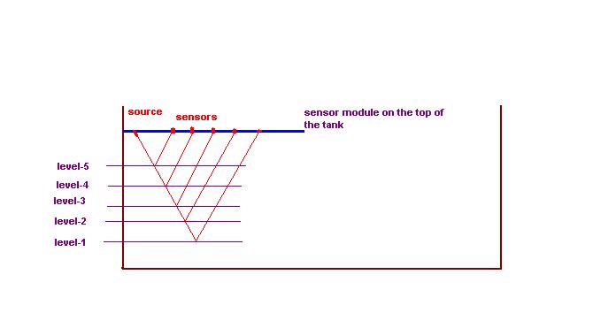

just a suggestion, you can use an IR source and few sensors as shown in the arrangement. but the water surfce flaxuation may disturb your sensors. may need some guide before the snesors too.

Hi, thanks, thats a good suggestion.
I've also looked at IR in the past, but what I'd like to have is a 2 (or 3) wire sensor that can still detect multiple levels. In your suggested scheme, one would require one wire for each level to be detected.
I vaguely remember having read a technique, but cant find the article anymore. Basically, you use just one source, and one detector (3 pin demodulator). You begin by modulating the transmitter at its optimum frequency (38 KHz?) and keep transmitting a single character, and keep reading the pings. You then keep reducing the modulation frequency till reliable pings stop. The difference between the ideal frequency and the one at which you no more get a ping would then be a function of the distance.
