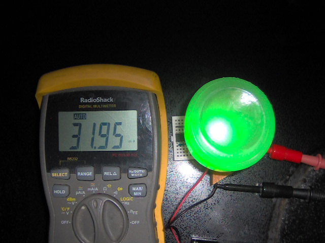

Mosaic:
A green led is going to be perceived as much brighter than the amber one you linked too. I picked up a few these Cree green 4mm ovals for experimenting. They are really bright, and have a moderately wide view angle.

I like your idea of using the 2'x4' fluorescent fixture as the case. I still think the baby food jars have merit, cost free, and would have a neat 3d effect. The downside of the jars could be their cumulative weight?, and fragile nature.
I will try and throw up a pic of the jar, with some frosting paint, and the green 4mm oval.
The dispersion chart is in the data sheet, and since it is an oval there are two different angles. It looks like 100 deg and 45 deg for horizontal and vertical planes respectively. At a focal distance of about 2" it seems pretty diffuse, with still some hot spot. A plcc or 5050 chip will give a closer focal point, more like 1", I would think.
In a dim lit environment, the Cree 4mm seems pretty good. In a more daylight environment, I could see wanting more lumens. Kind of a subjective thing.
It was impossible for me to get an accurate rendering of the Cree 4mm oval and the frosted baby jar. Used the Red-eye flash, macro setting, with some tissue over the flash. Using no flash, the picture comes out overexposed. Not going to spend anymore time on it for now.
