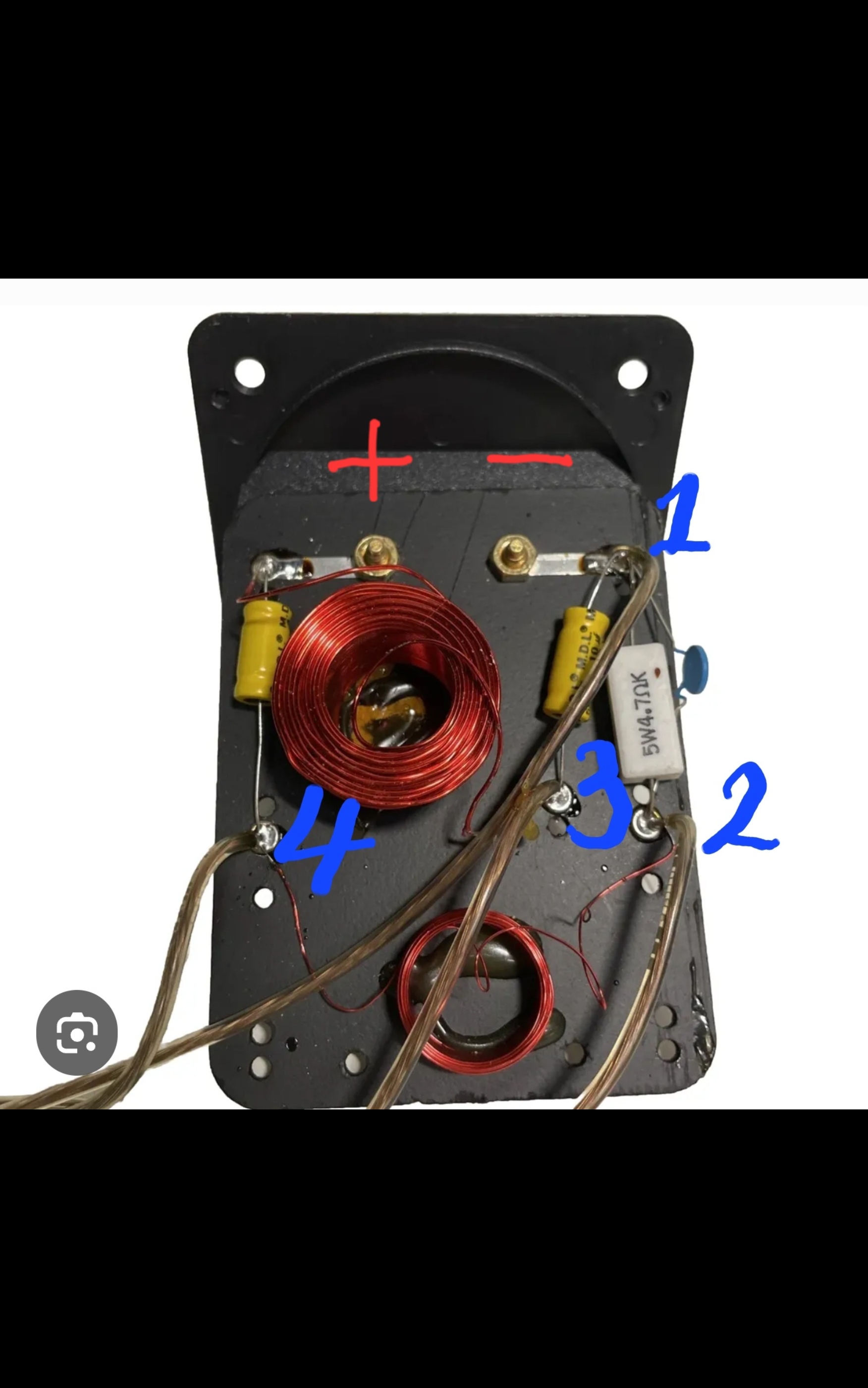

I'm wondering if someone could help. I have a pair of Jamo Cornet 145 speakers I'm restoring and whilst stripping th em down like an idiot I forgot to take some pics of the wiring from the crossover to each speaker so I havnt a clue which goes where
I've attached a pic...hopefully you can see and would just like help which two go to the tweeter and which go to the woofer + and -.
I've numbered them 1 to 4 in the hope someone can say 1 to woofer + etc etc
Hope someone can help....

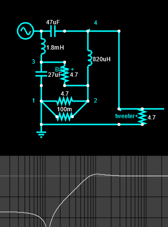

Bass += 4 , -=1
Treble +=3 , -=2
Polarity matters in the midrange.
based on a rough simulation
