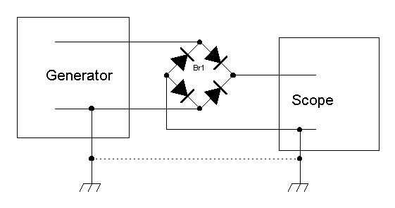

hmm seems like i can only get a half-wave rectified waveform from a sine wave. I input a sine wave into the 2 ~ pins and the oscilloscop probes to the + and - pins and only managed to get a half-wave.
Can any experts help me to get the full-wave rectified waveform?

You probably have a sine-wave generator with one of its output wires grounded. Then only half of a bridge rectifier works and the output is half-wave rectified. A Full-wave Rectifier Circuit using opamps will make full-wave rectification.

Acutally i don't quite get what you are meant by my signal generator being grounded... I think i will be clearer if some1 can provide me a simple circuit diagram showing me how to connect up to get a full-wave rectified waveform.

Here's what happens when you connect your grounded generator, and grounded scope, to the bridge rectifier. Notice the dotted connection, that's the ground connection in your house between the two sockets, it shorts out the bottom left diode of the bridge.

thxs for all the help. I managed to get a fully rectified waveform when i use a battery power supply to operate the waveform generator. Think as long as the generator and the oscilloscope are not from the same ground, i will get the fully rectified waveform.
