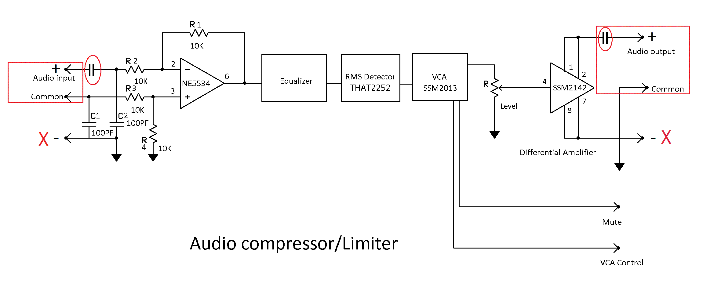

The compressor does not have input or output coupling capacitors so its DC voltages near 0V might mess up your signal source and amplifier.
Now you wrongly show the (+) input connected to ground and the "Common" as a (+) input.
When the wiring is fixed then the (+) input and output can be the live audio signals and the commons are the shielded grounds of their cables.
Your SMPS probably is noisy but its different voltages will not matter.
Ok I fixed input and used a capacitor at input and output live audio line to block DC.
- Can you assume correct value of the capacitor? I have 100nF film, 0.33uF and 2.2uF polarized tantalum. Polarized is not good but I will measure voltage across the cap and will fixed polarity.
- Another: PC has Mic in and has 3 pins- L, R and Gnd. Most of the time people record audio by shorting L and R. So PC gets same audio to L and same audio to R. Now the compressor has (+) out and (-) out. Is it better to use these (+) and (-) as L and R input to the PC? Or has no benefit? (If it improves nothing then I will use (+) audio for L and R (shorting L and R input of PC) as I said above.

The + and - inputs and outputs are balanced mono inputs and outputs, not stereo. Balanced means differential. When the + input goes positive then the - input goes negative and if the + input goes negative then the + input goes positive. Because they are differential then they cancel common-mode interference like mains hum picked up by the cable. Common-mode interference is picked up by both wires and when fed to an amplifier that has balanced differential inputs then any signal that is the same at both inputs is cancelled.
A telephone line is also balanced. When the signal on one wire goes positive then the same signal on the other wire goes negative and vice-versa. The telephone pairs of wires are not shielded and do not pickup mains hum or common-mode interference from other pairs of telephone wires.
If you want to convert stereo to mono then shorting outputs might overload and destroy their output opamps. Use mixing resistors instead, a 1k resistor from the L source and another 1k resistor from the R source. Join together the free ends of the resistors to make the mono signal of L and R mixed together safely.
And about value of coupling capacitors?
The value of a coupling capacitor has the RC -3dB response at the frequency the reactance of the capacitor equals the resistance of the source plus load resistances. The -3dB frequency is called the cutoff frequency where the level is down to 0.707 times the level of higher frequencies and is heard as a small but noticeable drop in level.
Calculate it as C= 1 divided by (pi x R x f). So the capacitance for a very low impedance source driving a 20k load at a cutoff frequency of 30Hz is 267nF. Use a 270nF or 330nF film capacitor.
I cheat a little since 1/divided by pi is almost 0.16 so I do it as 0.16 divided by (20k x 30Hz).

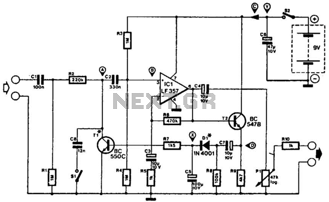

Hi again all,
Time to time I get hit by simpler compressor. Many of them known as very bad design. I just feel that the 'Elektor' magazines are good source of designs.
I found a pretty accessible compressor made by two transistor and an OpAmp. Do anyone have experience about such circuitry?
The ebook (pdf) 'Elektor 303 Circuits' has included the compressor with detailed description at 12th page.
Where is the circuit?
Hi MrAl,
From an hour I am trying to do it from my vintage cellphone! I am clicking on 'Upload a File' button but not getting upload window. I was talking about a compressor found in 12th page of the file: https://archive.org/details/Elektor_Electronics_303_Circuits
I will try with other's cellphone soon, if it works I will be able to show schematic soon.
EDIT: [color= red] I guessed it's system error. I tried from Android phone's Operamini and from UC browser too. Not getting upload file picker window! [/color]
The "file" has 338 pages and I will not download all of those pages to see only the 12th page.
Please attach here only the compressor project.
That is a typical peak-detecting feedback compressor. Its main drawback is that it can cause background noise to "pump" up and down as it compresses and releases. Maxim has a single-chip microphone preamp with that circuit built-in. Ada Fruit has it as a module.

Here I found exact link of the schematic I was asking about (already has been posted to next.gr): http://www.next.gr/uploads/135-11110.png
