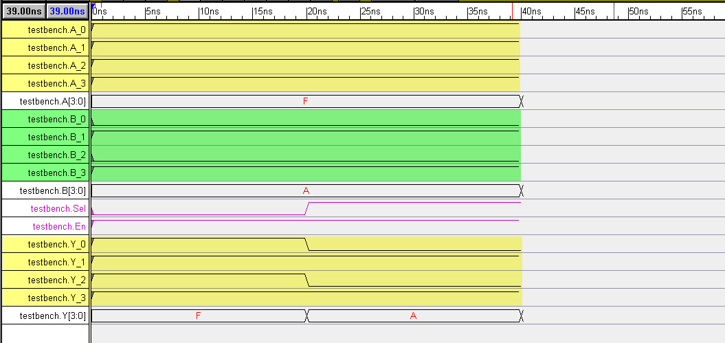

Could you please help me with the code below? It's totally messed up. It does compile but logically it's all wrong. Where am I going wrong? Thanks.

I think you are missing A and B in your sensitivity list, this way Y is updated only when En changes.
Thank you, kubeek.
Unfortunately, it's still not working. I have attached the screenshot of output. Could you please give the code a proper look?
Thanks.

I guess what you want is
//4-bit 2x1 Mux
module two_to_1_mux(Y,A,B,Sel,En);
input [3:0]A;
input [3:0]B;
input Sel,En;
output [3:0]Y;
reg [3:0]Y;
always @(En, Sel, A, B)
  if(En==1)begin
  if (Sel==0)
  assign Y = A;
  else
  assign Y = B;
  end
endmodule
//stimulus
module testbench;
  reg [3:0]A;
  reg [3:0]B;
  reg Sel, En;
  wire [3:0]Y;
  two_to_1_mux mux(Y,A,B,Sel,En);
  initial
  begin
  A<=4'b1111;
  B<=4'b0000;
  En<=1;
  Sel<=0;
  #20
  Sel<=1;
  #20 $finish;
  end
endmodule
but I would rather write it as follows, i am not sure if assign statement inside always block is synthesisable, this way it definitely will work:

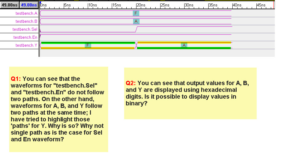

I hope the code is correct now. I'm using the code given below.
Could you please help me with these queries related to the output diagram for the code? I'm using Verilogger program. Thanks a lot.

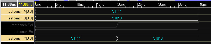

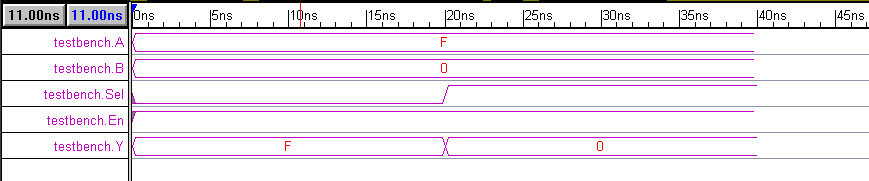

I nevere used verilogger, so i can't really help you with the second question. Try right clicking the signal if there are some options.
As for the first one, since A, B and Y are buses with many bits, the program is showing them with two lines - this signifies that they are buses and their value is written there. If a single bit signal changes, then you see an edge like with the Sel signal.
When a bus changes state you need to show it somehow, and you can't show a single edge since that would not be true, there could be an edge going up or down on any of the bits, so you show it like a data block with value F has changed into a block with value A, and that double crossing shows where all those edges would be.
Thank you, kubeek.
I was able to make the output diagram more understandable by following your suggestion - i.e. right clicking the signals.
