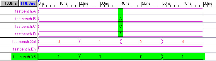

Q1:
I have found a big error with the code of 4-bit four-to-one mux you helped me with. I have checked the code of 4-bit two-to-one mux separately and it works okay. It means that the error lies somewhere in the code for four-to-mux. You can see here that output Y3 is "1" when it should be "F", and it's "0" when it should be "A" and so on. Please help me with it. Thanks.
//4-bit 2x1 Mux
module two_to_1_mux(Y,A,B,Sel,En);
input [3:0]A;
input [3:0]B;
input Sel,En;
output [3:0]Y;
reg [3:0]Y;
always @(En or Sel or A or B)
  if(En==1)begin
  if (Sel==0)
  Y <= A;
  else
  Y <= B;
  end
endmodule
//4-bit 4 to 1 mux using 2 to 1 muxs
//we will use the code for 2-to-1 mux given above
module four_to_one(Y3,A,B,C,D,Sel,En);
input [3:0]A;
input [3:0]B;
input [3:0]C;
input [3:0]D;
input [1:0]Sel;
input En;
output [3:0]Y3;
two_to_1_mux mux1(Y1,A,B,Sel[0],En);
two_to_1_mux mux2(Y2,C,D,Sel[0],En);
two_to_1_mux mux3(Y3,Y1,Y2,Sel[1],En);
endmodule

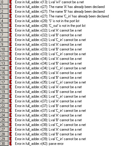

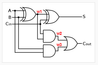

I have written the following code for a full adder but it's full of errors. Could you please help me with it? I see that some of the error lines point out that "...has already been declared". In the past, I used to use the same identifiers or names for inputs and outputs both in the main code and the stimulus.
//full adder
module full_adder(S,C_out,A,B,C_in);
  input A, B, C_in;
  output S, C_out;
  reg S, C_out;
  wire w1;
  always @(A or B or C_in)
  begin
  assign w1 = A^B;
  assign S = w1^C_in;
  assign C_out = (w1 & C_in) | (A & B);
  end
endmodule

Ok, so some things about Q2.
in full adder either use those assign statements outside the always block and remove reg from S and c_out, or make w1 a reg. You cannot assign to a wire inside a procedural block (always block)
In testbnch - You need to define wires and regs first then instantiate components, not the other way or even mixed. Also you´re missing end before endmodule.
Thank you, kubeek. The code for a full adder works now and output waveform is good.

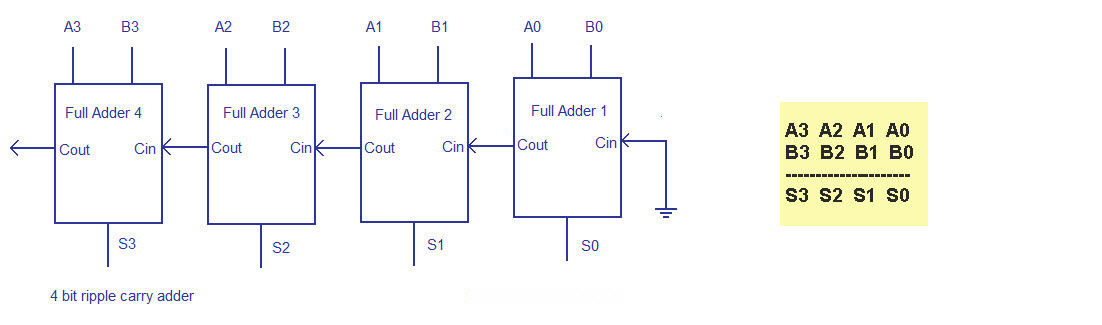

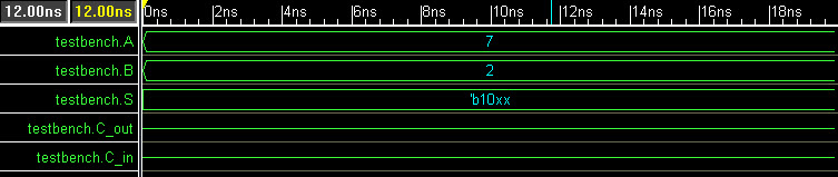

Now I have tried to code a ripple carry adder. You can see here that the displayed values of "A" and "B" are incorrect; A should been 1111b=F and B should have been 1010b=A. Besides this, there are some other logical errors. Please help me. Thanks.
//full adder
  input A, B, C_in;
  output S, C_out;
  reg S, C_out;
  reg w1;
  begin
  assign w1 = A^B;
  assign S = w1^C_in;
  end
endmodul
//4-bit ripple carry adder
//we will use full adder code given above for instantiation
module four_bit_ripple_adder(S,C_out,A,B,C_in);
  input [3:0]A;
  input [3:0]B;
  input C_in;
  output C_out;
  output [3:0]S;
  full_adder adder1(S[0],C_out0,A[0],B[0],C_in<=0);
  full_adder adder2(S[1],C_out1,A[1],B[1],C_out0);
  full_adder adder3(S[2],C_out2,A[2],B[2],C_out1);
  full_adder adder4(S[3],C_out3,A[3],B[3],C_out2);
endmodule
//stimulus
module testbench;
  reg [3:0]A;
  reg [3:0]B;
  wire [3:0]S;
  four_bit_ripple_adder fourBit(S,C_out,A,B,C_in);
  initial
  begin
  A=1111;
  B=1010;
  #20 $finish;
  end
endmodule
I think it is time for you to learn how to troubleshoot your designs. Does your software alloow you to see what is going on inside the fourBit component and underlying adders? Can you check that C_in actually has the value you think it has? If not, then I suggest you try using for example the xilinx tools, their simulator is pretty nice to use.
Also, shouldn´t you be setting the C_in in the testbench, and not in the adder? An adder needs to have that bit accesible so that you can use carry and do subtraction as well.

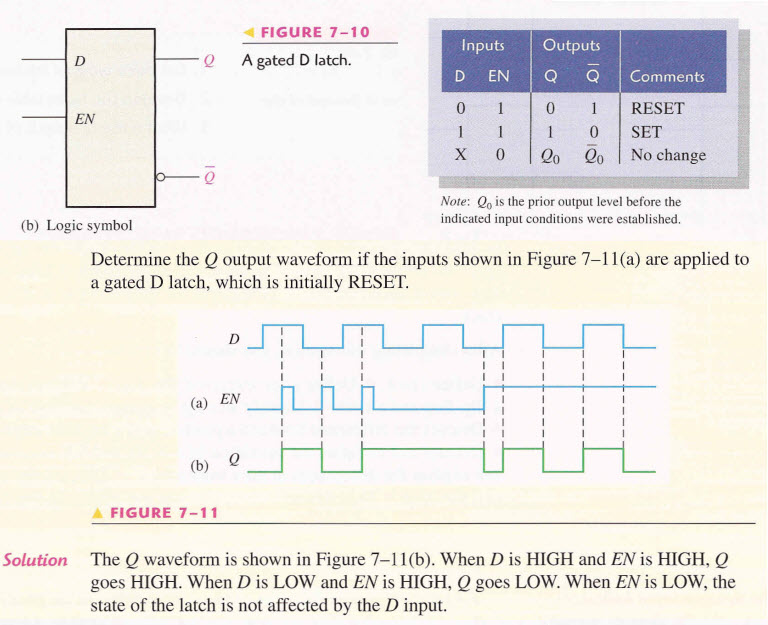

The following is making Verilogger program to crash every time I try to compile it. Could you please help me with it? I believe there is some serious error in the stimulus code because otherwise the code compiles fine. Thank you.
C:
// gated d-latch
//also check image file
  module D_Latch(Q_out,D_data,En);
  input D_data, En;
  output Q_out;
  reg Q_out;
  always @(En or D_data)  begin
  if (En == 1)  begin
  if (D_data == 0)
  Q_out <= 0;
  else
  Q_out <= 1;  end
  else
  Q_out <= Q_out;
  end
  endmodule
//Stimulus
  module testbench;
  reg D_data; reg En;
  wire Q_out;
  D_latch d_latch1(Q_out,D_data,En);
  initial
  begin
  En <= 1;
  D_data <= 0;
  #20
  D_data <= 1;
  #20
  En <= 0;
  #20 $finish;
  end
  endmodule
I don't see anything wrong with that code. You might want to try making a new project and compile it again, or use some other software like xilinx ISE or Modelsim.
edit: ok I found the problem, you are instantiating a wrong name, you have lower cas L there. Still i would rather use software that tells me where the problem is instead of just crashing.
Thank. It works now.
