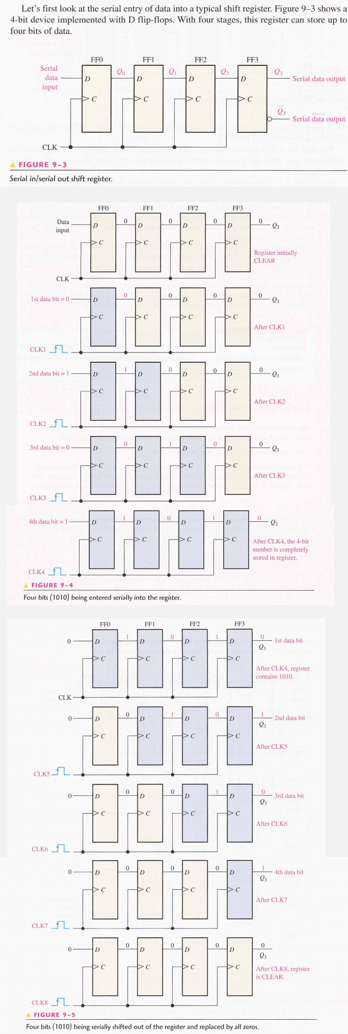

I was trying to write a code for serial in/serial out 4-bit shift register. But I'm getting an error and besides that I also don't really know if the code is logically correct. Please help me with it. Thanks.
Error:
shift111-jpg.86316
C:
module shift_reg_4bit(Q_out,D_data,clk);
  input clk;
  input [3:0]D_data;
  output [3:0]Q_out;
  reg [3:0]Q_out;
  integer i = 0;                                     //line #18
  always @(posedge clk && i<=3)  begin
  Q_out[i] <= D_data[i];
  i = i + 1;
  end
  endmodule
// Stimulus
  module testbench;
  reg clk;
  reg [3:0]D_data;
  wire [3:0]Q_out;
  shift_reg_4bit shiftReg(Q_out,D_data,clk);
  always begin
  clk = 0;
  #5  clk = 1;
  #5;
  end
  initial
  begin
  D_data <= 4'b1111;
  #40 D_data <= 4'b1010;
  #40 D_data <= 4'b0011;
  #40 $finish;
  end
  endmodule
Well, what do YOU think is wrong with line 18? What have you tried to find what the problem is? Remember that verilog is not C.
Another completely different thing is that you cannot synthesize any code that conatins integers, so even if you make it work like this it won´t be good for pretty much anything.
Second thing, look at your shift register and think if that is how a real shift register works.
Have you tried googling example modules? They will really show you how to do things properly.
Also go back to that asic world tutorial on verilog, and read it a few times.
Thank you.
I didn't try google because then I would be learning more from others' work rather than learning from my own mistakes. Yes, I have been using that asic world tutorial and it's very good. Also, as you pointed out that there is also a logical error with the code, it's okay as long as I'm willing to put some effort to correct it because otherwise the internet is full of such codes. Anyway, thanks.
Regards
PG

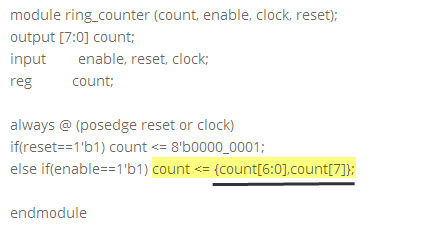

Hi
Could you please tell me what that highlighted statement means? I think this is the first time I'm seeing its use. Thanks.
Regards
PG
PS: Has been solved. Thanks.
