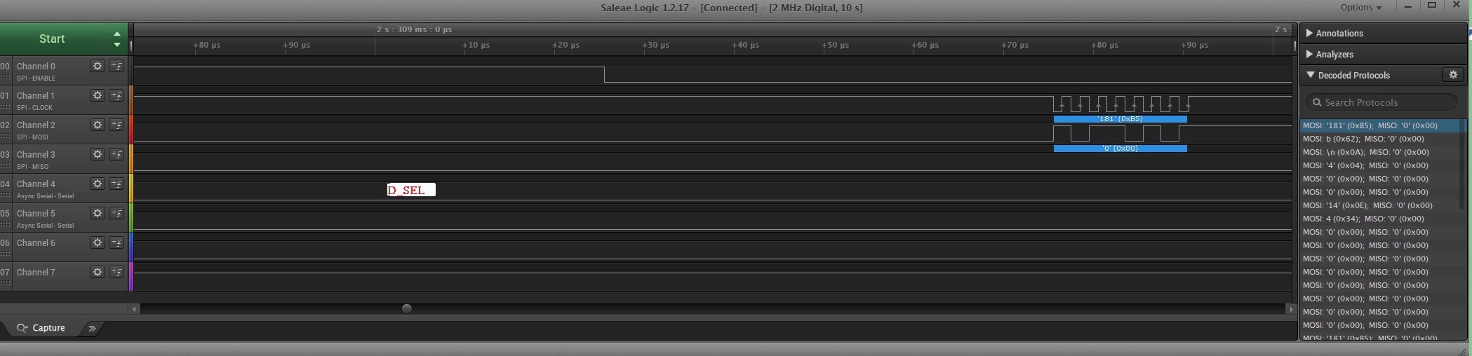

I use the same mthod for the other SPI peripherals, here a result, but no MISO

Looking at your code... Your SPI commands are a bit suspect.
I read the datasheet, It looks like the SPI isn't really the best option for this device.. I think running from RS232 would be better... To use SPI you would need to set up interrupts and read incoming messages as they appear.. Or you would need to poll the ext IO coming from the unit..

Hi I,
I've just been for a walk to clear my head, and it may have worked, if you look at the image, it shows that I send 0x00s when I'm sure I should send 0xFFs. I'll check, and change the CODE, and let you know what happens.
