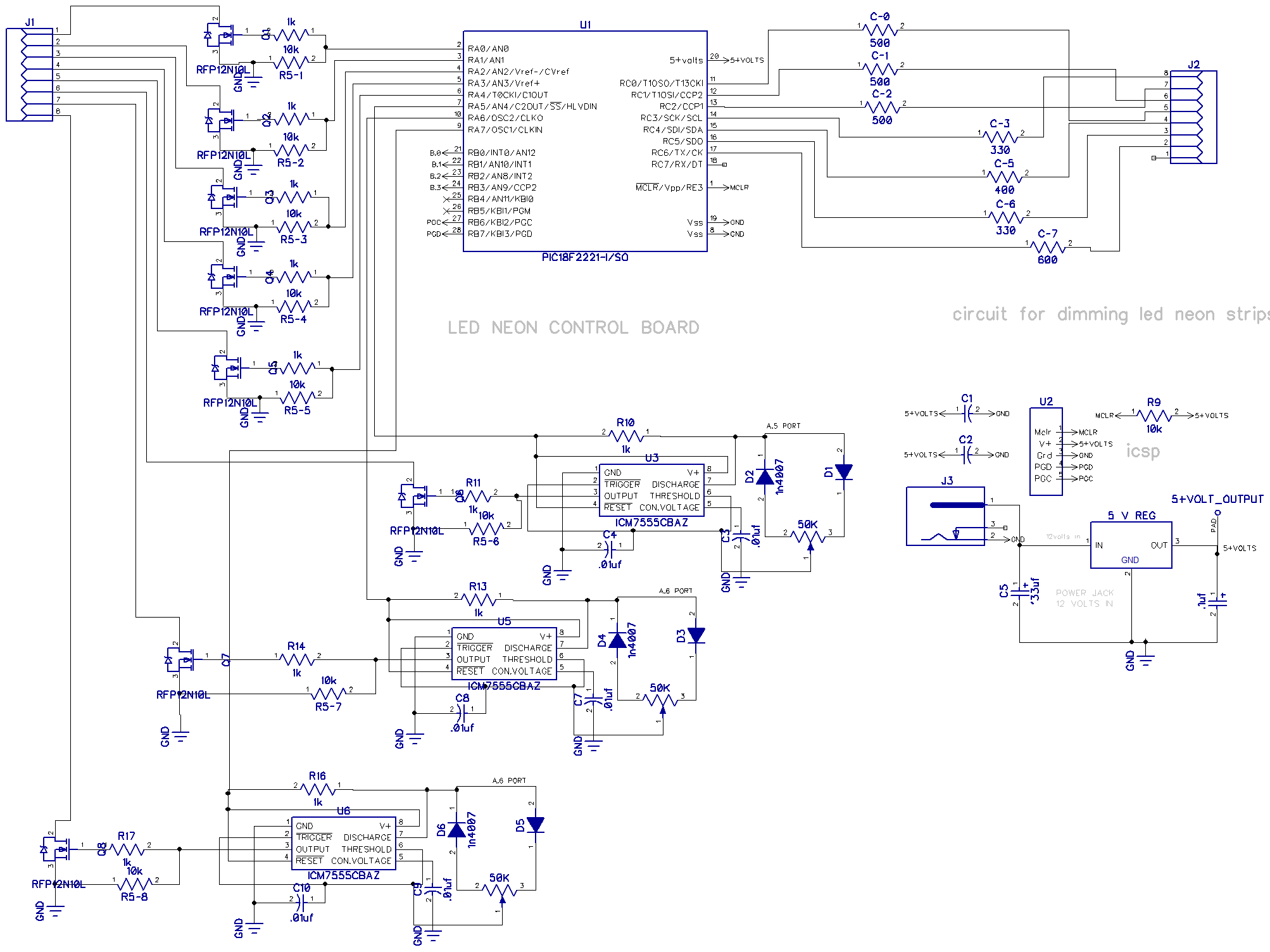

I breadboarded this circuit and it seems to work driving just an LED but I am driving a 12v led neon strip.
The circuit flashes the strip slowly to fast as per pot adjustment.
The 555 circuit works as planned with one LED (it is supposed to change the duty cycle
Thinking the two different supply voltages has something but what to do? Any suggestions?
NOTE THE 7555 IS POWERED BY THE pic
the MOSFET is logic level

well after breadboarding and using a smaller capacitor the circuit works great DUH I wonder why.
I swapped out the caps I soldered on the pcboard and all is fine except I need to use some heat sinks on the MOSFETs that I am using for dimming. They get up to 104 after about minutes

Assuming that the heat is due to the RDSon of the mosfet, a better solution would be to use a better mosfet with lower RDSon value.
You might spend a bit more for the mosfets, but spend zero on heatrsinks and associated costs.
Why did you choose 100 Volt mosfets for a 12 voltage product?
What frequency are you PWM'ing at ?
Also 1K/10K is too high for a relatively quick PWM drive to the gate of the Mosfet, you'll be in the linear region for longer during turn on and the PIC pins should be able to directly drive the gates through a relatively small resistor (<100R) without the need for a pulldown. They are also acting as a potential divider so getting less voltage to drive the gate of the MOSFET.
There's no voltage divider since the pulldown is on the "input" side of the series resistor. If it was on the other side then that would be the case. In general, having a pulldown on the gate is a good idea to prevent the mosfet from turning on as power is turned on/off to the circuit. I'm not too sure about powering the 555 from an IO pin of the uC though. I'd be inclined to connect the +V to 5V, but I haven't looked to see how that effects the circuit.
I think it's a complete silly waste of time, money, and effort to have all those 555's when there's a perfectly good uC sitting there basically doing nothing.
Definitely agree about the size of the series gate resistor, though.

It was suggested to get a logic-level MOSFET
As for unused pins, I wanted some flexibility as to how bright the LED strip is without having to reprogram the pic to set the desired brightness of an LED strip.
I am going to do a more intense search for a better mosfet.
The 7555 smd chips etc are relatively cheap from Tayda Electronics and there are only 3 dimming circuits on the board.

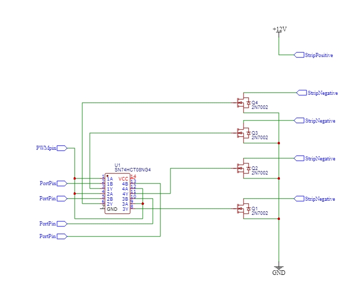

It would be far better to connect the V+ of all of the 555s to a stiff and well-bypassed power rail, with only the RESET pins connected to the PIC's current-limited GPIO pins. This will let you use lower gate series resistances and give the MOSFETs' gates higher drive current. Speeds up the MOSFETs' turn-on time, decreasing power dissipation and die/package temperatures.
If the goal is just to control the overall brightness of all of the strips, all the falderal could be replaced with an AND gate in front of each MOSFET. One of the inputs goes to the controlling port pin. The other input of all of the AND gates goes to a PWM pin. The PWM output controls the brightness of all of the strips. The other input controls whether each strip is on.
A momentary switch could be used to cycle through the brightness levels or a photocell could make it automatic.
thanks for the idea but I want to control each strip's brightness without having to reprogram the pic until desired brightness is achieved.
That's why I included this statement. You could cycle through 8 or 16 levels of brightness, increasing a level each time you press a button, and save the level in EEPROM so that comes back to the same level each time it's turned on.
Note, power and ground connections and a 100nF bypass cap are not shown in the schematic. MOSFET part numbers are representative only and are NOT a recommendation.
