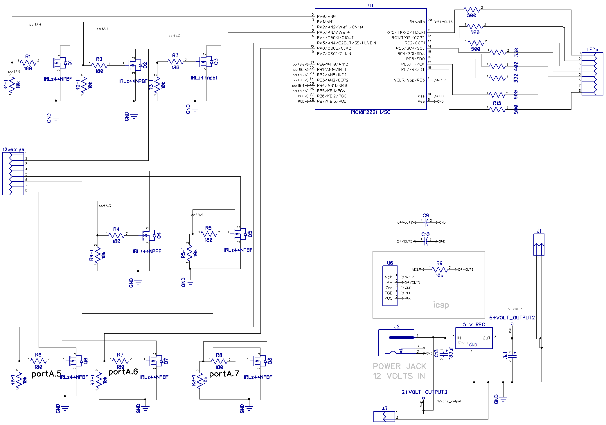

I breadboarded this circuit and it seems to work driving just an LED but I am driving a 12v led neon strip.
The circuit flashes the strip slowly to fast as per pot adjustment.
The 555 circuit works as planned with one LED (it is supposed to change the duty cycle
Thinking the two different supply voltages has something but what to do? Any suggestions?
NOTE THE 7555 IS POWERED BY THE pic
the MOSFET is logic level

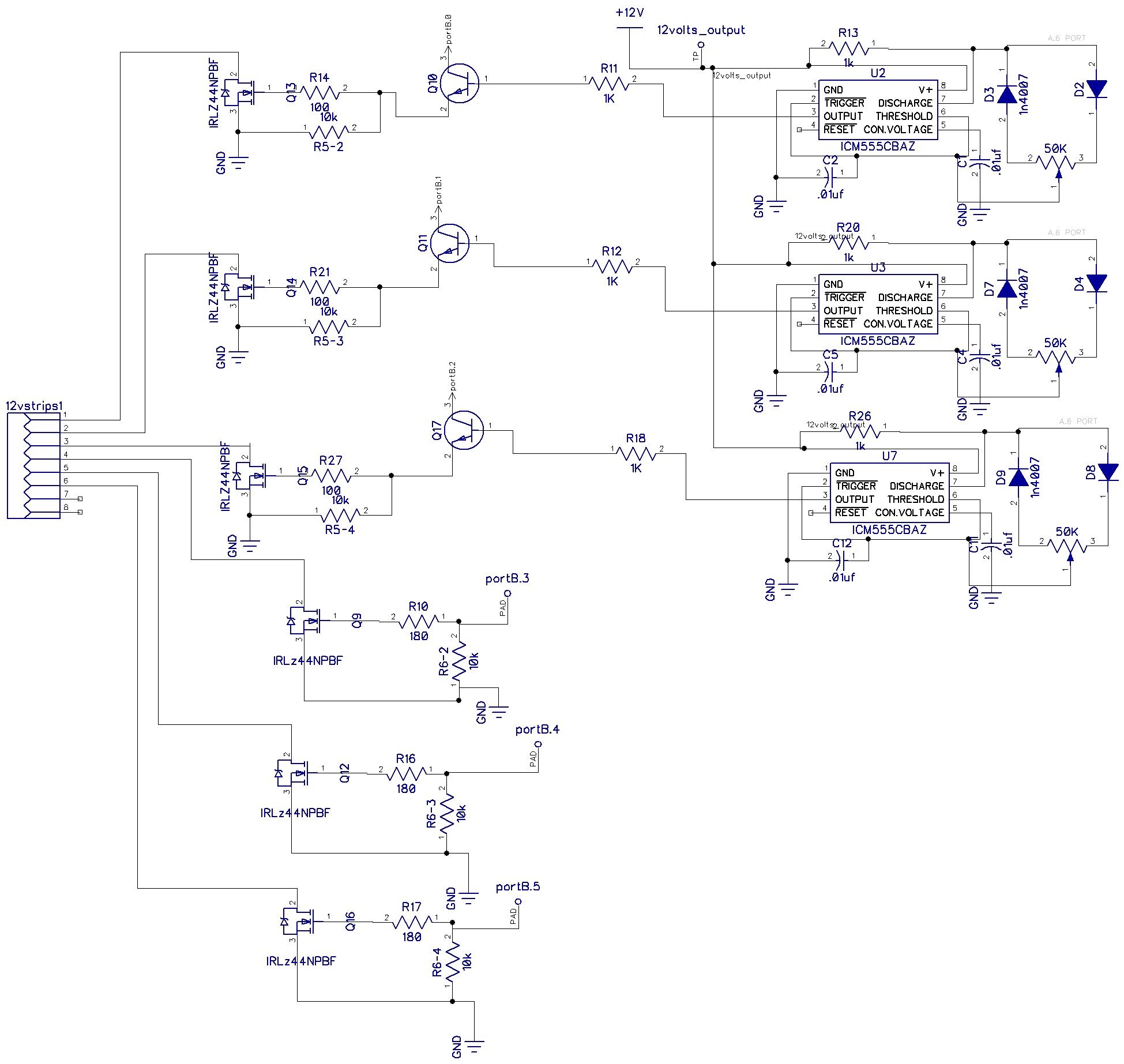

With all the issues with dimming using the pic and the issue with the 555 timer being controlled using pin 4 to the pic (been there, done that and a need for more MOSFET outputs I redesigned the schematic. Maybe add two or three outputs that are just connected to the 12V ground so they are on all the time.
Using an NPN transistor on the 555 outputs, the Neon strips with dimming are enabled via the pic.
Waiting for parts to test the 555/transistor combo.
