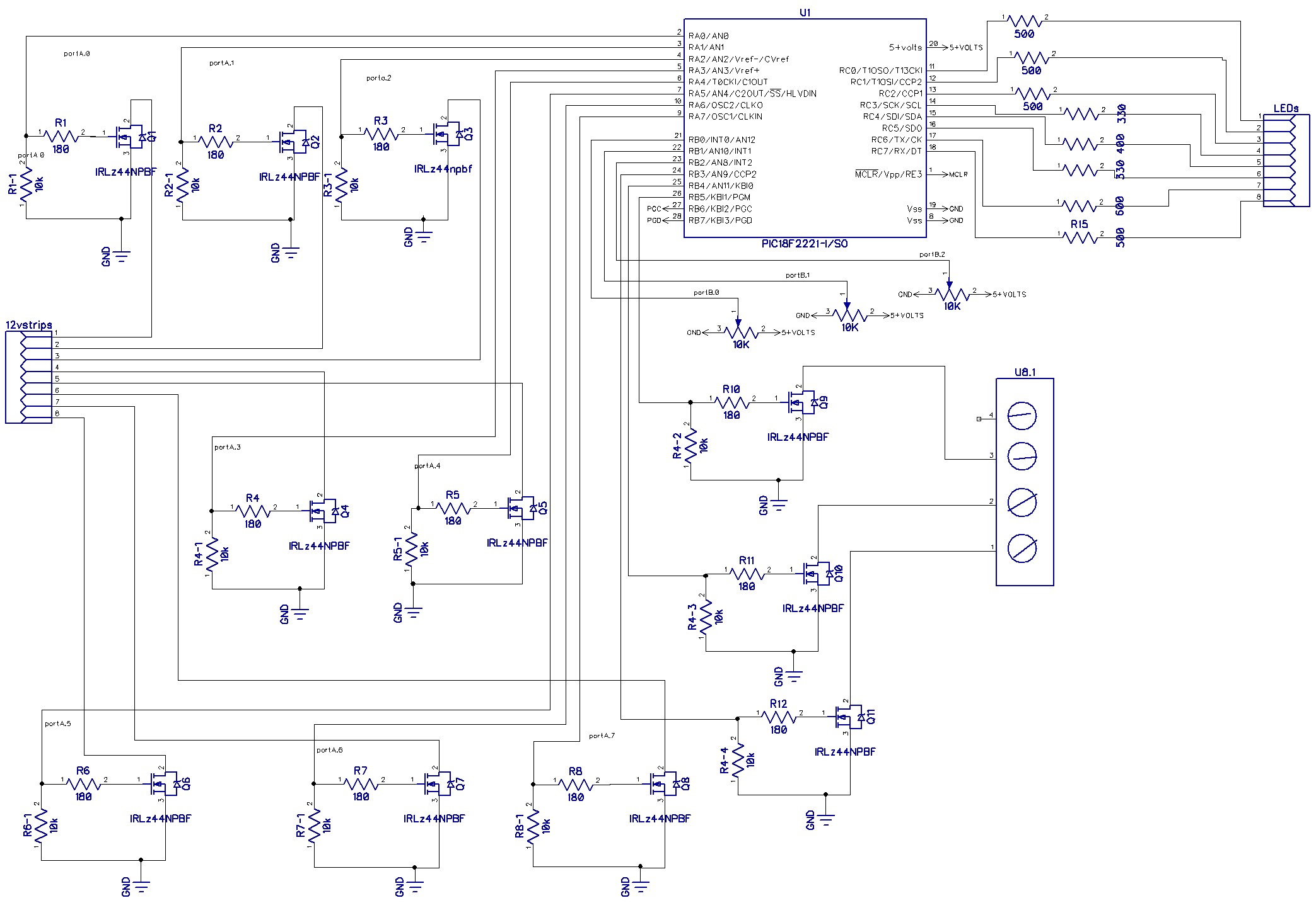

It was suggested to get a logic-level MOSFET
As for unused pins, I wanted some flexibility as to how bright the LED strip is without having to reprogram the pic to set the desired brightness of an LED strip.
I am going to do a more intense search for a better mosfet.
The 7555 smd chips etc are relatively cheap from Tayda Electronics and there are only 3 dimming circuits on the board.
Hopefully today I can attach the sign to the PC board.
If you want adaptive brightness, like that on cellphone screens, you should try a CdS cell and a 500K linear pot across the power supply, with the junction feeding the LEDs common feed. As for all the 555's on board, all could be eliminated by using the internal timer in the PIC.
One question: Are the R5-x resistors part of an array to reduce parts count?
The LED common is the voltage, and there's quite a bit of current there. How would that work?
I know it's hard to follow these multi-page threads, but the latest schematic is in post #112 and all the 555's are gone. MrDEB smartened up and is using the PIC to do the timing. See post #127.

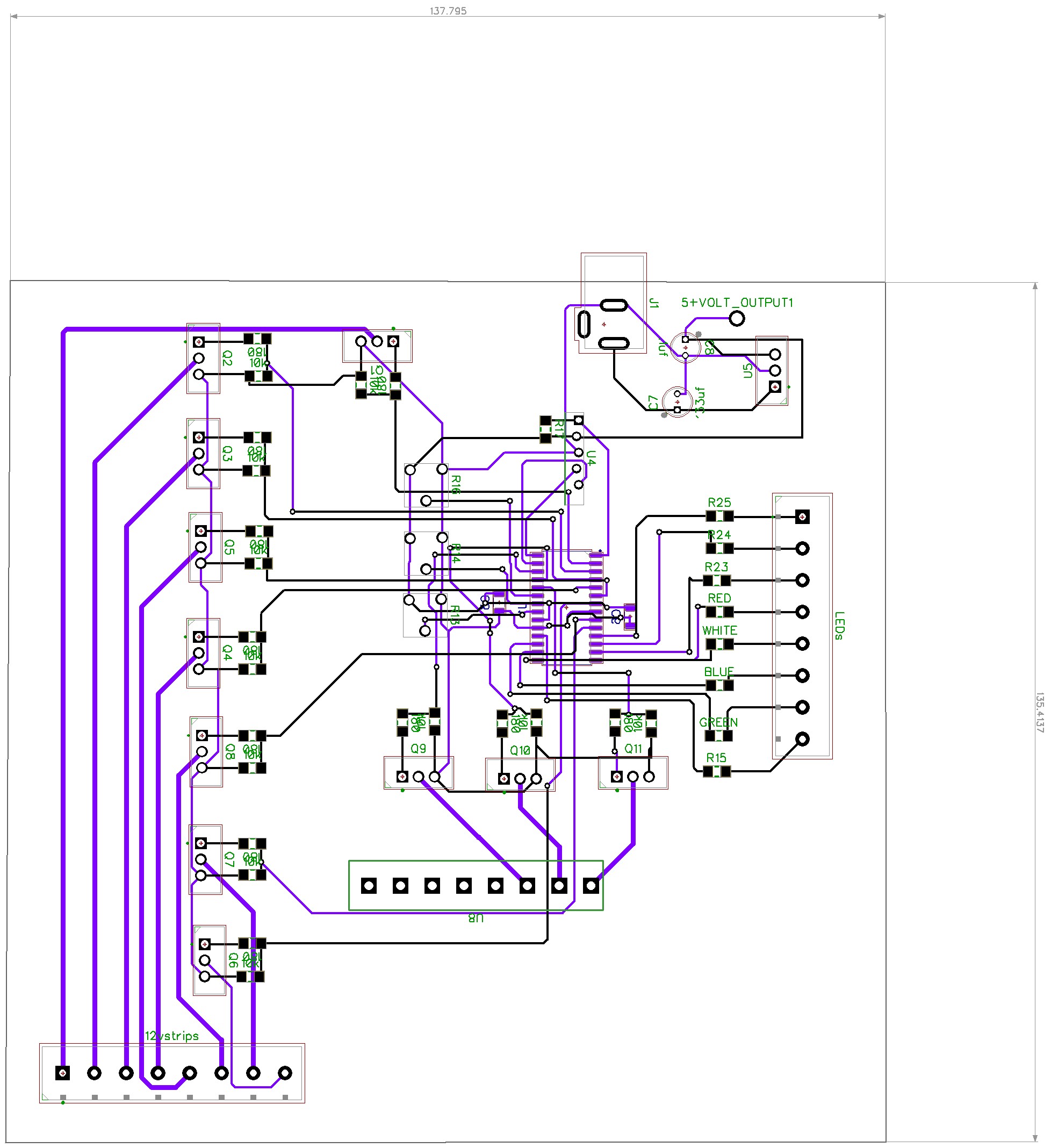

finally got back to this project. Have a schematic and PCboard designed and need to edit the barrier strip for only 3 positions. This is using Tumbleweeds suggestion and go without the 555. Really only need 3 dimmable outports but thinking MAYBE add some more as per post 127
I got to get this project done BUT I discovered an error on my part as I need to sequencly turn leads off and on as well as 5 MOSFETs that do not need dimming. Thinking of MAYBE going back to my schematic as per post #135
here the code that Tumbleweed provided but I add for testing the last 3 lines of code which interfere with the dimming using PWM. am lost at this point. been testing the code for using the 555 timers but need to figure out why it doesn't work either.
