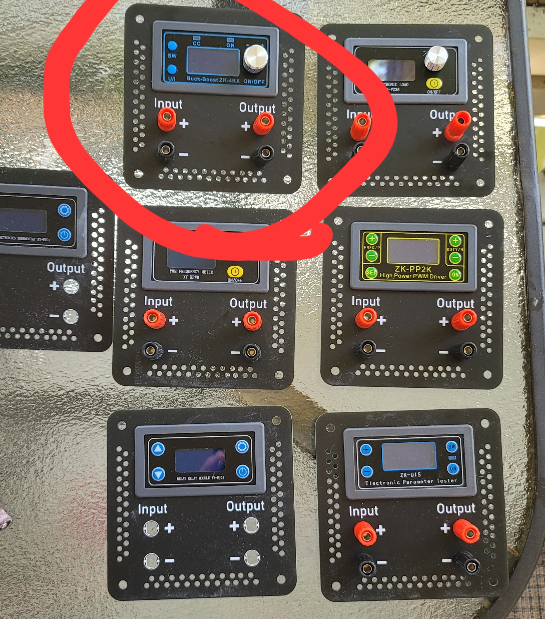

The ZK-4Kx module is a buck-boost power supply, with many features. Connect say a 12VDC power brick to it and you get:
○ 0.5 – 30 VDC constant voltage supply @ up to 35 watts.
○ Display of voltage being supplied with 0.01V resolution
○ Display of current being supplied with milli-amp resolution
○ Settable voltage limits (so you don't inadvertently crank the voltage up to 20 on your 5 volt circuit)
○ Settable current limits and short circuit protection
○ Settable power limits
○ Display of power being drawn and energy being consumed over time (amp-hours and watt-hours)
○ Constant current mode, with features as above
A manual is available here.
If you read any posts other than your own, you might see that I know something about this module. I have been using one of its cousins for years, and recently added this one to my collection.
An ATX supply is not a good option for you with your proclivity of shorting things out. The current supplied by an ATX supply is enough to vaporize components.

MrDEB please understand one detail about this power supply – it CAN supply 4 amps, but its output is LIMITED TO 35 WATTS. With an appropriate power source, you can get 4 amps at 5 volts, a bit less than 3 amps at 12 volts and only about an amp at 30 volts.
