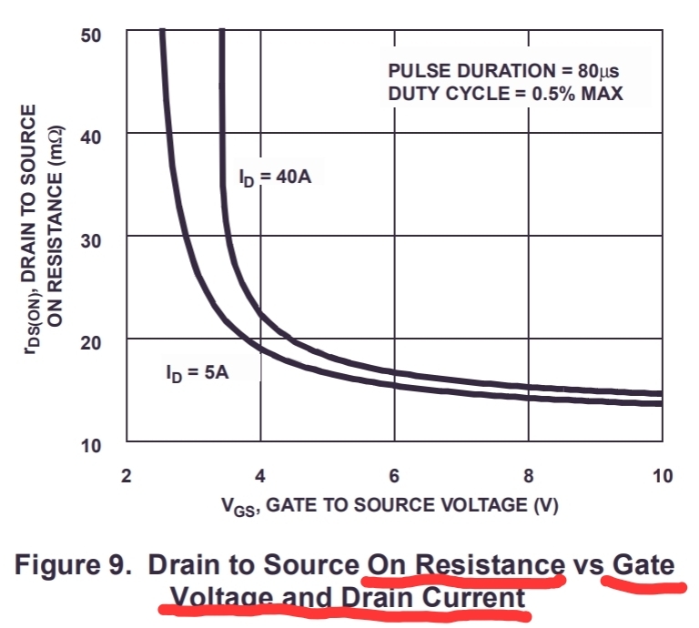

You don't.
IRFZ44NPbf is an N channel MOSFET. When the gate voltage is zero (i.e., grounded) the MOSFET won't conduct. When the gate is at the gate threshold voltage, the MOSFET starts to conduct. But when the gate voltage is near the threshold voltage, the MOSFET isn't fully on, so the drain–source resistance is at its maximum. At the gate voltage gets higher (more positive), the MOSFET is fully on, and Rds is at the minimum.
The graph below shows typical MOSFET behavior and not all datasheets include this graph (the IRFZ44N datasheet does not). At the gate threshold voltage, resistance is high. Above that voltage, it's low, and further increasing it doesn't make much difference.

I don't believe any of your troubles are the result of fake mosfets, rather than inappropriate choices.
Your test results don't make sense but of course I don't know what you actually did. As in the video, you should measure the voltage between gate and source, and calculate the resistance from that. At any rate, as the graph I posted shows, the resistance when the mosfet just turns on will be high, and as the gate voltage is increased beyond the threshold, the resistance will decrease. Past a certain point, the resistance is relatively constant.
That video measures the current incorrectly. He measures it once, with no fet in the circuit, and uses that value for each of the computations that follow.
To get the effective Rds you should measure the drain to source voltage AND current for each of the Vgs settings and compute it from that.

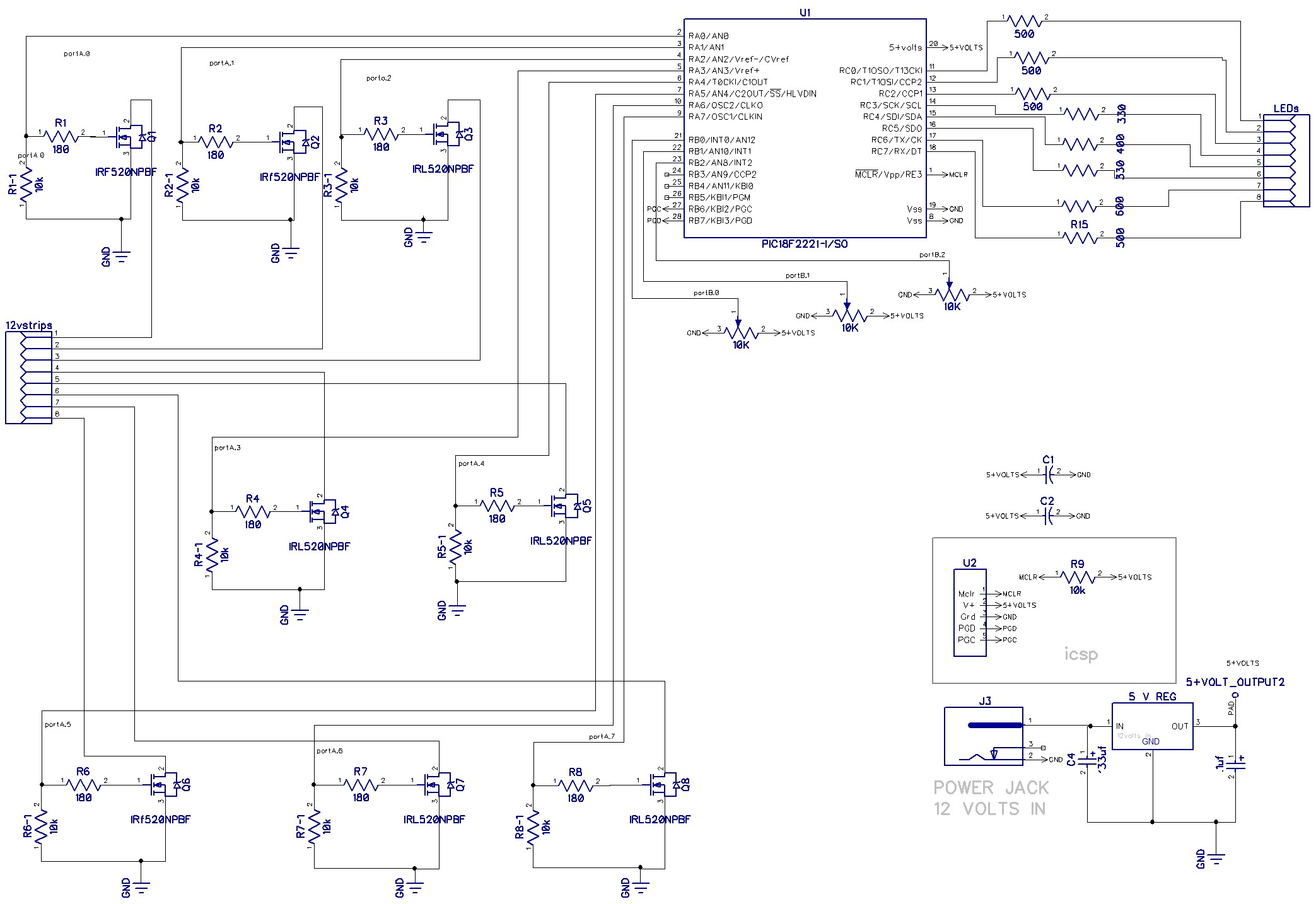

Finally got back to this project. Using Tumbleweeds suggestion of using the pic for PWM (dimming the 12v strips via a mosfet. Here is the schematic I came up with

Your circuit is ok but you'll have to use bit-banged PWM if those are the pins you want to use (on the PIC). Not all pins can be pwm'ed with a pic using the hardware PWM. Look up the datasheet for CCP1, CCP2, ...
Here is the code that I am basically going to use. I tested one port only. Plan to run the code as is then add other ports etc but only have 3 ports with dimming capabilities using the 18f2221 many thanks to Tumbleweed
// Swordfish BASIC three-channel software PWM using TMR2 and ADC inputs Device = 18F4520 Clock = 32 Include "intosc.bas" // do NOT include setdigitalio // to use PORTB for the ADC all pins must be in analog mode due to the way // these old pics map ADC inputs Dim test As PORTE.0 Dim z As Byte Include "adc.bas" Dim x As Byte // ADC pot inputs // used to set the PWM duty cycle for PWM1-PWM3 // connect pot upper lug = VDD, lower lug = GND, wiper = port IO Dim POT1 As PORTB.0, // RB0/AN12 POT2 As PORTB.1, // RB1/AN10 POT3 As PORTB.2 // RB2/AN8 // ADC channels Const CH_POT1 = 12, // AN12 CH_POT2 = 10, // AN10 CH_POT3 = 8 // AN8 // PWM outputs Dim PWM1 As PORTA.0, PWM2 As PORTA.1, PWM3 As PORTA.2 // pwm duty cycles (from ADC) 0=min, 255=max Dim pwm1_duty As Byte, pwm2_duty As Byte, pwm3_duty As Byte Dim pwm_period As Byte // pwm timer TMR2 Dim TMR2IF As PIR1.bits(1), TMR2IE As PIE1.bits(1), TMR2ON As T2CON.bits(2) // set IO pin directions and initial settings Sub InitIO() // set inputs Input(POT1) Input(POT2) Input(POT3) // set outputs (low to start) Low(PWM1) Low(PWM2) Low(PWM3) End Sub // pwm TMR2 interrupt Interrupt tmr2_isr() TMR2IF = 0 pwm_period = pwm_period + 1 If (pwm_period >= pwm1_duty) Then PWM1 = 0 Else PWM1 = 1 EndIf If (pwm_period >= pwm2_duty) Then PWM2 = 1 Else PWM2 = 0 EndIf If (pwm_period >= pwm3_duty) Then PWM3 = 1 Else PWM3 = 0 EndIf End Interrupt main: For z = 0 To 5 test = 1 DelayMS(500) test = 0 DelayMS(500) Next InitIO() // ADC setup ADCON1 = $00 // all pins set to analog mode, VREF = VDD/GND ADCON2 = ADC.FRC // ADC clock = Frc ADC.ADFM = 0 // left justify (we only use the 8 MSB's) ADC.SetAcqTime(100) // 100us delay pwm_period = 0 pwm1_duty = 0 pwm2_duty = 0 pwm3_duty = 0 // setup pwm timer TMR2 // 25KHz = 40us/bit -> 40us x 256 = 10240us period, ~10ms period (100Hz) T2CON = %00000001 // T2OUTPS<3:0>=%000 (1:1), TMR2ON=0, T2CKPS<1:0>=%01 (1:4) PR2 = 176 TMR2 = 0 TMR2IF = 0 TMR2IE = 1 TMR2ON = 1 Enable(tmr2_isr) While (true) pwm1_duty = ADC.Read(CH_POT1) >> 8 pwm2_duty = ADC.Read(CH_POT2) >> 8 pwm3_duty = ADC.Read(CH_POT3) >> 8 End While
You can add more PWMx outputs, but you only have 3 pots to set the duty cycles so you'll have to share them.
