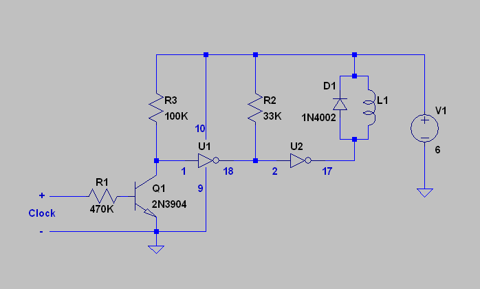

Try this. Use an NPN to amplify the ~1.2V pulse from the clock circuit up to a voltage level which will switch the first ULN2803 input. Since you need a net inversion (output low while clock pulse high), use an extra stage of the ULN2803 as an inverter. The NPN stage inverts, so the net result is the solenoid being driven only when the clock pulse is high (+).
The NPN transistor used this way has a logic threshold of about 0.6V, which is just right for the low voltage pulse out of the clock chip.

The 1N4002 is redundant. Otherwise, I like it.:D
Old habits die hard. There are snubber diodes on all eight channels inside the ULN...

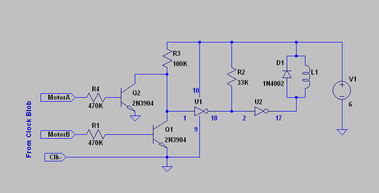

A diode OR gate is going to leave very little voltage to drive the base of an NPN, especially as the battery reaches the end of its life. A 2-transistor NOR would be better, IMHO.
An oscilloscope would do wonders to resolve the question about pulse amplitude. Euphy says his DMM has peak hold, but I wonder what the minimum pulse width is for this function to be accurate. The Fluke 87V (≈US $400) will capture pulses as short as 250uS. To do this, I would think they would need either a precision rectifier, or a relatively fast A/D. I believe that cheap DMMs use a dual-slope A/D, which is very slow. Peak hold could be as simple as holding the highest reading acquired over several conversion cycles. Since the dual slope A/D integrates, it will not accurately capture short pulses.
Here is another hack which implements a NOR gate by using two NPNs (remember RTL?). This should work except that it doesn't address the pulse stretching issue. Try it, and see if your big solenoid twitches. If it does, then all we need to do is lengthen the pulse by adding a circuit.
This would sure be easy if you had an oscilloscope... ;)
That's what I suggested. However, if one transistor didn't twitch the solenoid, neither will two of them.
Ha ha, oscilloscope is on my christmas list obviously! No dice with that circuit either. I've been using a supply voltage of about 4.5v. If I turn it up to 5.3 then the solenoid activates enough to hold the plunger in, but continuously, although I suppose it is possible that it has an off pulse that is too short to make a difference I had been keeping the voltage low while I was experimenting so I didn't blow something up.
