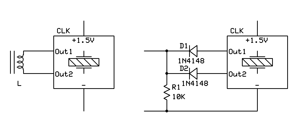

Not sure where you are taking the pulses from on your clock, but if it's like the small modules in the 1.5v battery operated clocks there are two outputs. Each output briefly pulses one end of the clock motor coil, in an alternating fashion at 2 second intervals, but 180 degrees out out of phase (first schematic). You can combine these two pulses with a simple diode-OR circuit, so you have an output of one pulse per second. (second schematic).
This may not be the case for your clock, but it works for the 1.5v ones.
Ken

You are a genius! I wasn't using a clock circuit as such, BUT your idea of using a clock circuit from a wall clock is brilliant!!! This will save me heaps of time (and they are small units). I have several old cheap clocks lying around that I will start stripping :) My circuit runs at 9V so I will just use a resistor to drop the voltage to some the clock circuit can handle (I think they max at about 3v)

This is a little circuit that I used to power the 1.5v clock from a 12v supply. R1, D1/D2 and C1 form a 1.4v shunt regulator. R1 and D3 are just for reverse polarity protection. R1's value is not critical.
As an aside...I wondered how accurate these clocks were compared to the line operated clocks (NIST traceable over long periods of time). Because I never have to reset my battery operated clocks, I was pretty confident, but to check I set up two electronic counters. One driven off the 60Hz line through a divide-by-60 circuit, and the other though my diode-OR circuit from the gutted clock, for two 1-PPS signals, The gutted clock ran slight off, by a few thousand counts over a couple of days. ??? Though I haven't gone back and tested it, I think gutting the clock circuit, removing the motor coil, and cutting away some of the metal frame may have shifted the crystal oscillator circuit frequency by a slight change in capacitance. I need to do this again, but without any change to the clock.
Ken
