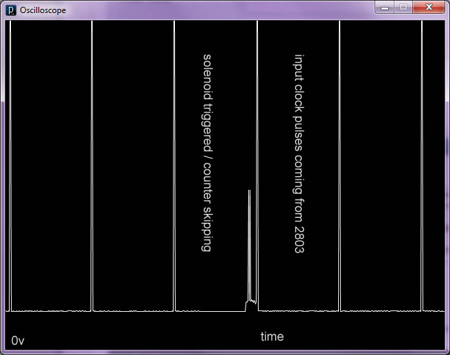

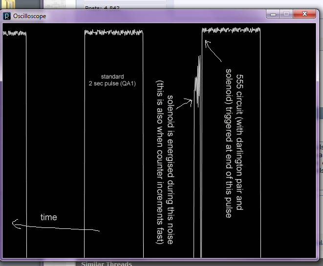

I have rigged my arduino as a little scope, and here is a couple of screen grabs showing the voltage I see going into the clock input pin of my counter, and also the voltage on the QA pin of the first counter (oscilloscope1.jpg). It's right-to-left. Whenever the 555 circuit triggers the solenoid there's another little peak or trough as long as it's on. It's during this pulse that the counter is going crazy. Measuring the supply voltage to the counter shows me that there's a corresponding dip in voltage to about 4v while the solenoid is energised.
Is this a supply conditioning / isolation from the big draw of the solenoid type thing? Hopefully I have explained a little more clearly now. I am getting a clearer picture too, I think. Perhaps the counter is effectively being turned off, and when it comes back on, then it's lost count, or has counted randomly?

LM555 creates a huge current spike on the power supply every time it switches. You should have a 10-100uF cap from vcc to ground on the 555, in parallel with a 100nF. You should also have a 100nF cap from each IC's vcc to ground. These 100nF caps need to have short leads, and be connected as close as possible to the IC's power pins.
The spike from the 555 is probably the cause of your malfunctions.
BTW, your resistor-sharing scheme for the LEDs won't work, because the LED input voltages aren't mutually exclusive. You also can't get much drive current directly from HCT. If you want more than about 5mA, you should use transistor drivers.
Also, the ULN2803 clock buffer is unnecessary, and has marginal logic "0" levels. You can drive the HCT390 clock directly from your NPN collector. The phase doesn't matter.

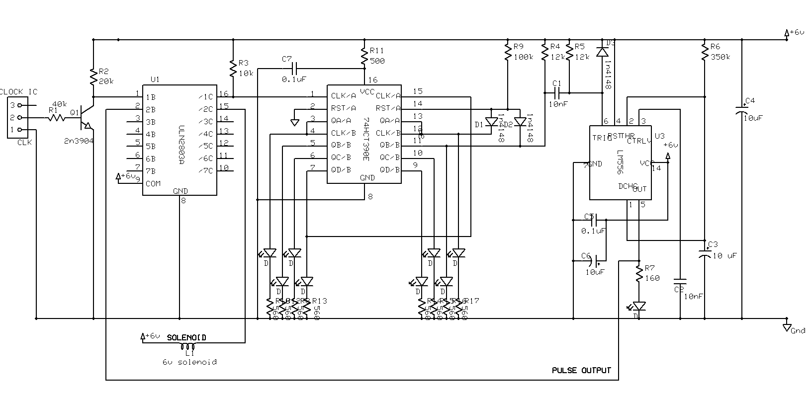

Update your schematic to reflect exactly what you have - including decoupling caps, LEDs, LED current limiting resistors, the AND gate, etc.
Thanks Ron, This is the whole circuit now
That circuit is what I thought would work, and it doesn't. The counters run fine and reset at the right times, but the solenoid never fires. I think I can kind of see why.
If I attach the 555 input to the output of the AND gate, then it runs rather erratic. The QB pin on the counter2 does not light at all - QC lights instead, and the counter resets after QA and QC have lit. The solenoid rarely fires, and if it does, I can't see that it was very related to a particular counter state.
If I disconnect the 555 portion of the circuit from the output of the AND gate, then the counters work as expected, QA lights (10-19), then QB (20-29), and then resets on the 30th tick.
I also tried omitting the 2803 for the first stage, but the counter didn't seem able to catch the low pulses, so it's still there for the time being.
Help much appreciated!!

R11 does not seem like a good idea, as the supply to the LEDs has to come through that. I suggest that you link that out, and I would assume that with it in there the brightness of the LEDs depends heavily on how many are lit.
That could also be compromising the triggering of the 555

Diver, Not sure what you mean by link it [R11] out? - I added R11 in there to reduce the voltage to less than 5.5v (the counter's supply limit), but appreciate that my simplistic solution is probably not the best!
I am also interested in knowing if I've over-complicated the design. I would, eventually like to have this powered by batteries (4x C- or D-cells probably), and am concerned if I'm doing something very wasteful (like keeping the 555 powered up in between pulses - although it's not really doing anything). The solenoid will be pinging every minute.
cheers guys, really appreciated.
By linking it out, I mean replace it with a link. If I had said remove it, that could have implied that I was suggesting removing any feed to the IC.
Using a resistor to reduce the voltage is a very bad way of doing it, because the voltage dropped by the resistor depends on the current through it, and the current through it will vary from practically nothing to quite a lot when several LEDs are on.
If your 6 V is regulated, you could almost certainly get away with a link. The 74HCT390 is rated at 4.5 to 5.5 V, while the 74HC390 is rated at 2 - 6 V. The input voltage levels of the 74HCT390 are supposed to meet TTL levels, and outside the 4.5 to 5.5 V they probably won't, but I don't think that you will damage the IC when the nearly identical one is rated to 6 V.
Or just fit a diode that drops about 0.6 V at whatever current goes through it.
Right, I see your point Diver. It ran on 6.13v (the output of my regulated psu) apparently happily before without bursting into flames, but I haven't tried it again since adding the decoupling caps. I'll root through and see if I can find a diode I can use.
