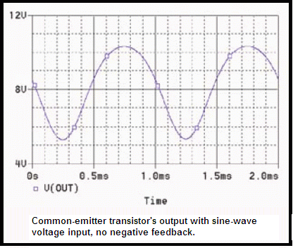

Maybe he wants to feed the 12kHz current source to the base of a transistor amplifier to avoid the high distortion caused by the transistor's transconductance non-linearity when it is fed by a voltage source.
