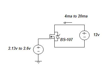

I'm writing this thread because i have a confusion about how to configure
a mosfet to behave like a resistor so i can control the current in a range from 4ma to 20ma.
This is what i understand...
lets say that i have a voltaje source about 12v between drain and source, this is my vds. If i conect another voltaje source on the gate im going to have 0 ids as long as this voltaje is 0. BUT if i increase this voltaje to VT (vgs = VT) and continue increasing from this value(vgs > VT) the current between drain and source will increment too.
Fo this i used a BS107 that says on its "on characteristics" that its
vgs = 2.6v and its ID = 20ma.
So i said to myself that if for a vgs = 2.6v im going to have a current of 20ma i only need to find the vgs to have a current of 4ma. so i proceed this way.
ID = K(vgs - VT)^2
with
ID = 20ma
vgs = 2.6v
VT = 1.75
the constan "K" gave me a value of 2.781x10^-2
so with the same formula i looked for a vgs with ID = 4ma
vgs = sqrt(4x10^-3 / 2.7681x10^-2) + 1.75
vgs = 2.13 volts
so for a range of 4ma to 20ma im going to need a range of 2.13v to 2.6v on vgs.
What am i doing wrong ???
im going to post the circuit.
Thanks in advance

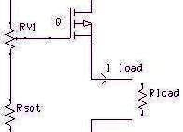

One way to get a controlled current source is by using a PMOSFET.
Choose the value of Rsense and RV1, such that the voltage drop across the Rsense is proportional to the current in the load resistor.
Rough example:
By setting the gate voltage using RV1 to turn on the FET and
say Rsense is 200R and Imax= 20mA then Vdp across Rsense = 4V.
Reducing the gate on gate voltage [wrt the +V] will reduce the current in Rsense until a balance is reached, it could be set for Imin = 4mA, so the Vdp across Rsense = 200R * .004 = 0.8V
The actual resistor values will depend upon which PMOSFET you choose.
This circuit is normally used as a Constant Current generator.
Do you follow OK.?

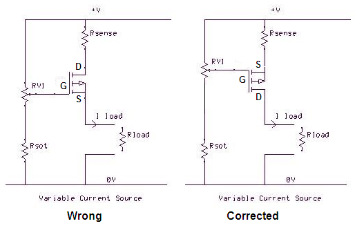

Hi Eric,
Your P-channel Mosfet is drawn upside down. I corrected it.
The schematic is fuzzy because you saved it as a fuzzy JPG file type that has losses instead of as a very clear GIF or PNG file type that has no losses.

The corrected drawing of the current source.

Thank you very much for your reply eric and audio guru.
So let me see if i get this straight.
You're saying that i need to put the mosfet on an "ON" condition by means of the voltaje drop on RSAT and RV1 and make sure that the IDmax = 20ma.
So reducing the voltaje on the gate ( voltaje drop on RSATand RV1), at some point i'm going to have an IDmin = 4ma.
Correct me if im wrong.
Thanks.
Assume you use a PMOS enhancement FET.
When the pot slider is at the top [on the drawing] the FET is not conducting so there is no voltage drop across the Rsense resistor.
If the pot is slowly turned so that the FET starts to conduct then the current thru the sense resistor will create a voltage drop across the Rsense.
This voltage drop will cause the current thru the Rsense and the FET to stablise. By choosing the value of Rsense and FET gate on voltage, values of 4mA thru 20mA can be achieved by adjusting the pot.
The Vsupply must be high enough to allow for the voltage drop across the Rsense, FET and Rload at 20mA.
A PNP transistor can be used in place of the FET.
For a Constant Current source, the gate voltage is derived from a fixed reference voltage. So as the load resistance varies the current in the load remains constant.
What are you using the current source for.?:)

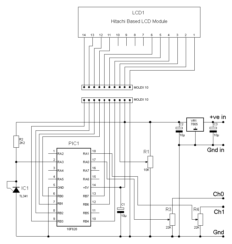

For an example, here if the identical file as GIF (15K) and JPG (79K), it's for a dual channel LCD voltmeter using a 16F819.
