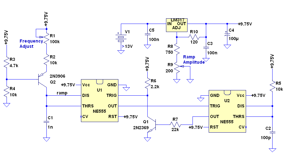

Well, I use Linear Technology's SwitcherCAD III (LTspice), and I think it makes very readable schematics. See below for a sample.

It's primarily a simulator, but can be used just to draw schematics. The learning curve may be a little steep, but probably not too bad unless you also want to use it for simulation.

You can get free updates to LTspice, but I'll bet the version you have already will do what you need. It is a little clunky, but you can save a schematic by simply doing a copy (ctrl-C), or on the toolbar, go to Tools/Copy Bitmap to Clipboard. Then you paste it into MS Paint, manipulate it if you want, then save it as a PNG or GIF.

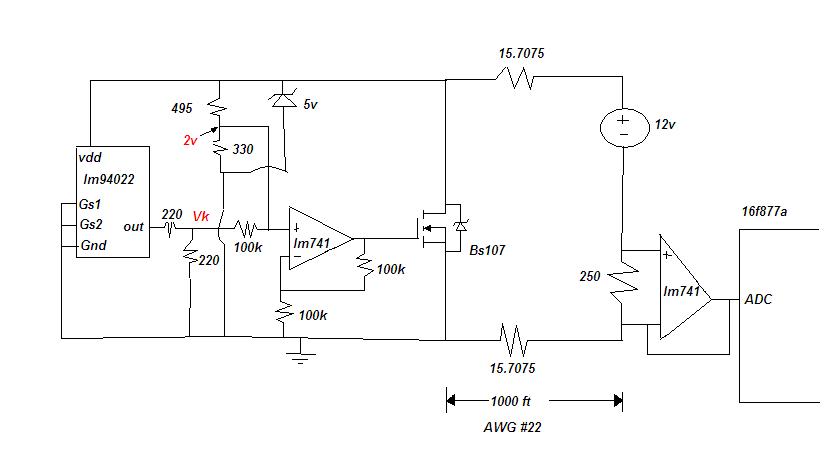

Assume you use a PMOS enhancement FET.
When the pot slider is at the top [on the drawing] the FET is not conducting so there is no voltage drop across the Rsense resistor.
If the pot is slowly turned so that the FET starts to conduct then the current thru the sense resistor will create a voltage drop across the Rsense.
This voltage drop will cause the current thru the Rsense and the FET to stablise. By choosing the value of Rsense and FET gate on voltage, values of 4mA thru 20mA can be achieved by adjusting the pot.
The Vsupply must be high enough to allow for the voltage drop across the Rsense, FET and Rload at 20mA.
A PNP transistor can be used in place of the FET.
For a Constant Current source, the gate voltage is derived from a fixed reference voltage. So as the load resistance varies the current in the load remains constant.

Well to tell you the truth. im using the mosfet stuff because i was told that i needed to design a system for temperature sensor at a distance of 1000 feet using the LM94022, using its whole range (-50C to 150C).
So i was sure i was doing it all right because....
this sensor when you have its pins (GS1, GS0 = 0) its output will be on a range of voltaje from 1.299v (for -50C) to 0.183v (for 150C) i know because theres a table in the datasheet that says so and i confirm it using a formula that the datasheet have.
so the voltajes for the gate that i calculated were...
vgs = 2.13 for 4ma and vgs = 2.6 for 4ma as i told you earlier, so i assumed that i needed to fix the span from the output of the sensor to the input of the mosfet.
So i used a voltaje divisor with 220 resistors at the output of the sensor and an opamp as a voltaje adder with a 2v ref so for example...
if the temperature were at -50C
Vk = 1.299/2 = 0.6495v
0.6495v + 2v = 2.6495
with this ID = 4ma aproximately
and if the temperature were at 150C
Vk = 0.183/2 = 0.0915v
0.0915v + 2v = 2.0915
with this ID = 20ma aproximately
so i guess that i could control the range of the temperature of the sensor if i had a control with the range of 4ma to 20ma and then sense that and convert it with a ADC of a 16F877A for example.
Ill put a diagram of the design.
so you can understand what im talking about.

A lousy old 741 opamp won't work when its supply voltage is only 5V.
Its inputs won't work when they are within about 3V from a power supply voltage so the 2V input is too close to 0V and it will be dead. The other input also might be dead.
Each Mosfet is different and the circuit must be calibrated for each one, or negative feedback can make them operate almost the same.

Is there any reason you cant use a standard 4 to 20mA driver ic.?
With sensor output from the
https://www.electro-tech-online.com/custompdfs/2008/06/LM94022.pdf
Is it the 1000ft cable run thats the problem.?
Dont use the 741, as stated, its not up to the job.
Look at the CA3140 OPA or similar, it will go close to zero with a light load, also allow a 3V overhead
above the maximum output swing required, on the +V power rail.
