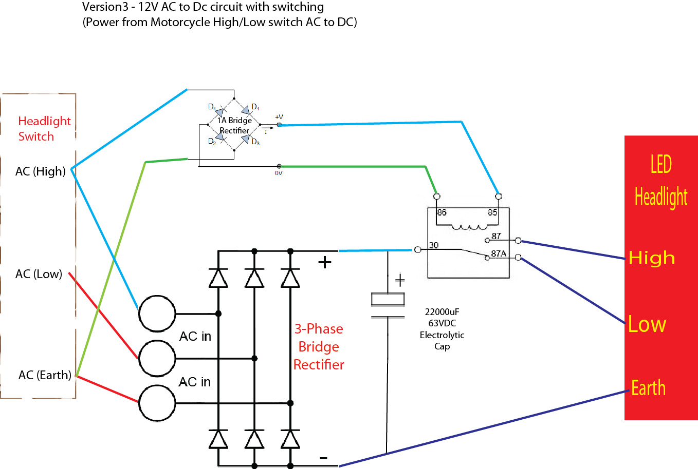

I'm trying to convert a 12VAC circuit to 12VDC, but the trick is, it has to output High and Low on an LED Headlight using the original switch. I'm trying to build a 'plug and play' unit to replace the current weak AC Globe. The LED draws from 1.5 to 4 amps depending on which one I use.
I've drawn a rough circuit of what I'm thinking but not sure about the eatrh/AC side? Note there are two bridge rectifiers, one is to convert the higher current for the light, the other just converts a couple of hundred milliamps to switch the relay.
Thoughts? Am I on the right track or miles off?

You are on the right lines, but you need two changes.
1) the negative of the little bridge that feeds the relay must only connect to pin 86 of the relay. It must not connect to the negative of the main rectifier.
2) You need two more 6A diodes, or another rectifier. One diode has to have its anode connected to AC (High) and its cathode connected to the +ve of the capacitor. The other diode has to have its cathode connected to AC (High) and its anode connected to the -ve of the capacitor. If you use a rectifier, connect its AC connections to AC (High) and AC (Earth) and its +ve and -ve connections to the capacitor.
If you make those changes, I think it will work.
Item 1 is needed when low beam is on to prevent the relay being energised through the AC (Low) connection when that is negative compared to AC (Earth).
Item 2 is needed when high beam is on to give a path for the +ve and -ve high currents to the capacitor from AC (High)

I've drawn out the circuit that I described.
You can get three-phase rectifiers like this:-https://uk.farnell.com/multicomp/sbr2506/diode-bridge-rect-3-ph-25a-600v/dp/2750988
A three-phase rectifier has three ac inputs, an you would simply connect those to AC(High), AC(Low) and AC(Earth). The + and - outputs of the rectifier would go to the capacitor. That would give the circuit exactly as I have drawn it.
If you use two single-phase rectifiers, you can connect AC(High) and AC(Earth) to the ac inputs of one, and AC(Low) and AC(Earth) to the ac inputs of the other. The + and - outputs of both are connected together and to the capacitor.

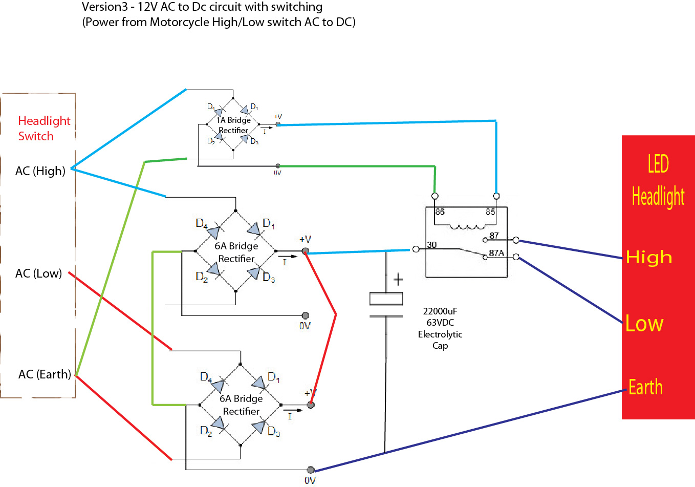

I drew this for the 3 single wave rectifiers from your diagram and instructions. Does it look right?
I'll draw up the 3 phase one as wellView attachment 139093.
That is correct.
However, if you connect the second ac input of the second 6A bridge to AC(Earth), it will halve the current in the D2 and D3 of the first 6A bridge, so it may keep the rectifiers cooler.

Using two single-phase rectifiers is often easier than using separate diodes because they are easier to mount. Also single-phase rectifiers are very cheap. I have used bridge rectifiers where only two diodes are needed for both those reasons on separate occasions in the past.
