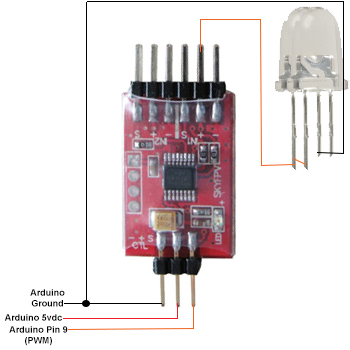

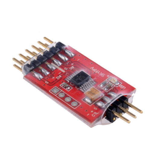

Hey all I am wondering how to go about switch from camera 1, 2 or 3 using this 3 Channel Video Switcher Module on ebay **broken link removed**.
Since there's only V+, V- and signal for the "switch" it looks to take a PWM but I am not quite sure if that's correct or not. If correct then how would I (in code) send that out for each camera to change?

and just to test it I hooked up 2 green LEDs to digital pin 9 and I can confirm it does light the led's in 3 stages. From bright, medium and then dim-ish.
So I went ahead and powered up the FPV by hooking it up like so:
I'm not getting any voltage off that pin on the FPV. I even hooked up a volt meter and tested it without the LEDs attached to that pin and still had no reading.
Someone suggested looking at this post https://www.rcgroups.com/forums/showthread.php?t=1955631 but there so much code that I'm not sure what i need and what i don't need.
What could I be doing incorrectly?
This is a FPV camera switcher.
It is looking for the servo output of a radio controlled receiver.
Some of them need to be calibrated.
You will fine much more info if you look at "FPV camera switcher"
Alright I got it.
Using the #include <Servo.h> Servo library I was able to get the following values confirmed that switched the video input:
cam1 = 0-64 and also 153-180
cam2 = 65-123
cam3 = 124-152
The arduino code looks like this:
