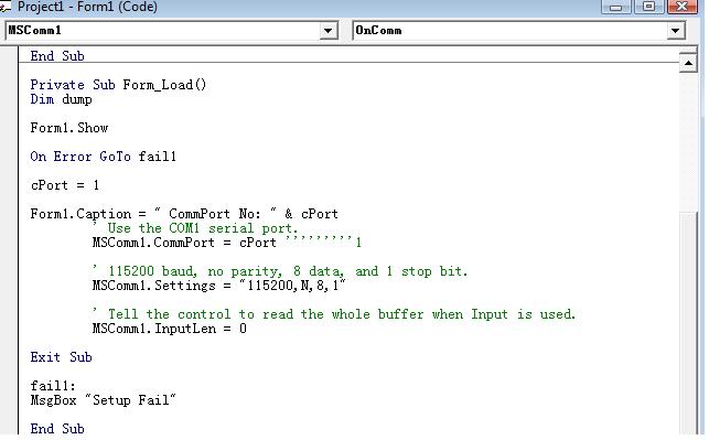

The factory default is 115,200 baud, so change the VB program to '115200,n,8,1'
Then check that you have a good connection using the $$$ and get the CMD reply...

Actually I did, but after I get the CMD reply, i can't sent any data.
For baud rate, just change 2 things as the pic below right??

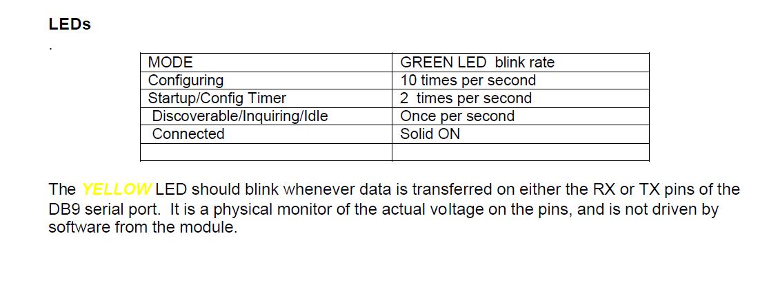

And I feel that there are no data transfer because I found that in the document, it say when the data transfer, the Yellow LED should blind.May i correct??
Thanks for you help, and sorry for make you trouble.......
Is the GREEN LED lit when you are connected.???
yup......
when I press port open......
The green Led is lit.
Then i press sent $$$
Green LED is still On and the RED LED is Blind
yup......

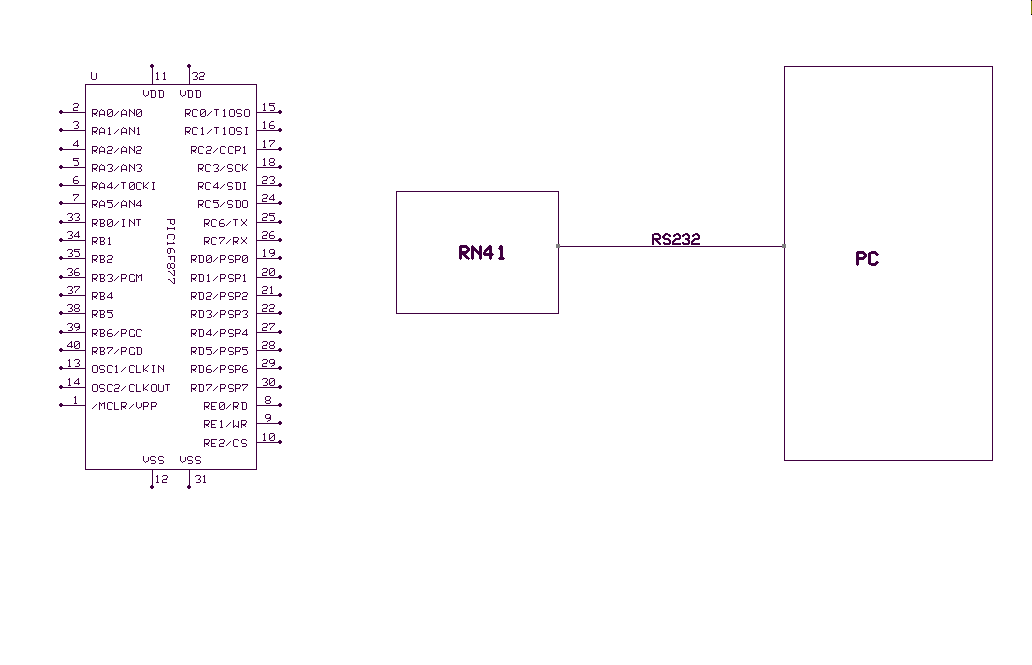

Look at this diagram, how do you expect the PIC to get the data from the RN41 thats connected to the PC.???:)
Please draw on this diagram and post it to the thread.

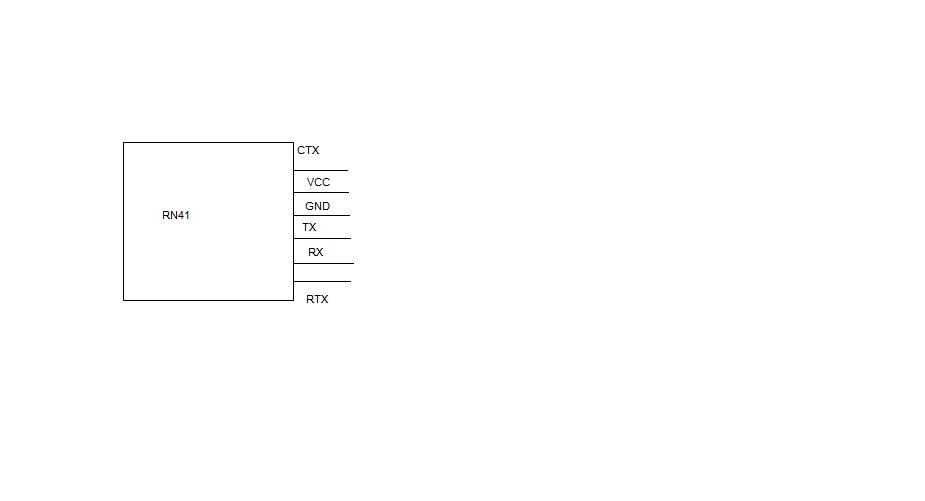

Sorry, i dun know I can't save your pic, so I make a simple one.

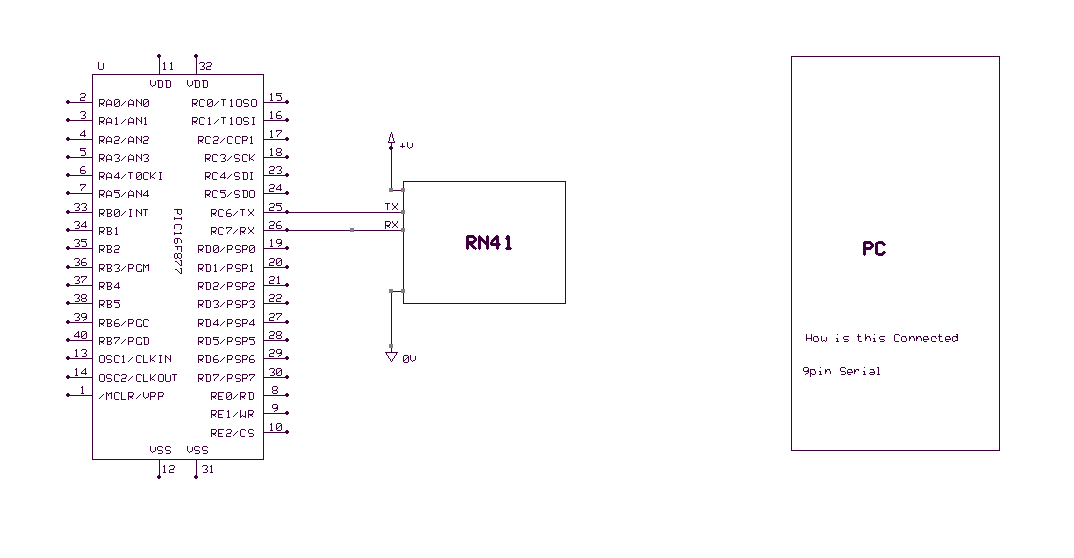

Since there are 6pin on the RN41
So i connect VCC and GND to the power supply.
TX connected to the RC6 pin (pin 25) since this pin is also TX pin
Same as TX, RX connected to the RC7 pin (pin 26) since this pin is also RX pin
Summary
TX ===>> TX (pin25 RC6)
RX ===>> RX (pin26 RC7)
VCC ===>> 3.3V power supply
GND ===>> Gound
Is it correct??
And when the RN41 received signal from PC, It will straigh away trasfer the data to PIC by RX pin right??
ok,
Is this how you have it connected.??
In your simple drawings show how the wires are connected.
EDIT:
Are you confusing CTS and RTS as CTX and RTX.?????????

yaya......i wrote wrong.
no, i din use serial connect. Since it is a bluetooth device, so i din connect it with PC.It just communication with PC by wireless
That means the PC must have a Bluetooth/RN41 module already connected.???
Yup.......my laptop have bluetooth..............
Why have you been asking for USART/RS232 VB Communication with a RN41, when you already have a laptop with Bluetooth.????
You should be testing the PIC with its RN41, so that it can communicate with your laptop.
but i need to control the PIC (sent signal to PIC) by my laptop o.........
so first things, i need to connect the PC with the RN41 first right??
Then the RN41 is just connect the pin to PIC right??
Am I wrong??
