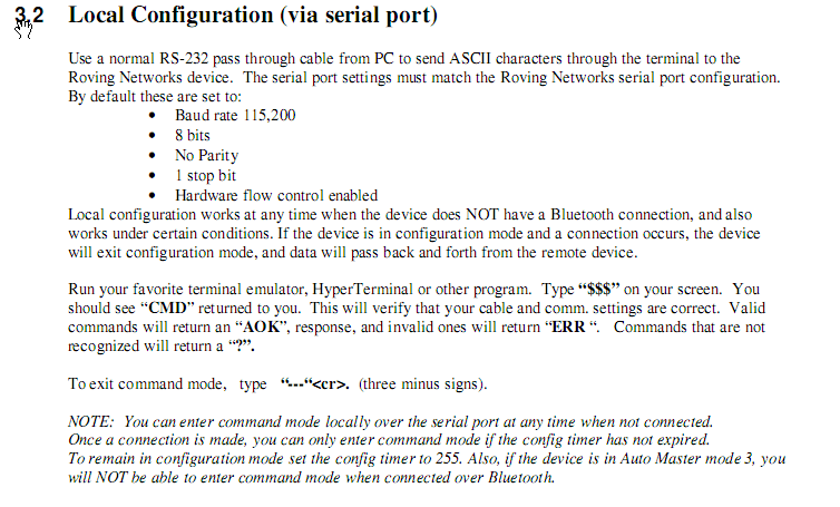

Confirmation Check.
When you send from the PC to the RN41 the string "$$$" you should get the "CMD" response [ which I understand you do]
If you get the "CMD" this means that the PC to RN41 is OK.
You then send any other COMMANDS you need to make to the RN41, after each COMMAND sent you should get the "AOK" reply. [ else "ERR" if a problem]
To EXIT COMMAND mode send "---" & vbcrlf
Remember you have only 60 seconds before the COMMAND mode times out.

When you first switch ON, send the $$$ to the RN41, it should reply with CMD, which means that it is the Command mode and is receiving the PC commands OK.
If you do not want to write commands to the RN41, send --- & vbcrlf, that will set the RN41 into data transfer mode, send the 'K'.

When the RN41 is in COMMAND mode, you would send from the PC to the RN41 any set up commands, example, if you wanted to change the Baud rate.
To EXIT the COMMAND mode you send --- & vbcrlf, after you have done that you are data transfer mode, send the K or any other data you need to send.

Do you understand that the Factory defaults are 115,200 Baud and that the PC should be set to the same Baud rate.
I see that the PIC end RN41 is set for 115,200Baud, change the VB program to the same settings.
Read this image.
