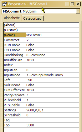

Attach your VB program so that we can check the MSCOMM settings.

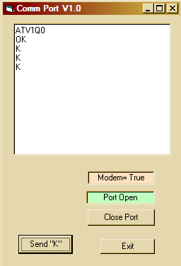

Look at this version of your program.
I have used the binary option for the MsComm1 as you may also want to send control codes to the modem.
The program has been tested by being linked to another PC acting as a modem and it works OK.
I have set the Comport as #2, set it back to #1 for your project.
If you have any questions, please ask...:)

Sorry, i have a problem when i run the program you give me. The problem is when i run it, it will say method or data member nhot found for ".SelText"
May i know what i should i change it??

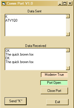

I changed the simple Text box into a Rich Text box, so that print out could be formatted 'better'.
Use the VB menu, Projects/Components and Add the Microsoft Rich Text box control...OK.?
If you cannot do that, use a simple text box and change all the rtb1.selxxx commands to Text1.xxxx, I would recommend the RTBox use.
Have changed the boxes to simple Text.
Its been tested linked to another PC and it works.
Use the modcomm2.vbp within the zip.

If you want to 'talk' to a modem, you must have two way communication between the modem and the MCU or PC.
When then MCU initially sends the "AT" command to the Modem, it will expect "OK" as a reply.
Usually the MCU then sends 'setup' commands to the modem an awaits the required reply.
After the modem is setup data can be transferred between the MCU and modem and vice versa.
The VB program transmit data string is fixed in the program I posted, but it could easily be edited to enable it to transmit data and commands from the keyboard.
Exactly what are you trying to do.???
