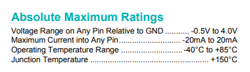

Does that mean that you are operating this thing at -127DegC ??
The DS2485 datasheet clearly states:
If my understanding is correct, you may be running this thing a little bit too cold.
No Jim I got the wrong value on one wire. value is -127 because there is some calculation to convert data to proper formate . when I try to receive data I got the wrong data and the calculation also goes wrong.
