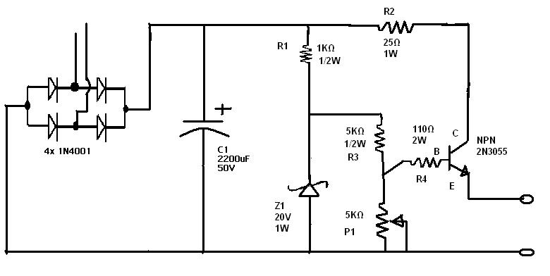

Can some one please check whether this power supply is correctly made up or not...
picture below
ps-jpg.14972
1.the rectifier are 4 diodes rated at 1Amp each, but i also have rectifier IC rated at 4Amps
2.the C1 charges up to max.72% thats 36volts
3. i am uncertain about the transistor.. i know the biasing is ok... but i actually need some current of more than 1Amp, so i set the collector current at 1.4Amps... would i get then would this power supply handle upto atleast 1.25Amps....
its sort of a project that i have to make, 0~12V regulated variable Power supply rated between 1amp to 3amp.
so plz.... help me and check (do all the necessary calculations) and tell me whether i should proceed to solder it all on a Vero board or not... or can some one suggest something else.. or better .... and i am not allowed to use more than 1 voltage regulator IC, so if u are suggesting me to use that then plz tell where and how will i supply the IC with negative voltage to make its rage from 0 to 12volts...
i have got LM350, LM317 and LM7805
plz help me as soon as u can....

I would recommend that you do not make this circuit.
There are many design flaws.
A LM317 will be able to supply 1amp, a heatsink maybe required depending upon the input voltage to the regulator,
giving a +12V output, variable down to about +1.5V
Does this help?
EDIT: added gif with numbers,,, the calculations do not make sense!:eek:
Sorry but this is an awfull circuit - dont build it!
Let us assume a specification of 0 to 12v, 1 amp max.
The circuit as drawn will only ever give a maximum of about 9.2 volts
zener (voltage 20 volts), divided by 2 (the two 5k resistors), minus the Vbe of the transistor (about 0.6 to 0.8 volts) = 9.2 volts.
If you try to take 1 amp from this circuit, the 25ohm 1 Watt resistor will drop 25 volts, and get very hot (W= VxI) it will dissipate 25 watts for a short while until it bursts into flames.
The output voltage will be variable, you can adjust it with the 5k variable resistor, but no way could it be described as regulated.
As you take current from the output, base current will flow in the transistor and the voltdrop through R3 and R4 will increase, the voltage at the base of the transistor will drop and so will the output voltage.
There is no feedback to give any regulation.
This circuit has NOTHING to commend it.

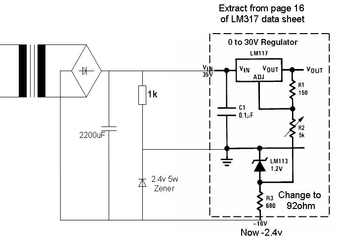

If you have an LM317, look here
download the datasheet and look at page 16 for a regulator circuit which can turn down to zero.

plz help me by giving some diagrams.... that LM350 page 16 circuit needs a -10volts... where do i get it a minus 10v... told u i'm allowed only to use one IC.

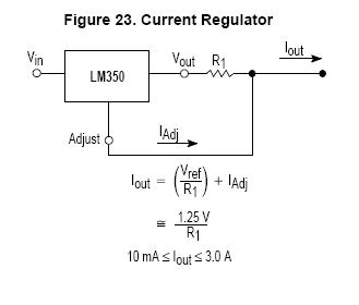

Try this circuit which I have attached.
PS Now that I have done your homework for you, please consider spending a little time to using correct English words instead text speak, you have a full size keyboard. plz uz it:eek:

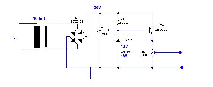

third tell me if this circuit is any good...
and if yes... can u make it bear 1A atleast, say again using 2n3055...
and please be simple... dont give LM113

Your last attachment is not good. You cannot get much power through the 10k variable resistor.
In your last circuit:
1) Without a load, the power dissipation in the 200 ohm resistor is 2.7W and the power dissipation in the 13V zener is 1.5W and they will smoke and burn.
2) If the pot is set to maximum and the 2N3055 transistor has a typical current gain of 35 at 4A and a 4A load is applied, the output voltage is typically 11.5V and the power dissipation in the 2N3055 transistor is 94W and it will smoke and burn.
3) If the pot is set to half and a 2.5k ohm resistor is connected to the output then the voltage will be only 3.25V instead of half which is 6.5V. The voltage regulation is horrible and the load current is only 1.3mA.
Look in Google and you will have links to the datasheets for the LM311 comparator and the LM113 voltage reference.
EDIT: The transistor is a dinky little 2N3053. When the pot is set to max and there is a 50mA load then the transistor will smoke and burn.
burhanmz said:
what can i use in place of a 5Watt 2.4V zener diode,
You could try using four 1amp diodes in series. The zener is there to generate some -ve voltage from the main supply.
burhanmz said:
second that LM113 isn't available as well.
The LM113 is a voltage reference diode to generate a stable -ve reference from the -ve supply. You could try using two small signal silicon diodes (1N4148) in series.
This will not be as good as a proper reference diode but will work.

what is a reference diode. is there anything special about a reference diode like the one JimB mentioned above LM113...
how is it different from a normal working of diode...
JimB please add these two diagrams correctly...
1.can u change R1 to a variable resistance in 'current.jpg' so as to increase or decrease the current output.

An ordinary diode changes its forward voltage when the temperature changes and when its current changes.
An LM113 voltage reference IC doesn't.
Digikey has some. They are very expensive.
Why? To achieve what?
One is a variable voltage supply, the other is a constant current generator.
Yes
burhanmz said:
2. [alternate] u said to use a zener diode of 2.4v in series with 4, 1A diodes, or just 4 diodes.
The meaning was:
"if you dont have a 2.4v zener, you could use 4off 1A diodes connected in series, instead of the zener"
burhanmz said:
3. the 1k:eek:hm: resistor needs to be atleast 2watt rated, right.
Yes
burhanmz said:
4.what if i still can't find LM113..or LM313... something else i can use
You could use 4 off 1amp diodes is series, but it wont work as well as an LM113.
