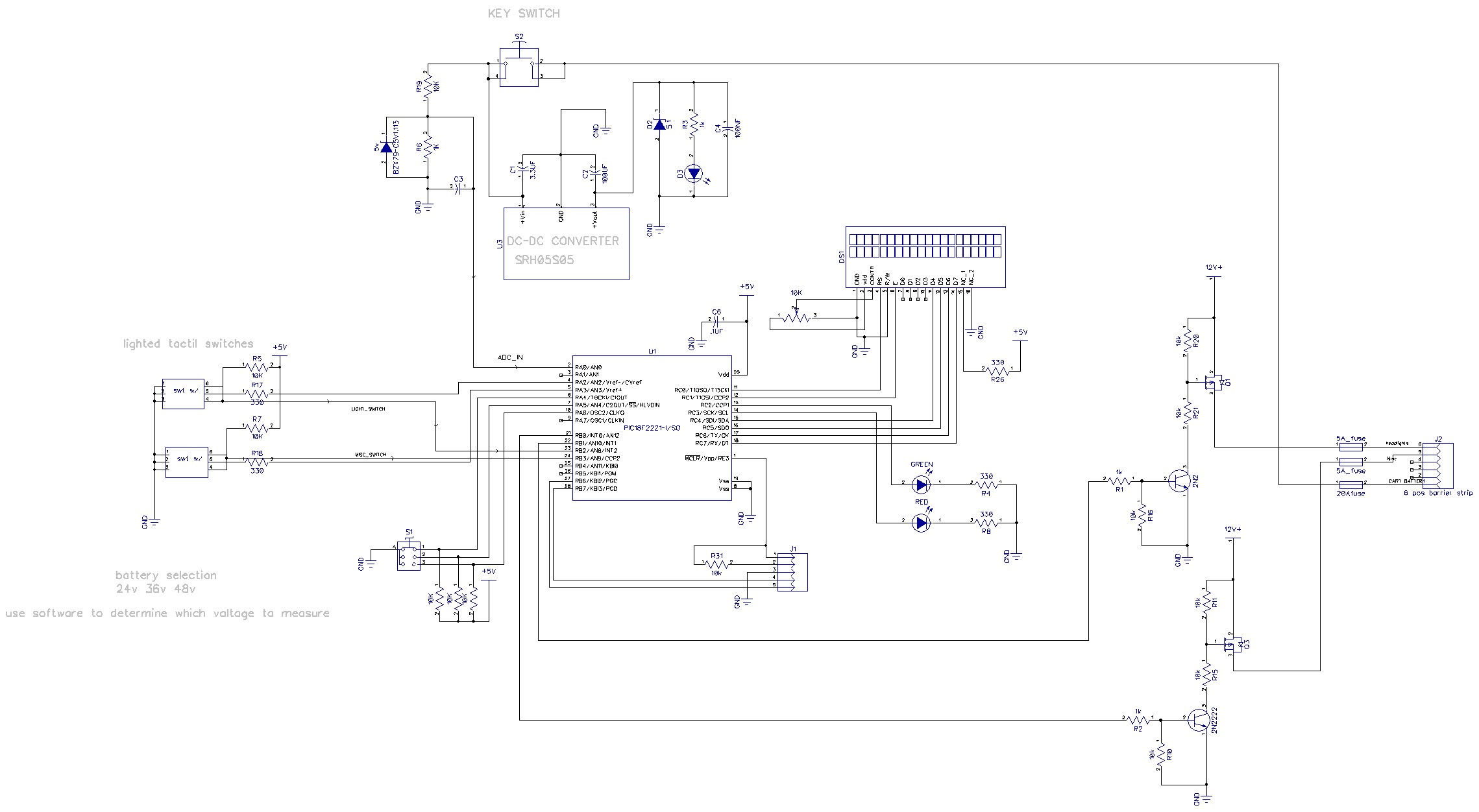

urban cart dash display (golf cart)

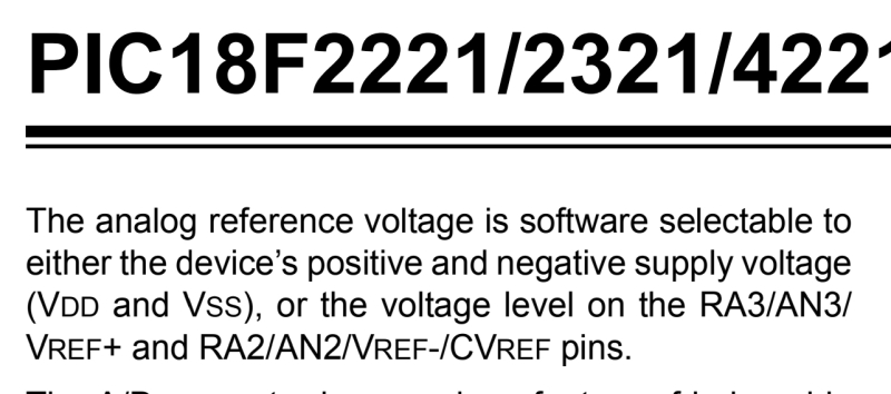

the reason I am using a 18f2221 is I have a quanity on hand. On page 236 (18f2221) in the data sheet it mentions
CVR (control voltage reference) which I interpid as similar to FVR (page 289 data sheet 18f43k22). I have a quanity of these as well.
Are these two FVR and CVR basically the same?
Nada. Nothing to do with each other. From section 20.0 ADC of the 18F2221 data sheet, the options for the ADC reference are Vdd & Vss or external.
As I stated earlier, using Vdd for the ADC reference should be ok; the DC-DC converter has pretty tight specs.

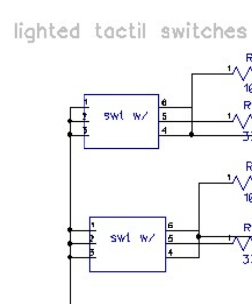

Well here is cleaned up edited schematic. curious if P channel over N channel? perferred
Added 2 leds so driver has a better indication if battery is gettting low.
Plan to have 2_48v lipo4 batteries in parelle but only one is in use (have a battery selector switch mounted on cart)
hope this schematic passes mustard?

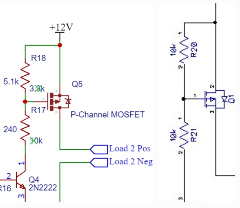

....switched back to P channel. No part number?
In as much as
A. I don't know the current draw of your lights and "misc"
and
B. I don't see any coins in my pocket to do your design work
Perhaps you should be happy (and maybe the slightest bit appreciative) for a clear schematic and all the help numerous people have tried to give you. You can put out some effort, figure out the load currents and make as MOSFET selection.
Or use relays - the current draw of a relay will be next to nothing compared to the load.
Or use N-channel FETs. Much simpler, but then you'd have to understand the difference between a low-side switch and a high-side switch.
Or, easier still, use two toggle switches to control your lights and "misc" and a less than $10 DC voltmeter module to monitor battery voltage.

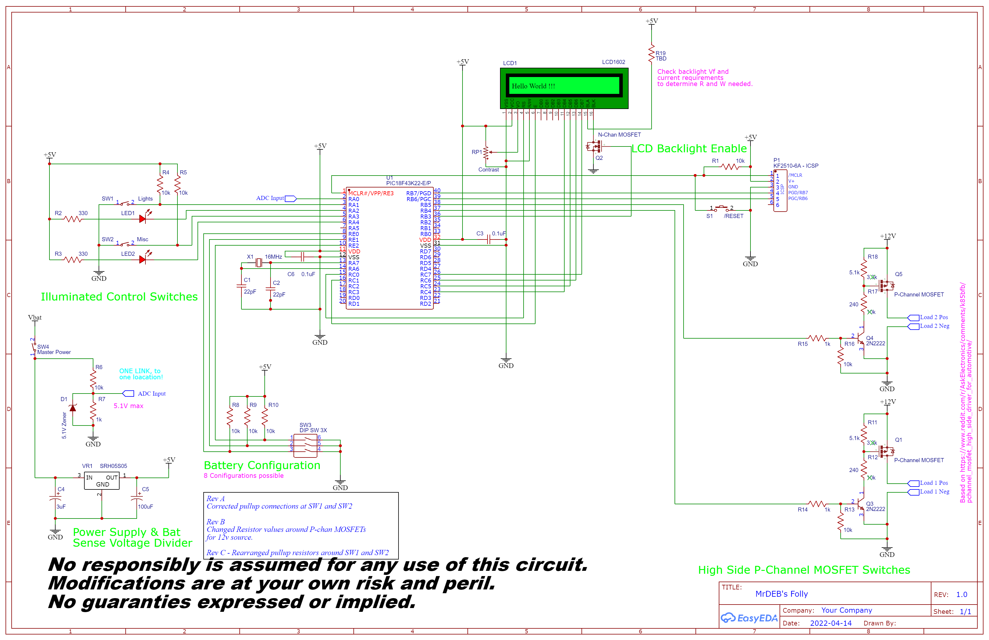

It does not. You still have numerous errors that you have been told about numerous times by several people.
What an insult to people who have expended a tremendous amount of error to help you.
Already addressed errors
Remove D2 zener: post #71
No LCD power connection: post #42 and elsewhere. Note, a power connection appeared in one schematic and disappeared in the next.
MOSFETs incorrectly wired: posts #22, #32, #34, #46, #47. MOSFETs have alternated between P-channel and N-channel without explanation. The P-channel versions have reversed DRAIN and SOuRCE connections.
"New" problems:
100uF cap C4 is duplicated as C7. The DC-DC converter doesn't want to drive more than 100uF.
The resistors around the gates of the MOSFETs are probably wrong.
MrDEB, your schematic is much better and easier to understand. But you didn't fix the already-addressed problems. If you continue making one correction at a time (and "un-fixing" something else), you'll never get done and nobody will continue trying to help.

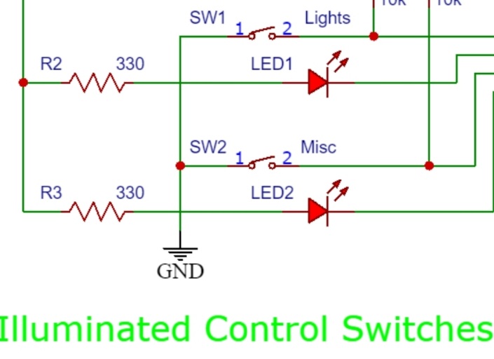

Oops. I really messed up the pullup resistors around SW1 and SW2. Here is the corrected schematic for those still following along.
C4 is 100nf not 100nf
yes I forgot to create a trace from +5v-corrected thanks
The mosfets are connected as per your schematic.
the switches SW1 and SW2 are tactil switches, not as you have drawen
Thanks "Jon" for pointing out my mistakes
Oh and I forgot to include a connection for the hall effect switch.
Better get out your magnifying glass and check again.
Tumbleweed explained this pretty clearly.
If you look at the direction of the mosfet body diode in
what you have drawn, the diode will always be forward biased so you won't be able to turn off the lights (at least not until the body diode blows up).
The point of a schematic is to show how components are connected. Your 6 pin "black box" switches don't show which pins are the switch contacts, and which are the LED contacts. Maybe you do have the connections correctly made.
In as much as I don't know what switches you're using (if you even know), I have shown the "Illuminated Control Switches" as their essential elements of switch contacts and LEDs. I have shown clearly the connections that must be made, no matter what particular switches you end up using.
That way, it doesn't matter what switches you finally plop down in whatever version of the schematic you end up with. But my preference for schematic symbols is for symbols that show the function of each pin. This can be symbols in the schematic component itself, labels on the pins, or, in the worst case, labels placed next the the symbol. At any rate, there should be more than pin numbers or you can't tell squat from the schematic. "There's a resistor going to pin x – is that the LED? The switch?" You shouldn't have to dig out a datasheet to know.
I agree with you about the illuminated tactil switches.
I made the part using Diptrace several years ago and it works as is.
I don't want to upset my schematic etc by changing the pattern or other.
I have LOTS of red and white illuminated switches but never had a data sheet so I made part etc that works.
