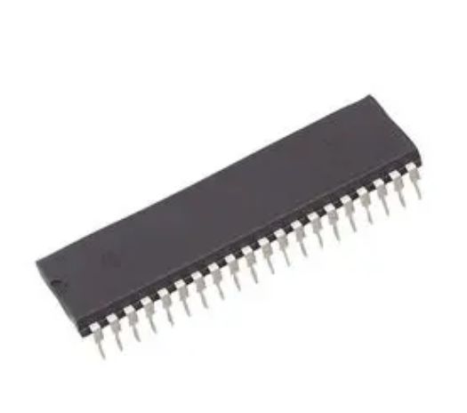

I’ve been comparing the clock (CLK) waveforms of the SPI bus between the PIC18F46K20 and the PIC18F46K22 microcontrollers, and I’ve observed that the 46K22 maintains a much cleaner and more stable waveform than the 46K20. This could be due to internal differences in chip design, switching characteristics, or improvements in output drivers.
On another note, regarding the type of package used, in theory, the DIP (Dual In-line Package) tends to have poorer electrical performance compared to SMD (Surface Mount Device) packages. This is mainly because DIP packages feature longer pins and trace lengths, which can increase parasitic inductance and capacitance, making the circuit more prone to external electromagnetic noise. These factors can significantly impact signal integrity, especially in high-speed or high-frequency applications such as SPI communication.
