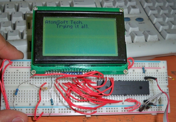

Unicorn GLCD demo.

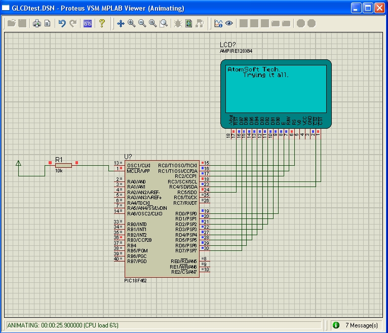

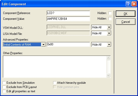

ClearScreen when called actually turns the screen complete black. Is it possible that my screen is running in inverted mode already. When (in proteus) the screen is powered on, it gives black background.
AtomSoft: Its the same thing, gives the same result :) I tried what you said earlier before asking question here on forum ;)
Is this your GLCD clear screen?
void ClearScreen(void){
unsigned char i,j;
	b_GLCD_GCS1=1;
	b_GLCD_GCS2=1;
	for(i=0;i<8;i++){
		GLCD_Write_Cmd(0x40);	//y=0
		GLCD_Write_Cmd(0xb8+i);	//x=0
		for(j=0;j<0x40;j++)
			GLCD_Write_Data(0x00);
	SetPos(0,0);
If you are then try this:
glcd-jpg.35505
also revert all the data back to normal, meaning If you changed the read data and others put them back to normal.... the only thing that should be changed is:
void GLCD_Write_Data (unsigned char data){
	Wait_Not_Busy();
	[B]GLCD_Data =~data;[/B]
	b_GLCD_RS=1;
	b_GLCD_RW=0;
	b_GLCD_E=1;
	Delay();
	b_GLCD_E=0;
clipboard03-jpg.35506
