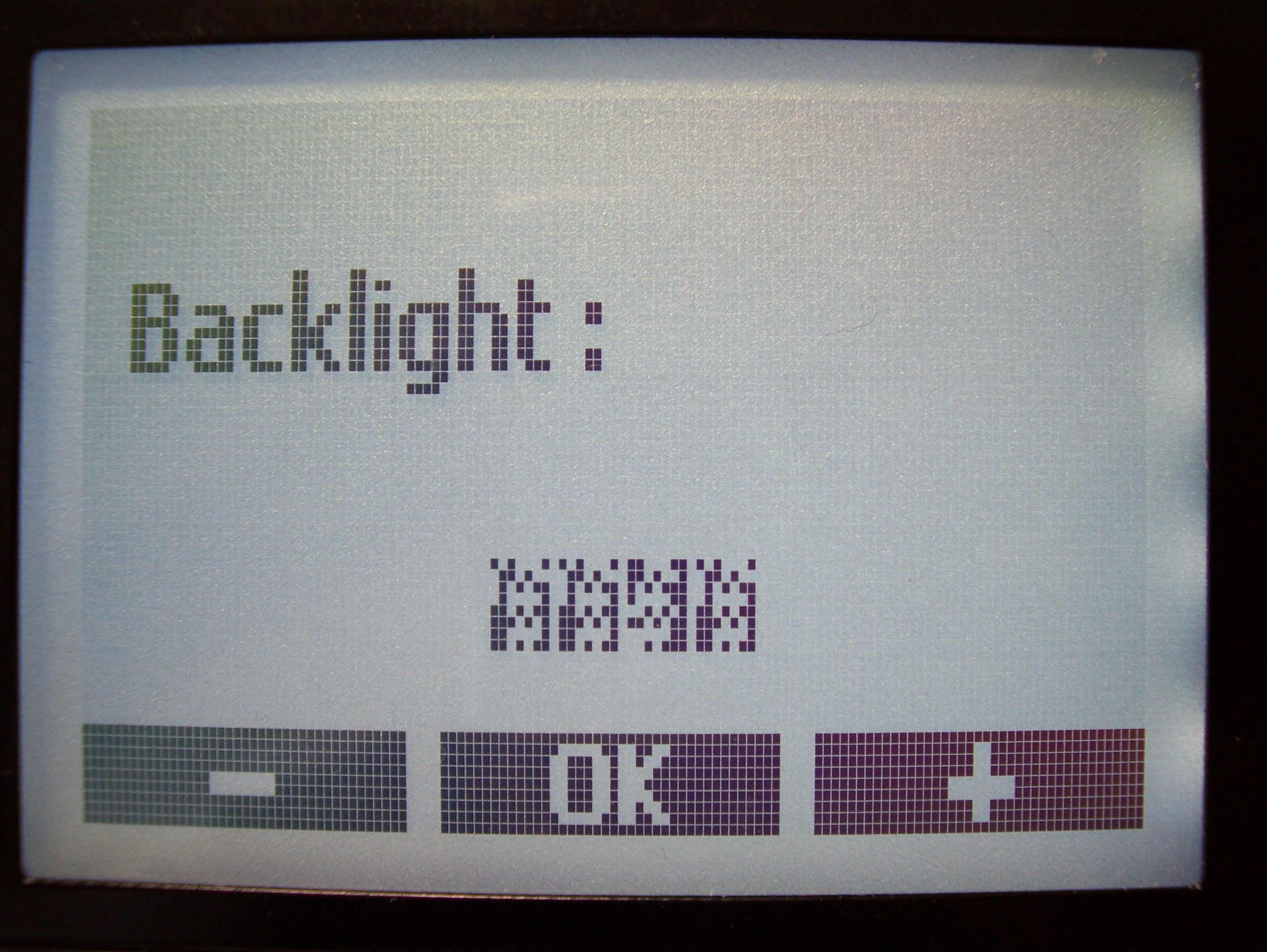

Hello,
I want to display a "int". I have used the function of SuperBrew (displayNUM)
void displayNum(int x, int y, int theValue) {
    char toPrint[4];
    toPrint[0] = (theValue/1000)+48;
    toPrint[1] = ((theValue%1000)/100)+48;
    toPrint[2] = ((theValue%100)/10)+48;
    toPrint[3] = (theValue%10)+48;
    SetPos(x,y);
    PutChar(toPrint[0]);
    PutChar(toPrint[1]);
    PutChar(toPrint[2]);
    PutChar(toPrint[3]);
I use it like this:
int BacklightType;
BacklightType++;
displayNum(50,40, BacklightType);
but I get this when I try to display "10" (see photo)
I guess I have "0010" but my character does nothing ...
I also post my glcd.c so you can see my function "putchar". But I find the strange outcome ...
Have you any idea?
Thank you in advance

Hello,

I encounter a problem:
I can not write where I want on the axis "y", I still lag 8.i only write on the lines 0, 8, 16, ... even if I do:
SetPos(50,7);
PutChar('R');
he writes to the line 0.
Is it possible to solve this problem?

Something like,
    i=0;
    while(DataToLcd[i]!=0)
        PutChar(DataToLcd[i++]);
Pommie thank you ... it works very well ...
Will you have an idea on my previous post on the writing area on the screen. By the coordinate "y" must always be a multiple of 8? can we change this?
Thank you again
It is possible to write characters to any position on the screen. The way to do it is to load each vertical byte of the character into a 16 bit variable and scroll it the required number if pixel (0-6). You then inclusive or this with the screen to draw the character.
