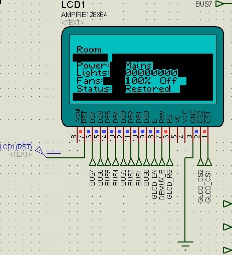

Is there a way to invert the colors of display (black font with blue or green background) ?
Yes, you need to add the bits in red,
void GLCD_Write_Data (unsigned char data){
	Wait_Not_Busy();
	GLCD_Data = data[COLOR="red"]^0xff[/COLOR];
	b_GLCD_RS=1;
	b_GLCD_RW=0;
	b_GLCD_E=1;
	Delay();
	b_GLCD_E=0;
unsigned char GLCD_Read_Data(void){
	Wait_Not_Busy();
	TRIS_Data=0xff;
	b_GLCD_RS=1;
	b_GLCD_RW=1;
	b_GLCD_E=1;
	Delay();
	W=GLCD_Data[COLOR="Red"]^0xff[/COLOR];
	b_GLCD_E=0;
	TRIS_Data=0x00;
	return W;
Thank you Pommie for the quick reply, it has inverted the Data but now there is a new problem.
The backgound is still black and the text is inverter (Black font with blue background) what i wanted. However i actually wanted to make the complete background blue and only font black..
The attached image will help you understand what i meant.
The text is displaying okay but the background is annoying now :(
I have solved this issue but the method is really stupid so i was looking for a more professional solution for it :p
